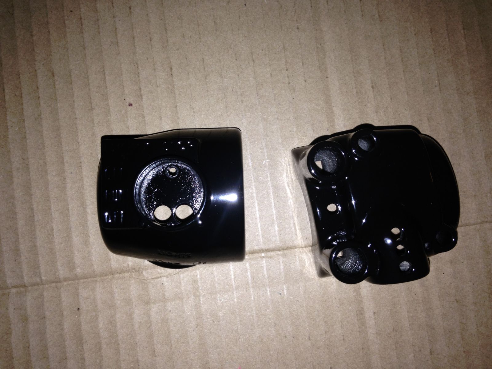

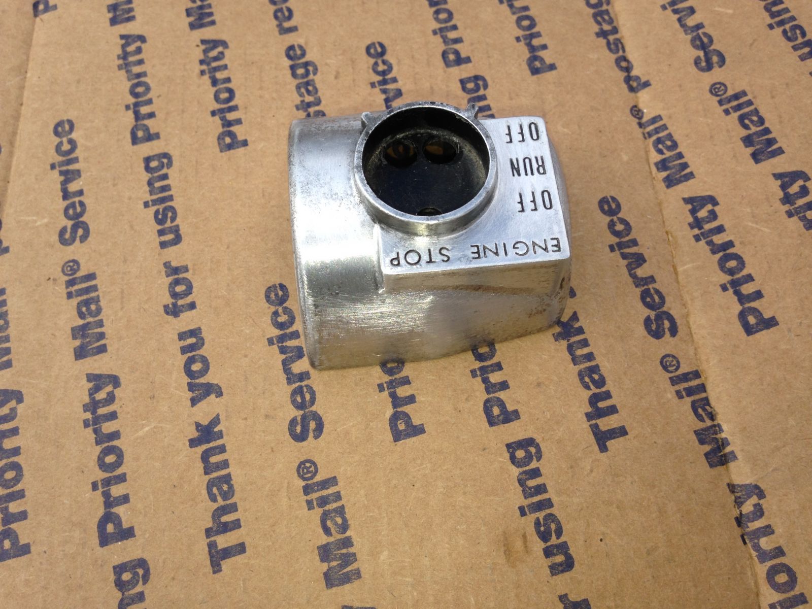

Re: '76 KZ900 (ZRX1200R) Build
06 Mar 2014 08:17
I would make both sides match black or polished.
06 Mar 2014 09:42Hollywoodmx wrote: I would make both sides match black or polished.
Huh? Whatever direction (leaning polished.....) both housings will be done the same.

naketfun........i just clean mine to repaint and was thinking the same polish them...but did repaint them after all.
