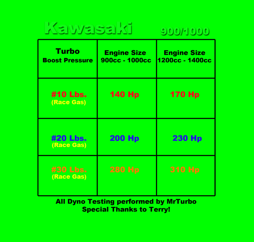

I have a general dyno chart to post.

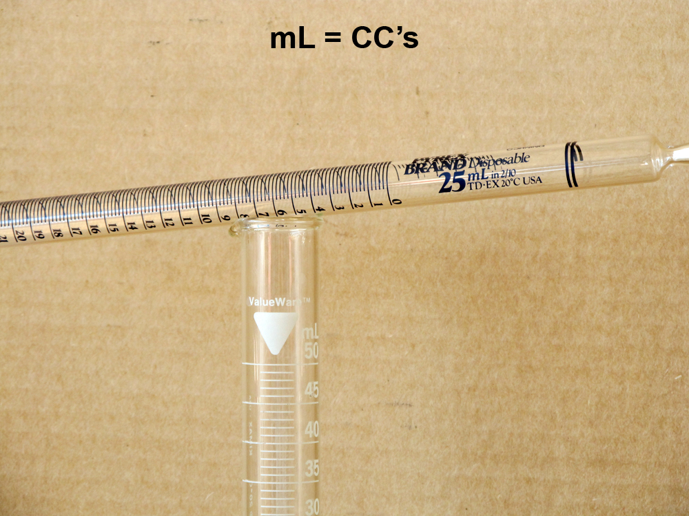

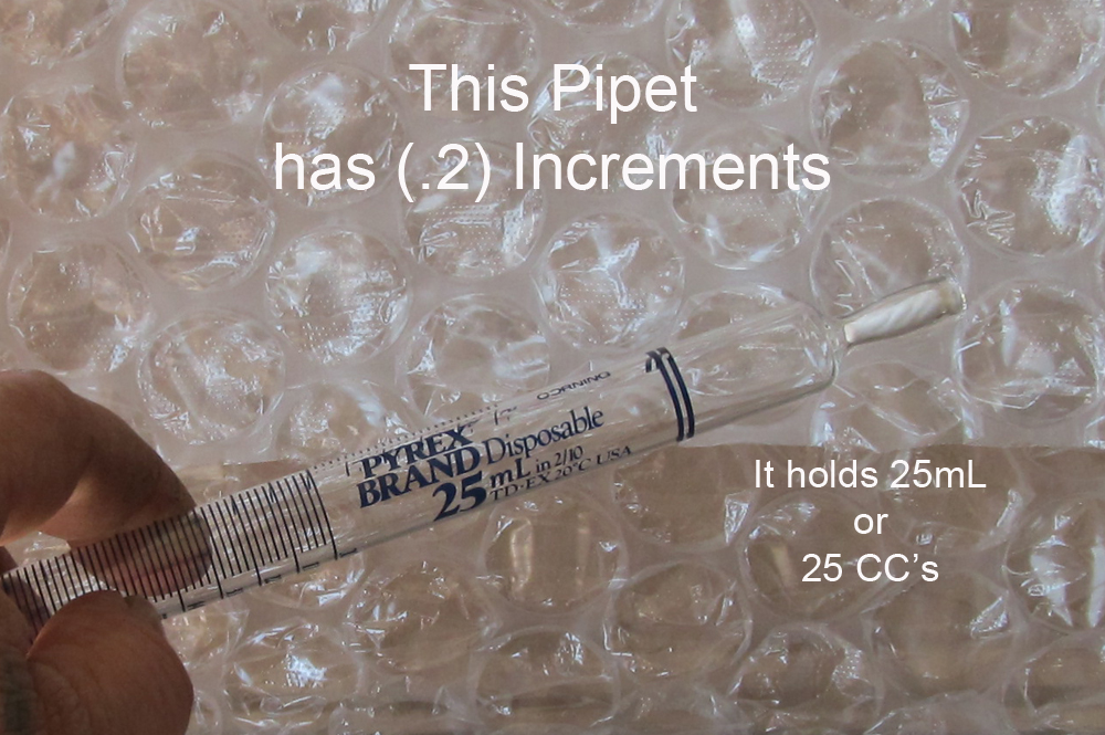

I see the pictures don't open up, very large on the new site.
I choose the Pipet over the Buret tube. The Buret tube looks really cool, and is fun to play with. They cost about $140...You use it once, then spend the next 50 years protecting it, so it doesn't get broke. Pipettes come in glass or plastic, the price range varies. A pipet can cost from $3.00 - $ 3,000.00. The smaller the increments, the higher the price. I am using a 2/10's increment Pipet. It never hurts to have an extra, oops! I dropped it!
Lab people fight over witch is more accurate, The Buret or the Pipet. Both take Practice! I think .2 is good for this build.

I will use the Pipet to measure the new Compression Ratio and to check the (intake/exhaust) port volume.

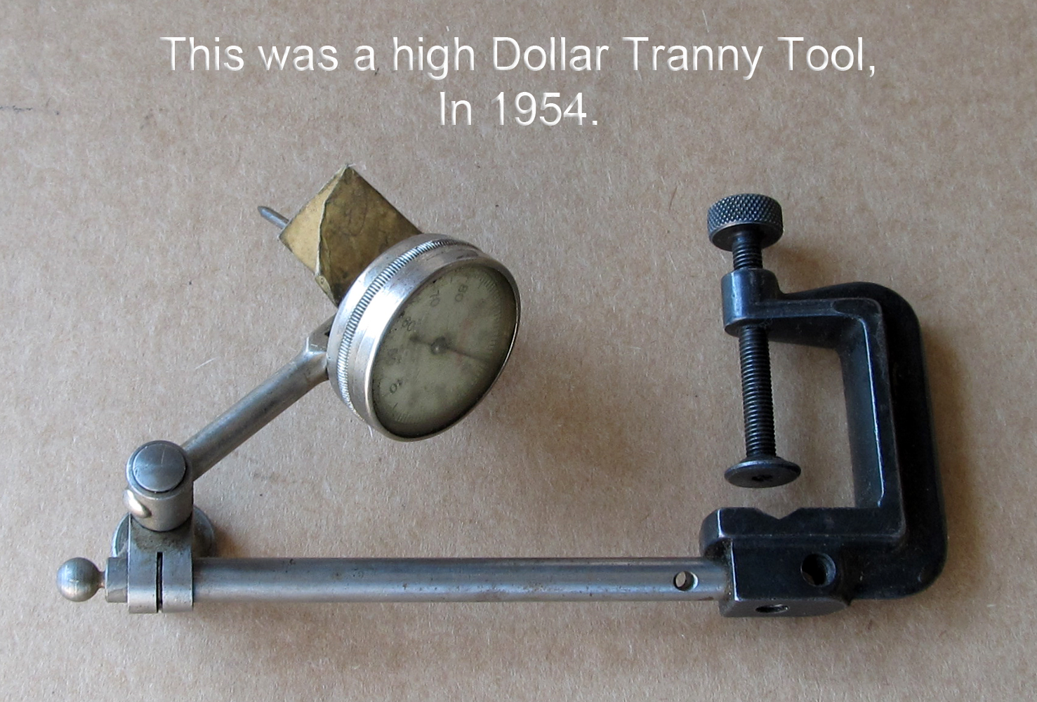

I use this Dial indicator, in small places. I like playing with it, more then anything. It's a good tool to have, never know?
