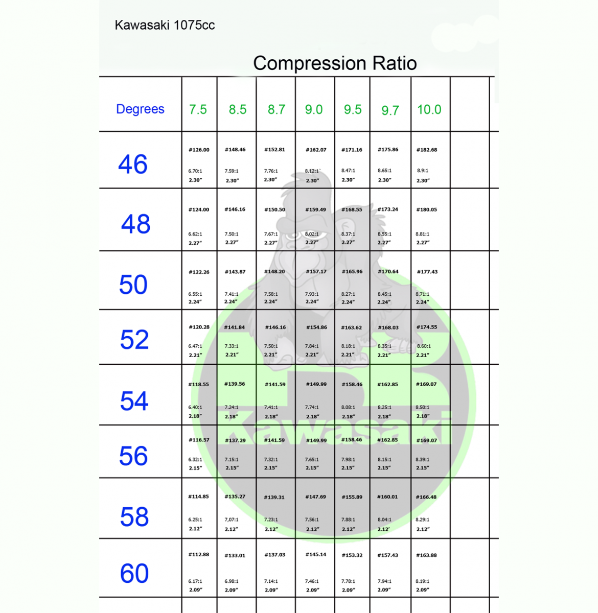

I'm not sure why (well, maybe it's my stupidity at play again) but that chart tells me nothing. What's it listing?
Re: Kzz1p - 1075 Project
08 Feb 2012 17:45DoubleDub wrote: I'm not sure why (well, maybe it's my stupidity at play again) but that chart tells me nothing. What's it listing?
I printed that chart and layed it on the floor, but it was still over my head. :blink:

Unfortunately we cant see enough detail in your chart to make it out.
it is often said that building a motor is all about the combo of part u have .
the parts must compliment each other for the task at hand.
when u were getting all of this loving advice about the build from your friends, did u talk about how these components will compliment each other ?
u mentioned getting hi #’s on the dyno. Looking at your general combo, u seam to have 1 component that will work against your quest for big dyno #’s..
9.1 pistons are not normaly run with big cams. They would not compliment each other. They are usual run with small cams and turbo’s. big cams need the support of higher compression to maintain bottom end torque.
This is not a knock against your plan, just an observation.
Let the pic’s roll.
Let the pic’s roll.

09 Feb 2012 08:29mark1122 wrote: Unfortunately we cant see enough detail in your chart to make it out.
9.1 pistons are not normally run with big cams. They would not compliment each other. They are usual run with small cams and turbo’s. big cams need the support of higher compression to maintain bottom end torque.
Let the pic’s roll.
Mark
I wrote you a response, I guess it didn't post.
Were you voted, guy to take the first arrows? Don't you know by now, I bring at least two guns, to a gun fight.
You saw 9:1 and draw a picture in your mind. You thought, how could a motor with low CR produce power?
One of the tricks of this motor is, it uses a 9:1 piston, running at a static CR of 11.5:1
The real question is, what kinda cylinder pressure does it have? How much pressure can you run on pump gas (91 octane California unleaded) I think this is where my friends start to enter the picture. Does the motor have any kick, to back up those BIG cams?
Those turbo pistons with the extra thick (.200"+) domes with valve pockets? Turbo race bikes use high compression + a lot of boost.(that's a secret, don't tell anyone) Turbo pistons come with a lower then advertised, CR.
Advise from friends? It was loving and very kind. Perhaps Me and Nads, hang out with the same people. Here I have a funny one for you! Maybe I'm a nice guy with some intelligence and a good mechanic. Maybe builders around the world enjoy talking to me. Maybe, every once in a while, others learn from me......No that's just a joke, I think? I took that part of your question as a little, rude. This is a build thread, not a pick someone apart thread. When I seek help, I start at the top and work down. I would of asked,........who are you friends with?
Let's move on to the Big Cams.....Let me change that....BIG CAMS!
We are not going to talk a lot about my cams or cylinder pressure. I will not talk about the valve timing events. I will say they are dual pattern with 112 centers. They are a prototype grind, number #I-69 by ©VKP.
And I do have, a coil mod or two.
I have planned to share, 80 percent of my build in this thread.
NOTE- Please bare in mind, this is a bracket race motor. Other people would be stupid, stupid to fallow my example. This motor is for R&D only.
I will tell you about the history of that Chart. I made it for my 1075 motor. Here's what I did. I took every motor that I could remember....I took every build that is posted here on this site...I did a lot of reverse eng. on every motor. I use online stuff as well as, simple math. I paid close attention to the cams! Then I looked at all the cams on the market, past and present.
Now I was starting to see some patterns. The charts have the compression ratio across the top.
Down the left side it has when your intake valve closes.(That chart is one small page, of my charts)
With online help I did each calculation for every CR and most intake valve closings.
then I had piles of notes and data. I typed it, but it made no sense. Once I made the charts and all that work. I found my answer in seconds on the chart. On this project I have spent days and weeks waiting for numbers. Math is only a tool too put you in the ball park (That's good, just get me near the park, I can walk from there)
I made that little chart late one night. I don't need them anymore...If,If I have time later, I may redo them for others. I would photograph my chart, it has the better end of the scale....But then you would see all my stuff, written in sharpee on it. Maybe I can re-size it?
My opinion from my charts....90 percent of the cams on the market today for Z's, risk melt down at prolonged high speed use. What does that mean? Anything over 1/4 mile and you may be coasting home.
Hey Mark, when I had my data complete....I found "friends" with data. On a serious note! Some people would get pissed, if their names were on these boards. Some really really hate forums. And I made a new friend or two because, because of their hate. It worked out great for me, people on the sites got cheated.
Mark, now what kinda feelings, you getting about this build now?
I set big dyno numbers, so I would work extra hard. I try to find all the dyno charts that I can. The numbers are all over the place...When I look at the builds, I understand why their numbers are low. Everyone picks their own build, and everyone picks the dyno numbers that they believe.
I have believed the dyno numbers, of one our members here. He is a weekend racer, that spends all his money on bikes. People treat him like he knows nothing at times, or never posted at all. And really his numbers are only a little shy, of the old Yosh bikes. That guy is, Timmy the Timebomb.
Mark do you see where this motor, is headed yet? God I love this stuff. Wait until I come out of my shell, and get back in the swing of things. Can you tell, I was doing my home work, while everyone was playing around in chit chat. We haven't made it to the electronics, shift unit, (2)rev limiters, the lightened electrical system, crankcase ventilation, custom built windage tray. This is only day two....We have a lot of time.
My lucky number is 4070. That is an important number in this build. I will explain later so we can all laugh. All of my projects come with a long story. When I am done, I tell the story and everyone laughs so hard. It's funny and all that, butt I don't laugh, I think of all the hard work, it took.
