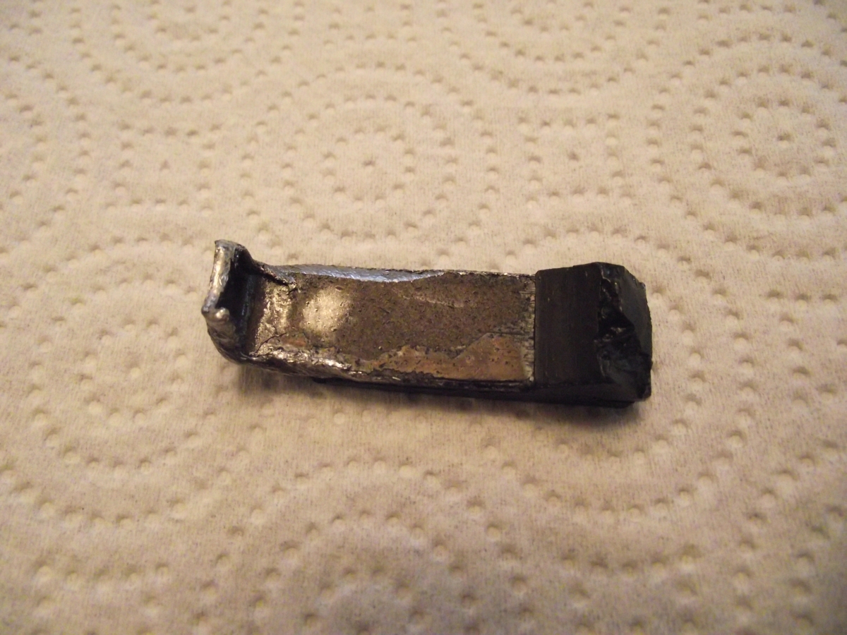

Been awhile since I last posted on this thread. Since then, I had a problem with my front cam chain guide breaking. Came out of the oil drain hole when changing the oil after a 150 mi ride.

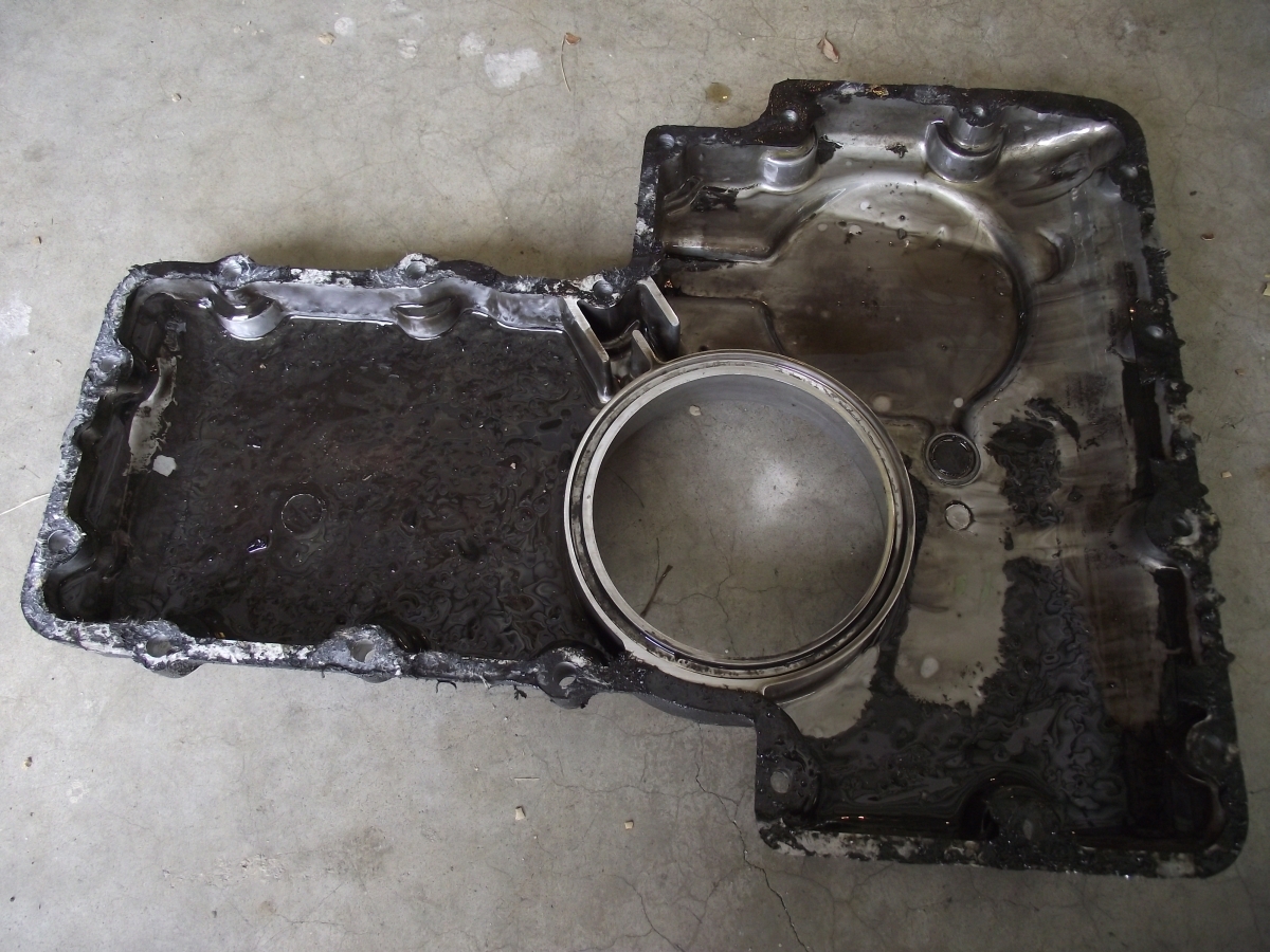

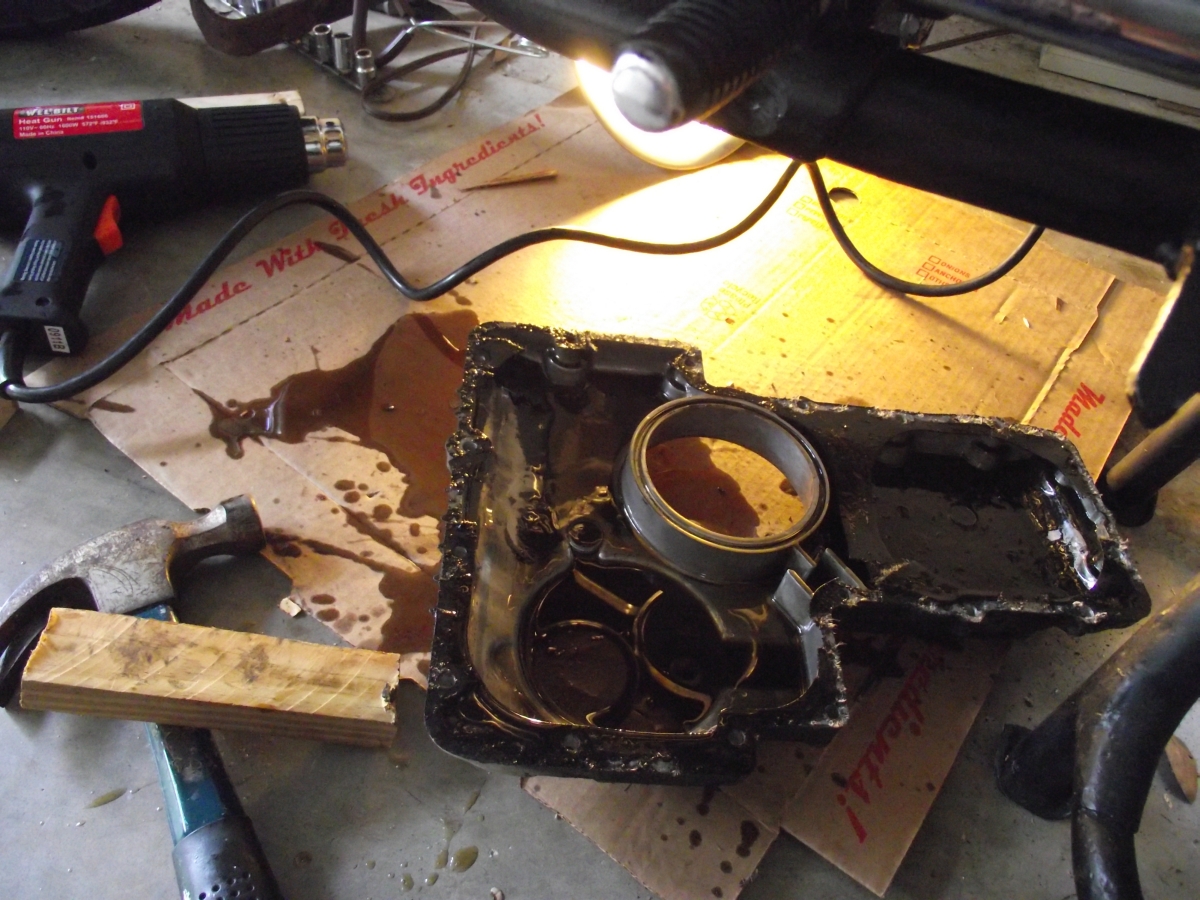

So I finally had some time to dropped the oil pan. Thing was cooked on pretty good. Tried the rubber mallet thing, but it just bounced off like a superball. Tried two foot wooden 2x2 and then a shorter 2x1 and all they did was splinter the ends. Kept thinking I don't want to use the torch with all that oil and it being such a big part. Thanks to reading one of Mfloks' suggestions of using a hair dryer as I searched this site, I decided to try my heat gun. Put the gun on high and concentrated on the front of the pan. A few more hefty whacks with a 2x1 and hammer and it finally gave way.
Here is what I found. No metallic debris but plastic bits which I attribute to the cam chain guide.
I know this was the wrong end of the engine but I wanted to drop the pan to read what the sludge can tell me about the engine (like reading tea leaves) before I pull off the head and jugs.
