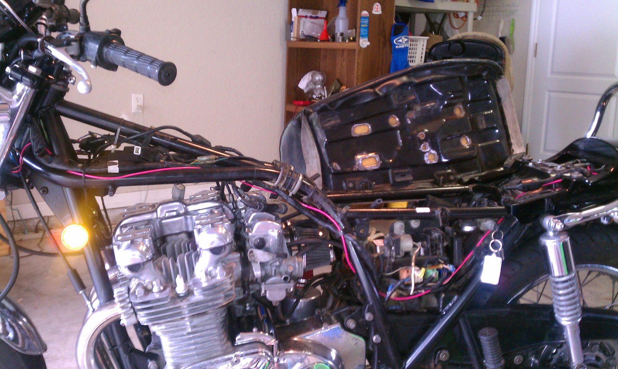

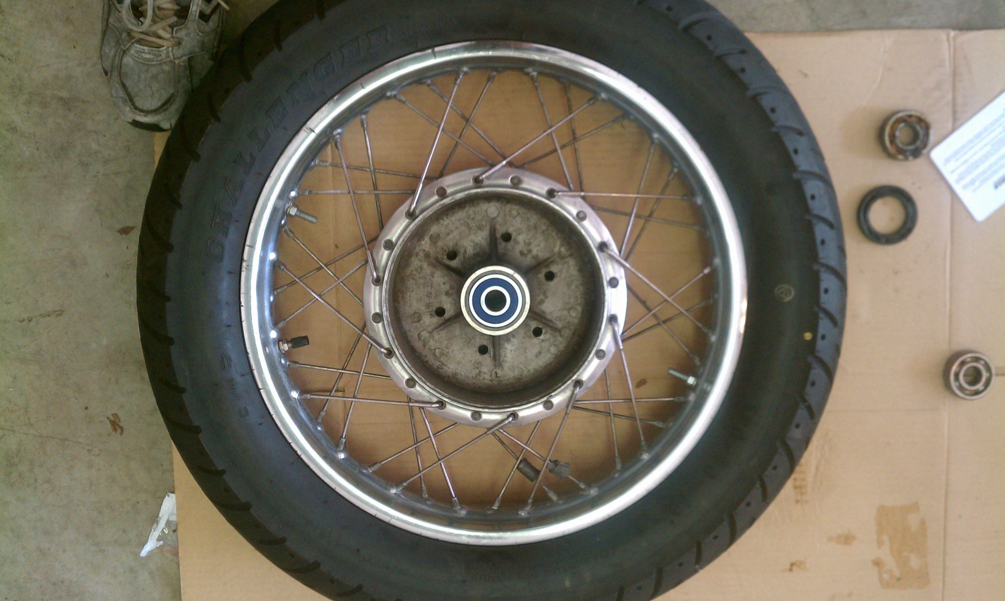

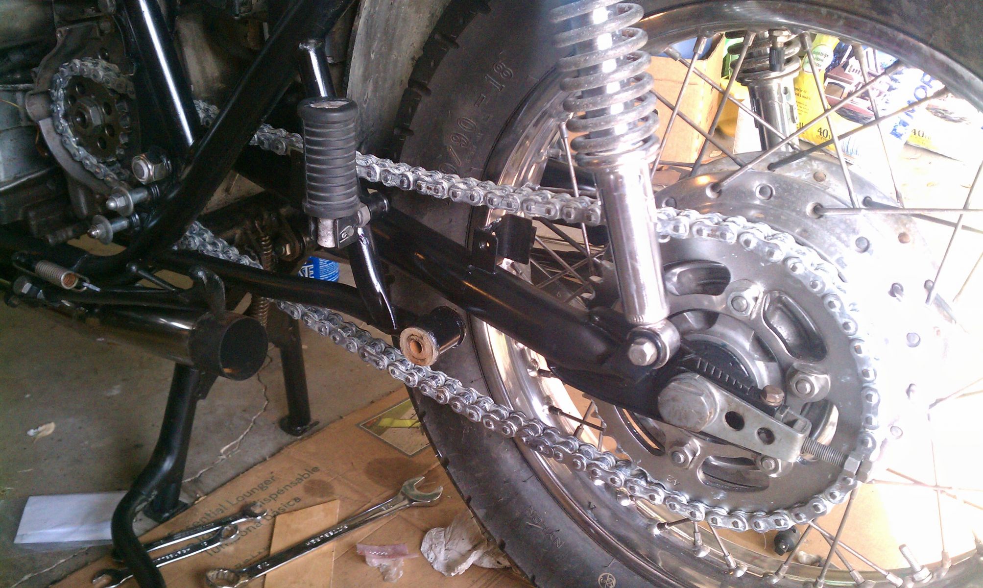

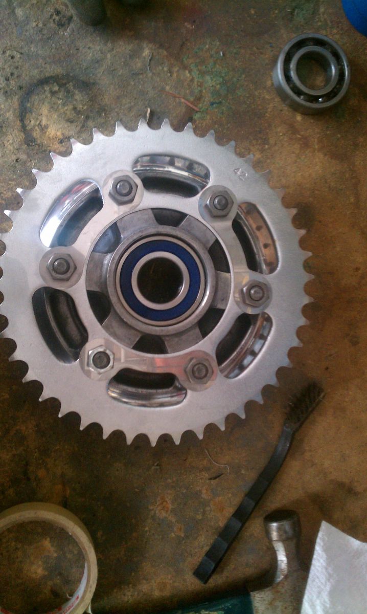

Well, its been awhile since I posted anything on this thread. But as some know, I haven't been idle. Since posting my prior post above I have:
1. Completed my 630 to 530 chain conversion. So new front and rear sprockets as part of the conversion.
2. Replaced rear bearings.
3. Cleaned rear brake assembly and installed new shoes.
4. Installed new polished chain cover and lubed the push rod and worm gear at the same time.
5. Measured and adjusted valve clearance. Had to re-shim two intake valves.
6. Replaced valve cover with a polished aluminum cover.
7. Touched up the frame a bit on the back. Looks much better for now.
8. Fixed front brake/tail light problem. Bypassed the blue wire all the way to the back stop light.
9. Replaced speedometer bulbs. Sucks not knowing how fast you are traveling at night.
10. Started carburetor balancing job. Man, out of balance big time. Kinda like wireman's Quagmire picture.
Will edit in the other part of the balancing procedure once I get her done.
I did all these things last couple of weeks in anticipation of riding this past Saturday with a riding group I joined a couple of months ago. Well, once again, couldn't get it done in time. So this is like the third time something like this happened to me.
