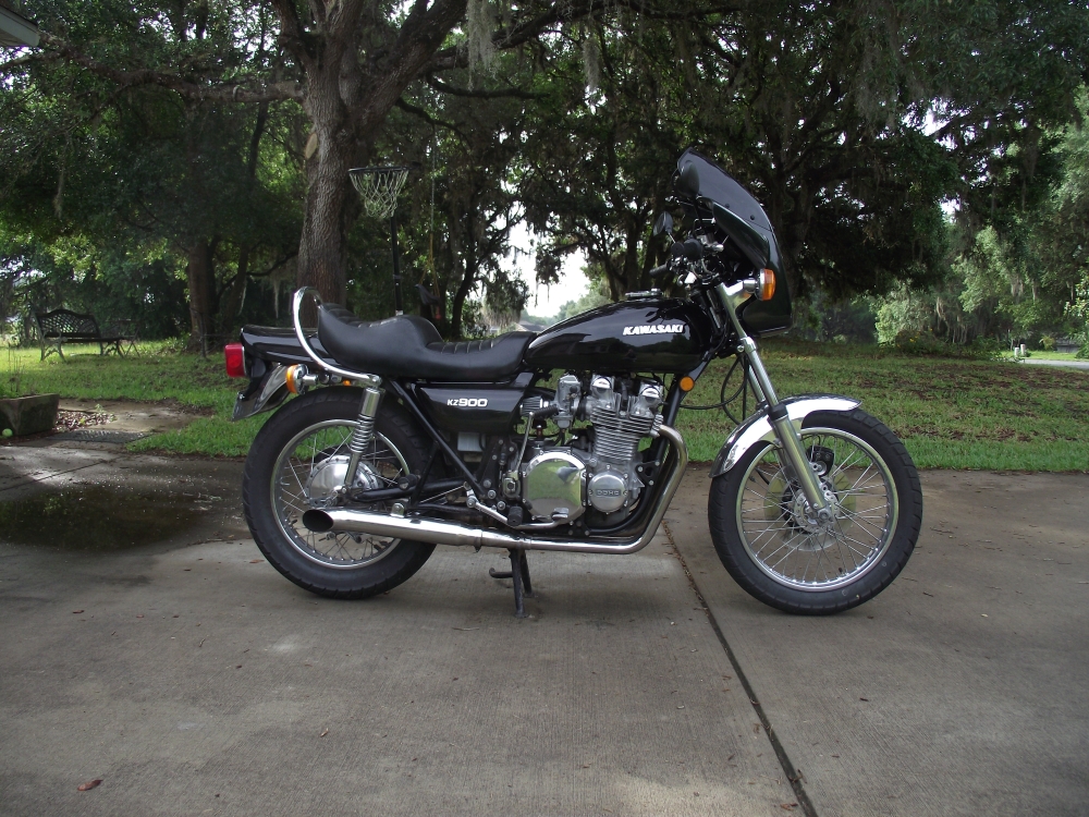

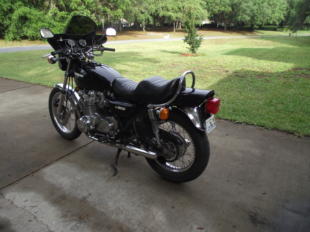

Clocked around a 145 miles today escorting Kawickrice on his journey to Macon, Ga for the relay hand off. It was great! Now here are the part that is not great. A few issues came up during the ride. First, I started noticing a tapping noise coming from the one of the valves. Maybe just needs the clearance checked and adjusted. Second, clutch started getting tough to pull out of first. Like it needs a lot of throttle to get it going. Seems to shudder if you don't have enough throttle. I think part of the problem may be a lose chain (on the shudder). Which brings the next issue that I have complained before. Wobble, especially at 80+. So here is the plan for the coming week.
1. Pinpoint where engine noise is coming from with my stethoscope. Order valve cover gasket no matter what.
2. First replace clutch cable (already have it) and try adjusting the clutch to see if pulling out of first can be smoothed out. Other gears are fine. If that doesn't work, inspect clutch and order new if required.
3. For the wobble. Order new chain, which may be causing some of the wobble (not sure that would be a factor). Re-tighten Head stem. Order new front and rear wheel bearings. After the ride with the engine off, I pushed the bike into the garage and heard the bearings squeal.
Here is couple of pictures of the bike with the new turn signals (thanks to Brian KZ1006) and new NOS fairing.
