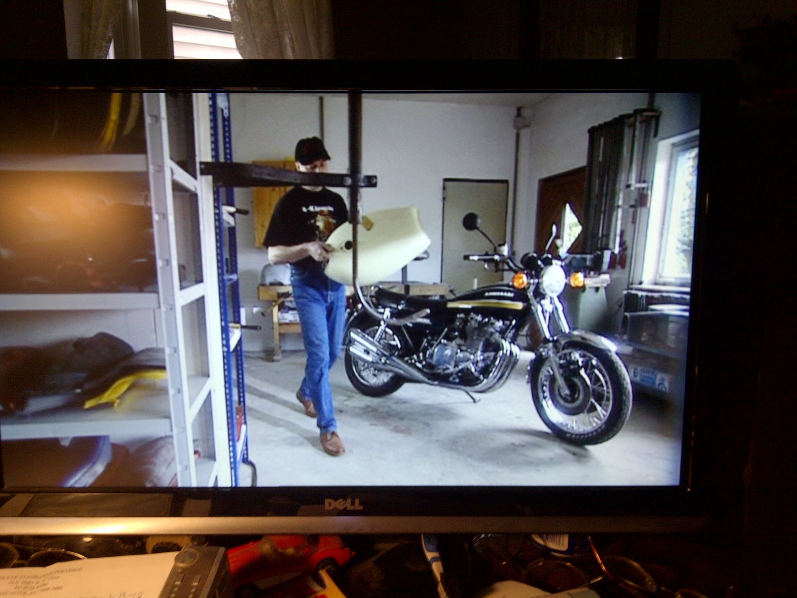

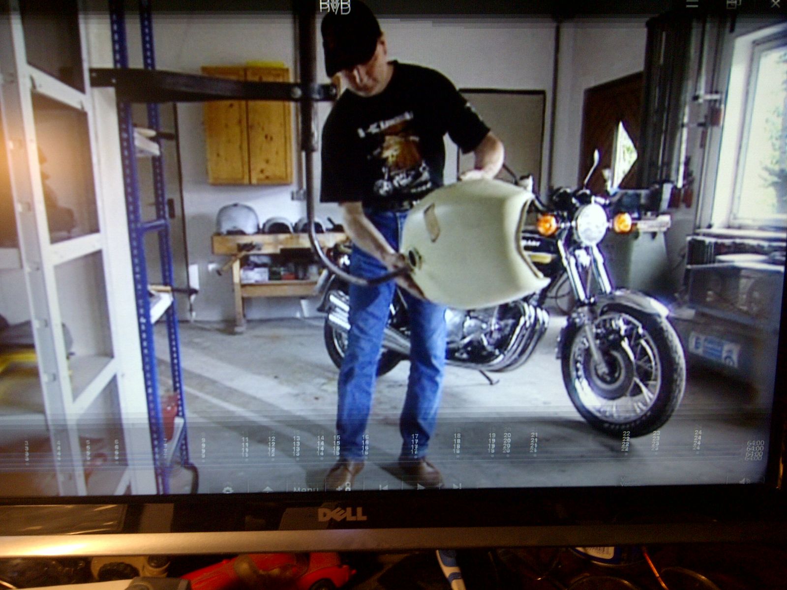

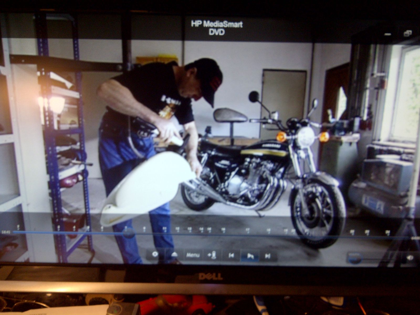

22 Sep 2011 15:19KZJOE900 wrote:531blackbanshee wrote: in z1 the movie they show a german guy (naturally)with a piece of 3/4" - 1" bar stock that is bent into a j shape the he has bolted to a shelf at the right working height.he takes the tank and slips the gas tank hole over the rod and positions it so that it "backs up the dent"then carefully works the dent out with a hammer.
pretty neat idea.
leon,
Do you have a link to the movie? I'm very interested. Maybe I can try to manufacture it using some kind of pipe.

21 Dec 2011 15:01531blackbanshee wrote:KZJOE900 wrote:531blackbanshee wrote: in z1 the movie they show a german guy (naturally)with a piece of 3/4" - 1" bar stock that is bent into a j shape the he has bolted to a shelf at the right working height.he takes the tank and slips the gas tank hole over the rod and positions it so that it "backs up the dent"then carefully works the dent out with a hammer.
pretty neat idea.
leon,
here is a link to buy it in the u.s.
www.americanclassix.com/z1movie.html
definately a must have,
Leon,
I didn't get that movie, but I saw a tool from an UltraDent youtube demonstration. So I made one myself. But didn't work (need to alter the bends). That tank metal is too hard for me or I was doing something wrong. I'll post a picture of the tool once I have time.

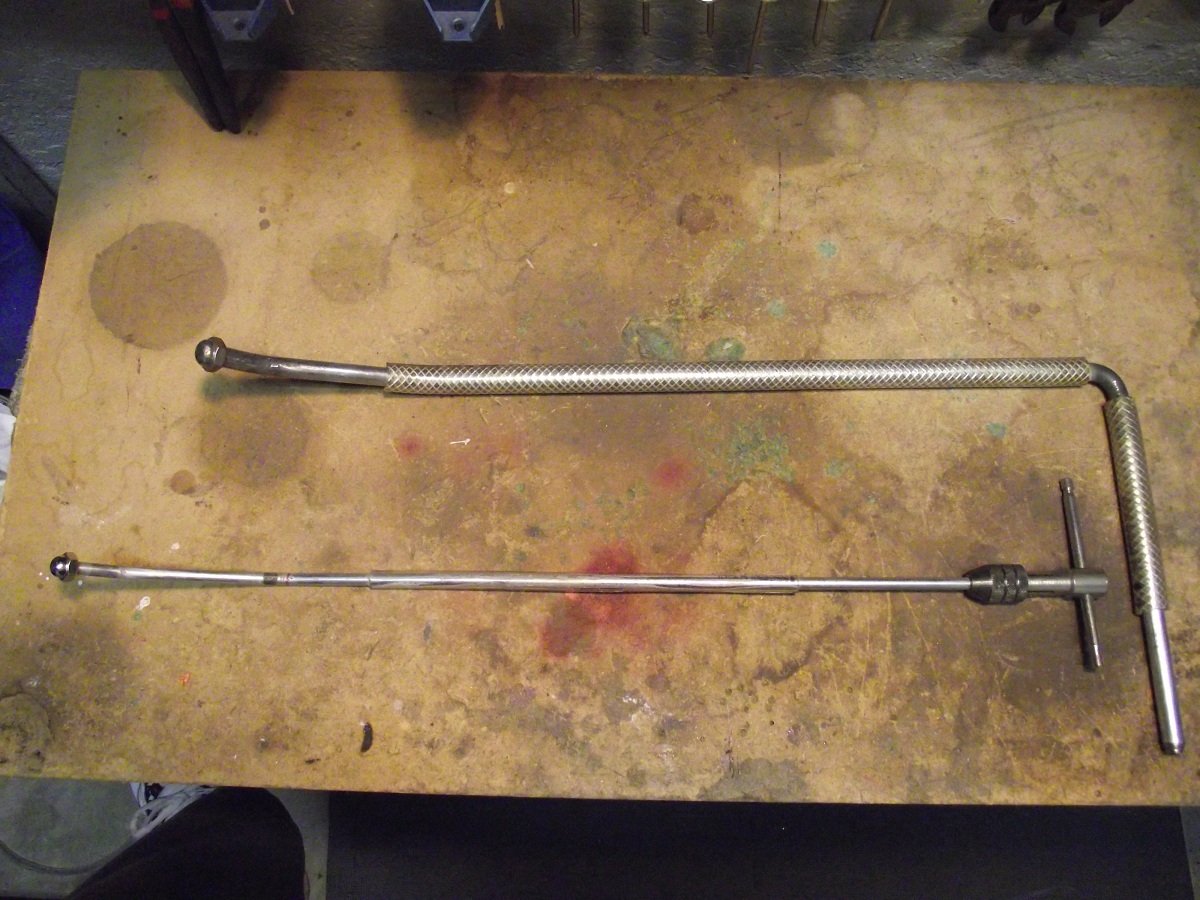

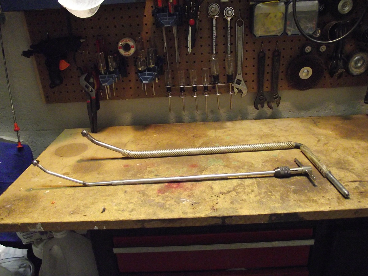

Here is a picture of my tool. No pun intended. :laugh: The smaller one is made out 5/16 stock and was too weak and bent when attempting to use it. The other one is out of 1/2 stock. Didn't give, but my strength did. So it wasn't having an effect. I need to give it more bend and length after the bend so it reaches from the frame hump to the side of the tank. I have an old tank to practice on once I modify the tool once more.

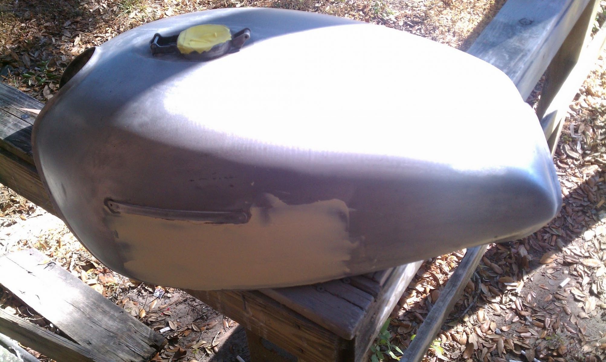

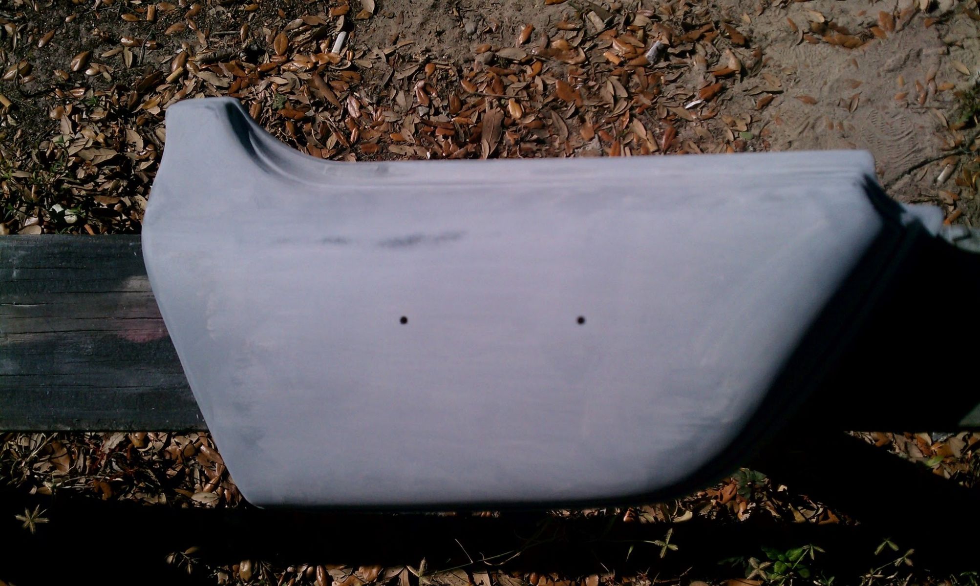

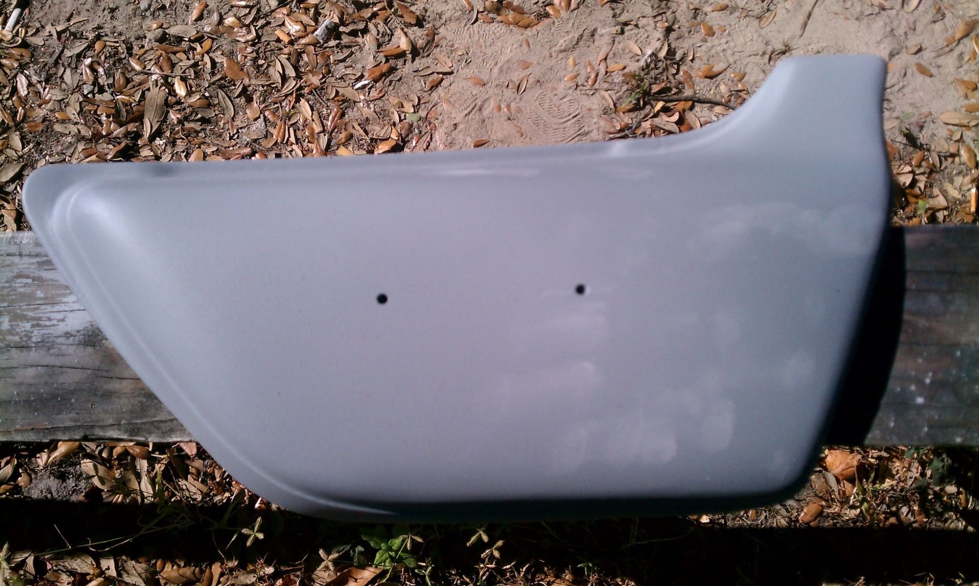

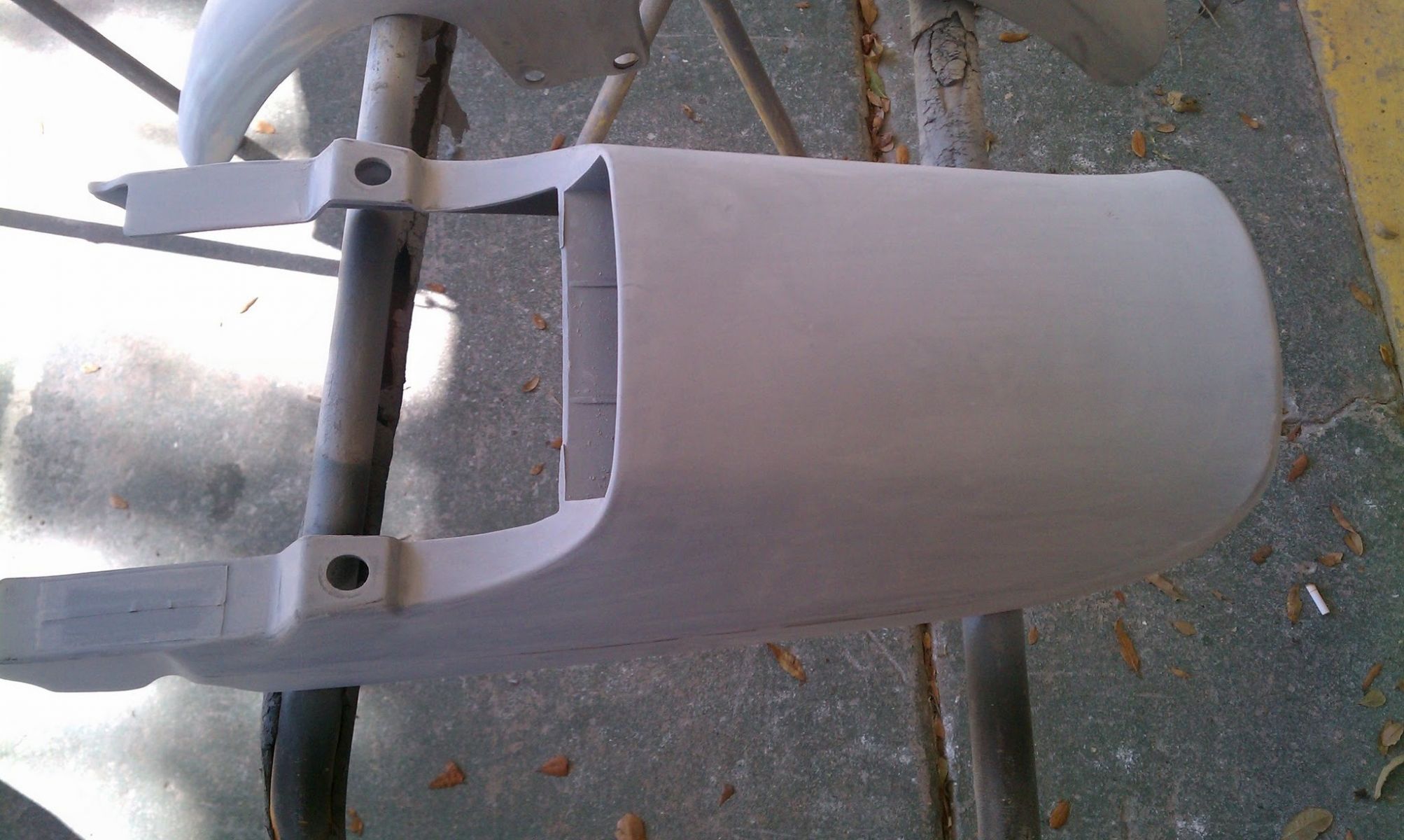

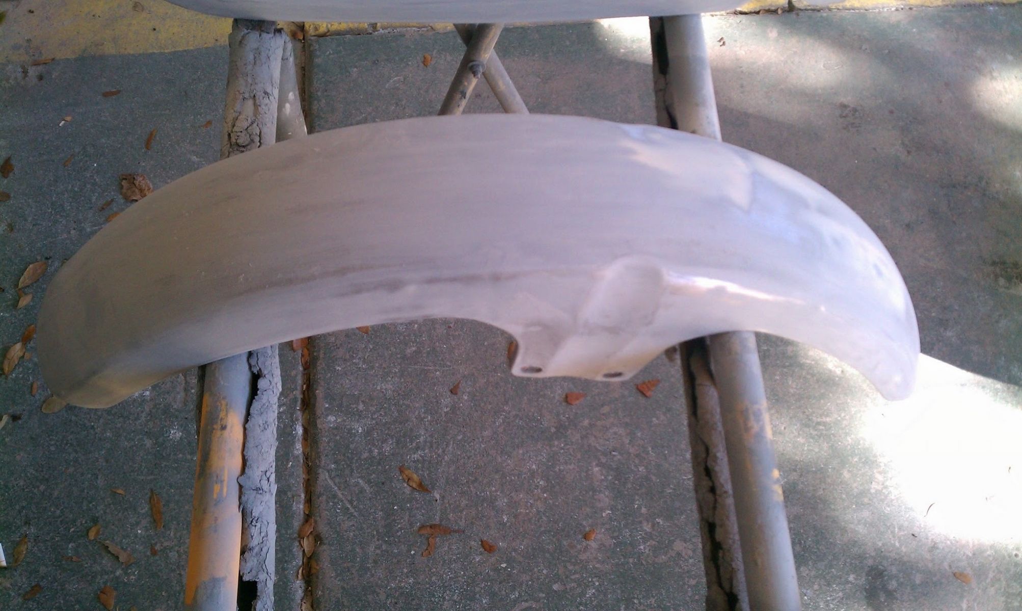

I visited my paint guy today to see how things are proceeding. Took the following phone shots while I was there:
He said it should have base coat as of today. Then just a matter of three coats of clear urethane and they will be complete. I'm thinking I may sell the front fender and use the short LTD chrome fender instead. But I will have to see what looks best first.
I also ordered some parts from Z1Enterprises today as well. Ordered the front fork sseals and fork dust covers. And another kz900 side emblem to complete the body parts. I've been cleaning and polishing the fork tube assemblies (have an extra set and will be selling the originals once I swap them out) in anticipation of the parts. Then will do the fork swap once I have these replacements rebuilt.
Hoping to have it all come together soon time permitting. Then will start with the tuning.

Musical instrument repair folk have been using tools like that to remove dents from trumpets, trombones, saxophones, tubas and the like for many years. I'll bet there is a rod on the market that will work for kz tanks. The tool companies also sell a wide range of threaded balls to fit their rods. (yeah, yeah I can almost hear the jokes coming...).
KZJOE900 wrote: Here is a picture of my tool. No pun intended. :laugh: The smaller one is made out 5/16 stock and was too weak and bent when attempting to use it. The other one is out of 1/2 stock. Didn't give, but my strength did. So it wasn't having an effect. I need to give it more bend and length after the bend so it reaches from the frame hump to the side of the tank. I have an old tank to practice on once I modify the tool once more.
Here is how it should work.

Yeah Leon, when I saw Peter's post I thought of the guy Germany you had mentioned. Man! That thing is pretty heavy duty. Like something out of a horror movie :woohoo: But I can see how one can use their weight as leverage to their advantage.
