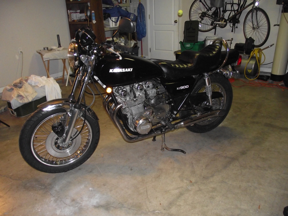

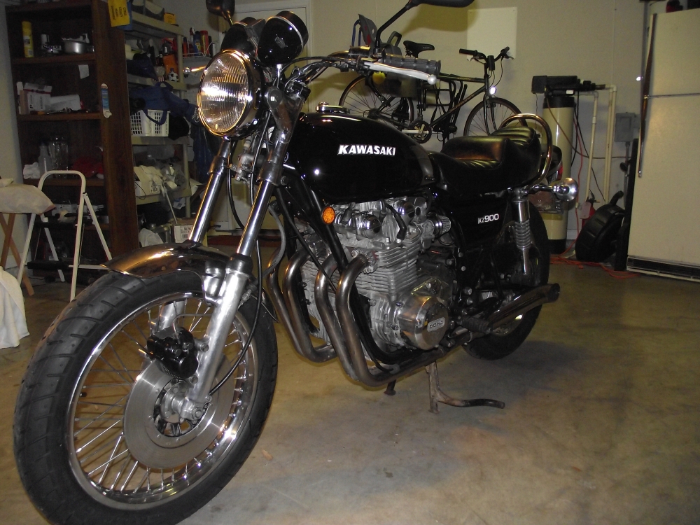

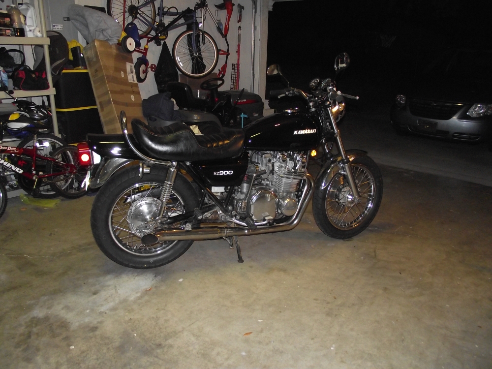

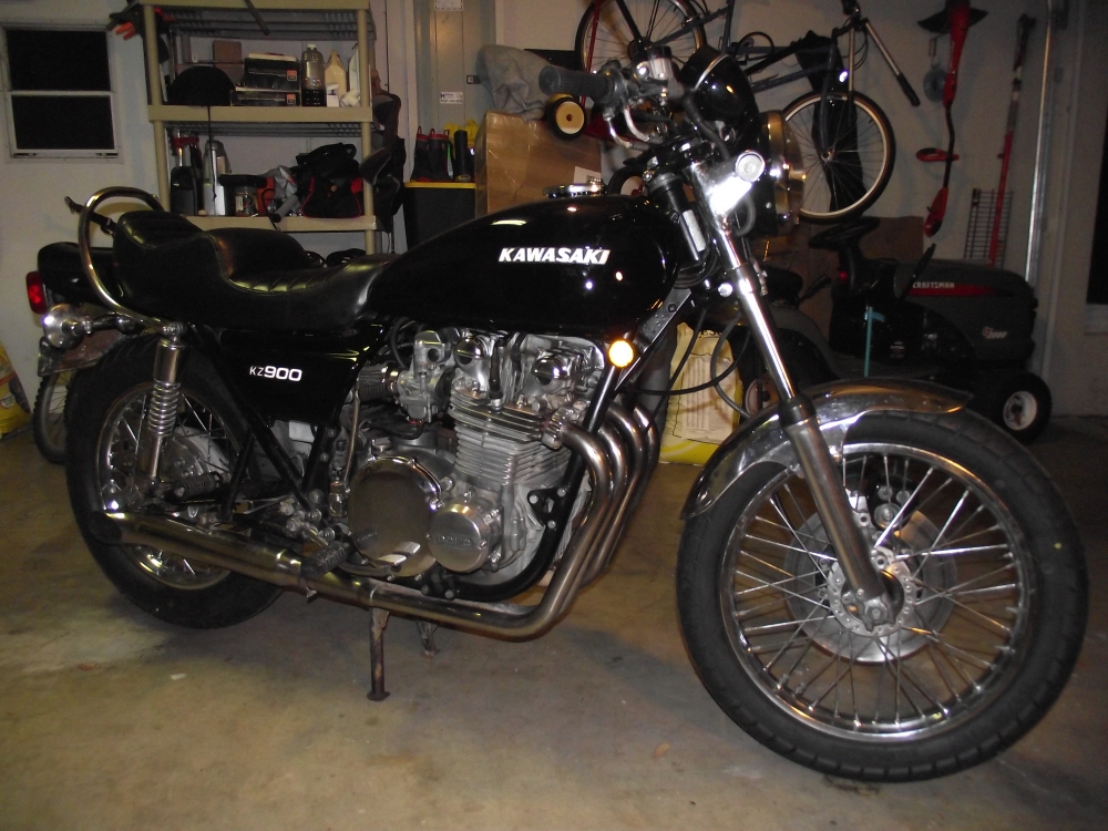

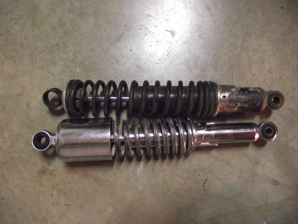

Tried to finish it up tonight. Bled the brakes (gravity and reverse bleed) but no luck. Put on the cables I needed to (new Speedo, tach and attached throttle ones to carbs). Replaced shocks with an eBay set. And put on all the body panels along emblems. Will try to fire it up in the morning.
Still need to finish:
1. Front brake.
2. Fix left side emblem screw hole (apparently rust had enlarged the hole.
3. Install petcock (first make sure no debris left in tank).
4. Put cotter pins in side covers.
5. Double check everything.
Replaced the black shocks in the picture with another temporary set.

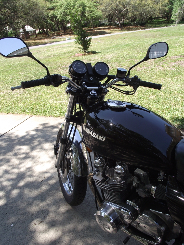

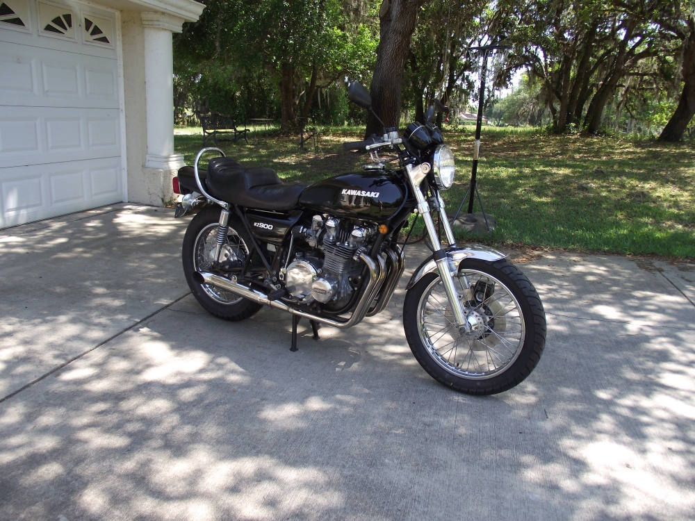

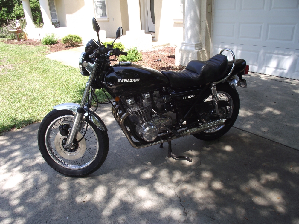

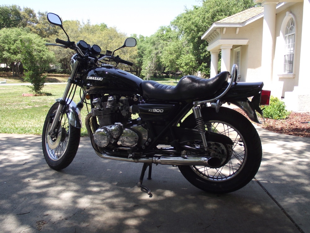

Tried to fire her up this morning. Didn't get very far with my new petcock leaking. Need to address that unfortunetly. Took some outside shots in the mean time.

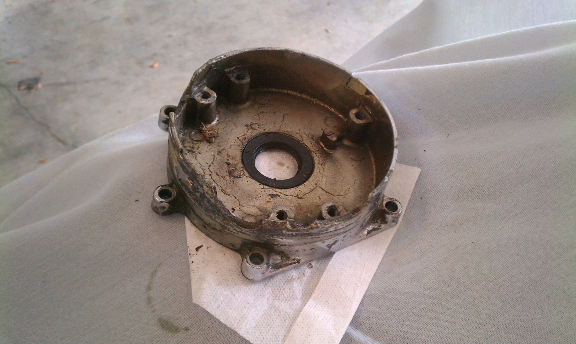

Thanks Leon. And thank you for all the kind words through out my build. Always helps to get some encouragement. Still not running yet. Had a fuel (new) petcock leak issue. Turned out to be that cylindrical strainer filter that came with it (the one that gets inserted into the tank). Kept the petcock from seating correctly. Removed that filter and all is good. Then tried to fire it up with no luck. Finally, checked the spark. Doesn't seem to have any. I had removed the points plate since the last time the bike ran. It was bent (bike must have got hit on the points cover because the points housing had been cracked as well), so I hammered it back flat and reinstalled it. So it could be that or something I didn't plug back in. Anyhow, need to do some diagnostics today and check the voltage at the coil primaries. Once she fires up I plan on taking a video ride on its maiden voyage.

So I finally got the bike fired up again. I had replaced the points housing since the last time and of course never had the opportunity to make an adjustment. Figured it may be O.K. since I a put everything back as it was. Here is what I had replaced:
The points plate inside had also been damaged. So I hammered it flat and put everything back a few months ago. So all I had to do was readjust the points this morning and she fired up. Here is my semi maiden voyage. Couldn't go out on the open road because I still have very little brakes. So just a quick jaunt around the hood. Will work on brakes tomorrow.
