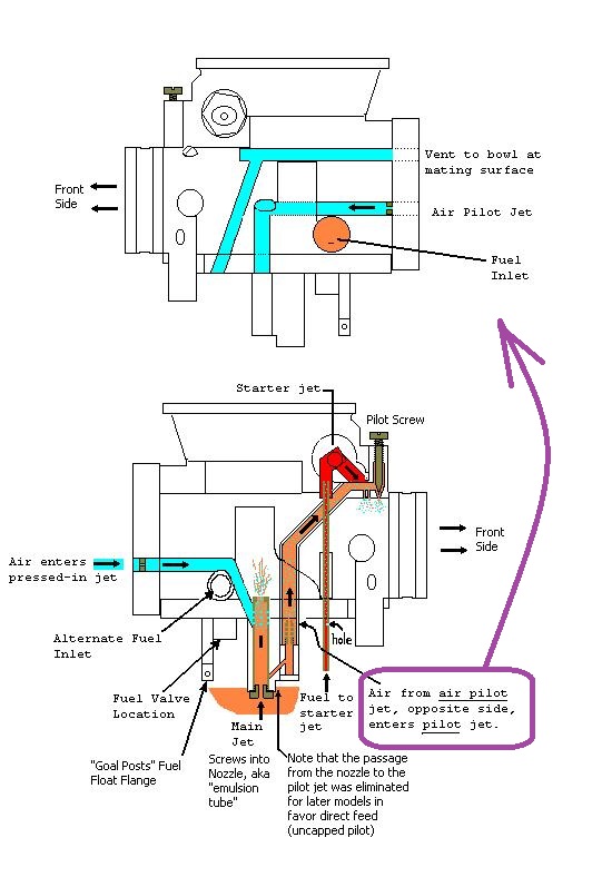

Note that the "pilot jet" is supposed to receive its air supply from the "air pilot jet" and not any extra air which could be allowed into the pilot circuit due to a missing or leaking plug.
When later test running, could try enriching the pilot mixture by turning the pilot mixture adjustment screw counter-clockwise which is supposed to allow more mixture into the carb bore.
I don't know the default position for the mixture screws as number of turns backed out from lightly seated (should be provided in the FSM).

While using carb cleaner spray, is the spray visibly exiting through the orifices into the carb bore?
If the pressurized spray isn't getting through, the unpressurized gravity fed mixture likely won't get through either.

Could be mistaken, but thinking the pods aren't to blame for the lack of mixture being drawn into the combustion chamber with throttle closed.
On the intake stroke, the suction created and pulled through the intake valve is supposed to draw fuel from the carb pilot orifices into the carb bore and on through the intake port into the combustion chamber.
Insufficient suction during the intake stroke might result from a non-opening intake valve, or a leaking exhaust valve, or other source of compression leakage from the combustion chamber.
But as I recall, the compression tested okay, and the spark plugs are staying completely dry, and the fuel level is correct, which keeps suspicion toward the carb pilot circuit.
Is it possible that air is leaking past the rubber plugs into the pilot circuit?
