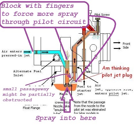

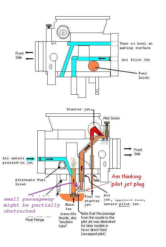

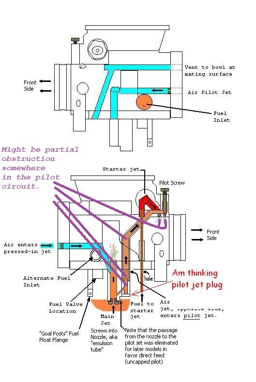

22 Sep 2011 12:17 - 22 Sep 2011 12:18 #478577 by Patton
Replied by Patton on topic Freebyrd's 81 KZ1000 Build
With pilot jet plug removed, and squirting carb cleaner into the pilot jet, spray should exit from both small ports in top of carb bore toward the engine side.
Leave the pilot mixture screw in position while doing the spraying, to better force the spray through the orifices into the bore.
Good Fortune! :)
Last edit: 22 Sep 2011 12:18 by Patton.
22 Sep 2011 12:21 #478578 by freebyrd24
Replied by freebyrd24 on topic Freebyrd's 81 KZ1000 Build
I thought about that before cleaning them last time, then a couple weeks went by and i cleaned out all orifices without pressurizing that passage in between the two jets. I'll give that a shot next. It does sound like the pilot jets are not working at all right now so it makes logical sense. Do I even need the little plugs that cover up the pilot? What's the purpose of them if they were removed on later models?

22 Sep 2011 12:34 - 22 Sep 2011 12:38 #478585 by Patton
freebyrd24 wrote: I thought about that before cleaning them last time, then a couple weeks went by and i cleaned out all orifices without pressurizing that passage in between the two jets. I'll give that a shot next. It does sound like the pilot jets are not working at all right now so it makes logical sense. Do I even need the little plugs that cover up the pilot? What's the purpose of them if they were removed on later models?
Am guessing later version without the plug might have eliminated the small passageway and instead drew more directly from fuel in the bowl, but that's just a guess without having reviewed the cutaway diagrams.
The FSM likely has the appropriate diagram for the particular carb model at hand.
