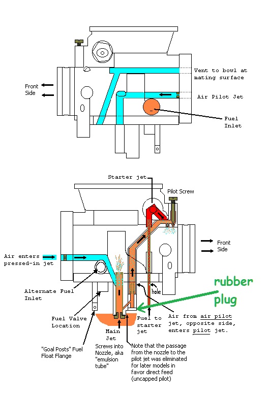

03 Oct 2011 11:48Patton wrote: ...Is it possible that air is leaking past the rubber plugs into the pilot circuit?....
Referring to the rubber plugs at bottom of pilot jets.
- freebyrd24
- Posts: 468
- Thanks: 4
Re: Freebyrd's 81 KZ1000 Build
03 Oct 2011 11:50
Inside of the carb inside the bowl? The piece that plugs nup the pilot circuit? I have what appears to be a metal plug with a rubber oring on it. Those are appear to fit in snugly. Would that cause an issue?

03 Oct 2011 12:13freebyrd24 wrote: Inside of the carb inside the bowl? The piece that plugs nup the pilot circuit? I have what appears to be a metal plug with a rubber oring on it. Those are appear to fit in snugly. Would that cause an issue?
Fitting snugly is good.

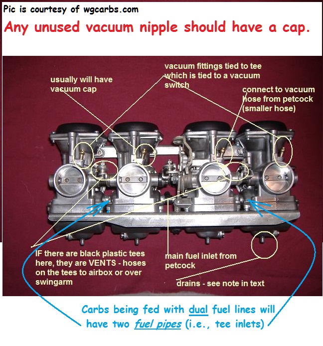

- jmoney05
- Posts: 107
08 Sep 2014 17:32On my bike I'm not using the vacuum petcock , so should the petcock vacuum line fitting be plugged? Bike is running great with no plug there!
Vm26 carbs...thanks for any input!
1978 Kz650D
- Posts: 18568
- Thanks: 2101
08 Sep 2014 19:38
Any unused vacuum port should be plugged during normal running.
An open unplugged vacuum port usually results in a large undesirable air leak and a "racing" idle.
