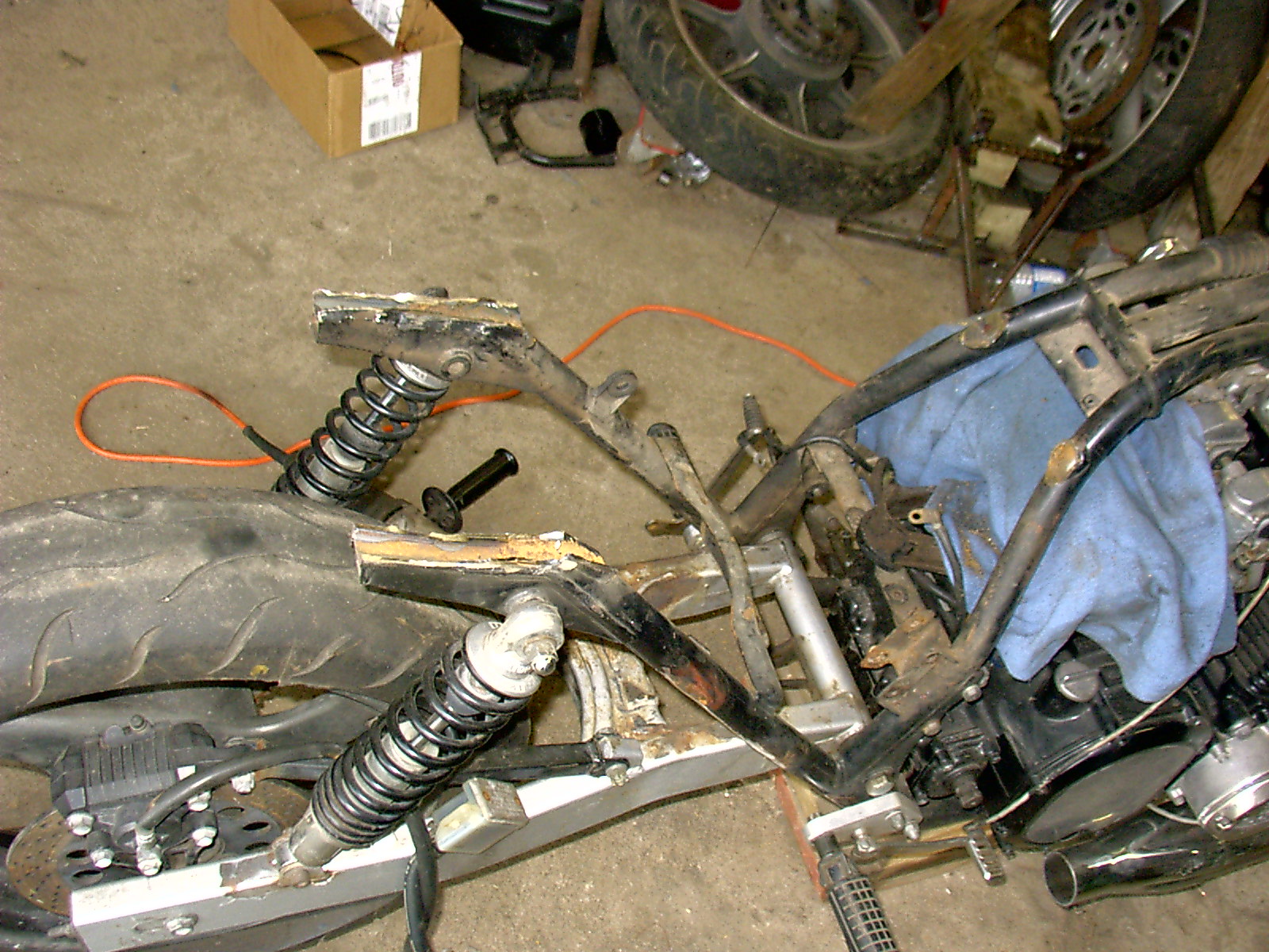

hey freedbyrd,the katana 600 is steel and gives you the extra length.i believe you could fit a 180 in it no sweat.we put one in my buddies kz1000.
excuse the butch job :ohmy: .

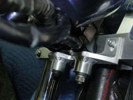

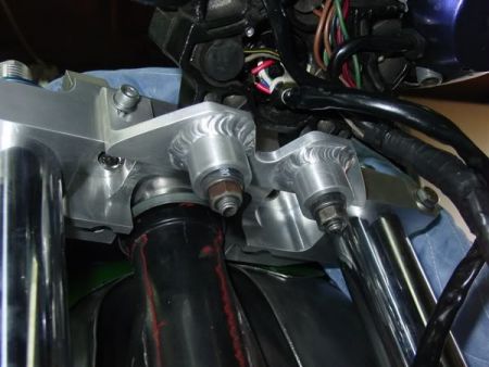

i also have a pic for an idea for mounting your gauges.
