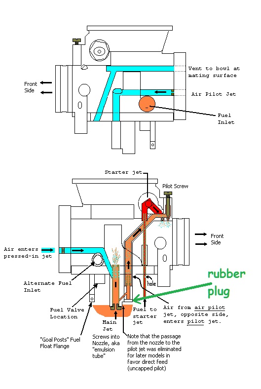

09 Jul 2011 15:06 - 09 Jul 2011 15:07freebyrd24 wrote:No gas on the plugs :dry:Patton wrote:Immediately after an unsuccessful effort to start the engine, is there any sign of fuel on a removed spark plug?
No gas on any plug is puzzling, because it suggests a malfunction common to all cylinders.
Given acceptable compression, and presumably correct cam timing, would presuppose that all intake ports are appropriately "sucking" from the carbs, but not pulling any fuel mixture.
All of which suggests a malfunction common to all carbs.
If the carbs at hand are supposed to have rubber pilot jet plugs, are the plugs correctly fitted, and in good condition?

This link might be faster and easier to navigate:
www.thegsresources.com/gs_carb_04.htm
Here's the 043 Pilot jet plug:
