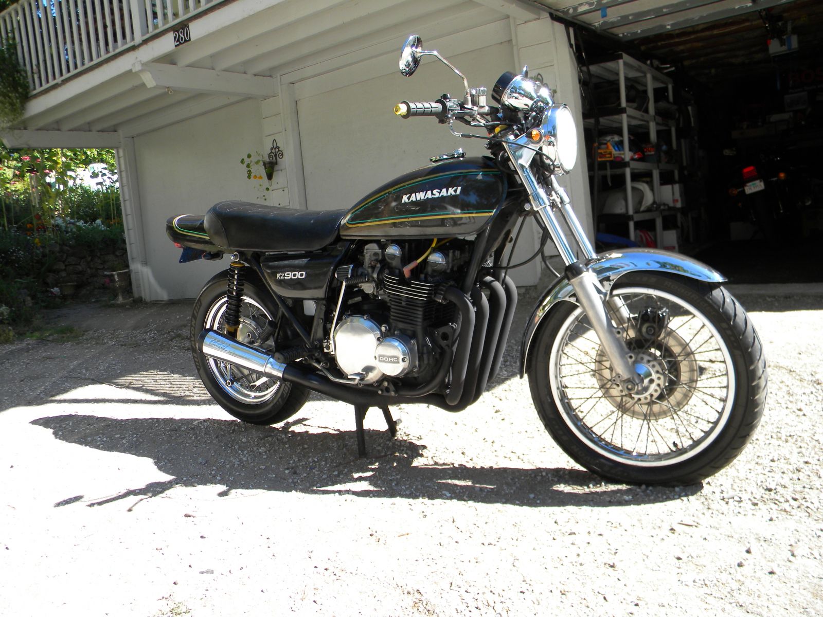

dont say that because that is the set i want to send Greg....i know...i know...it is bad ass with about 25 coats of turtle wax and the last one thick and let dry then buff it out by hand right over all the years dents and nicks ....looks like an old patina dodge dart or something....i half want to save it...but in reality when you see a new set done....every spec on the bike then needs furb and the old set will be forgotten ...it is only original once as a painter said
i have pile of goodies and disks ect..since before any other bikes showed up...this thing is long on deck for a full redo

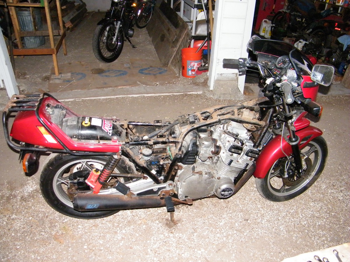

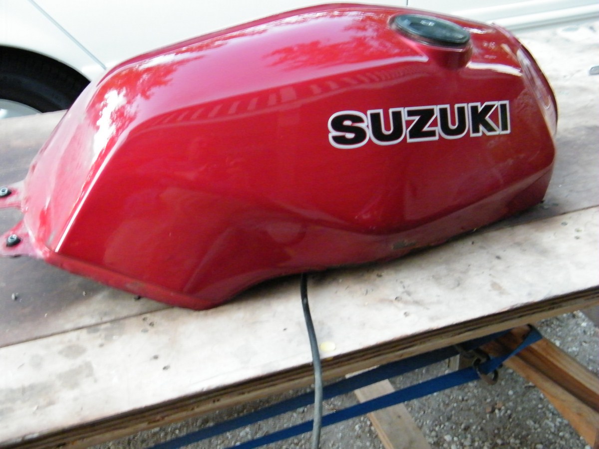

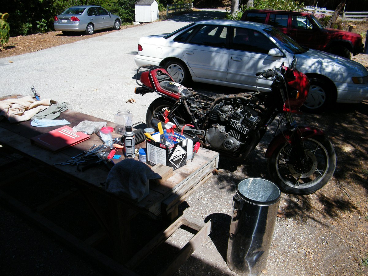

got the tank off with lots of saved pics as i go for my records, pics for gas and elec connects.. ..if i unplug it..i am gonna mark it...never worked on the 80 i had for a while.....pretty fun ..battery out..ready on the charger with a new one..
we'll find out today if a gs1100 can sit without starting since 98 ...

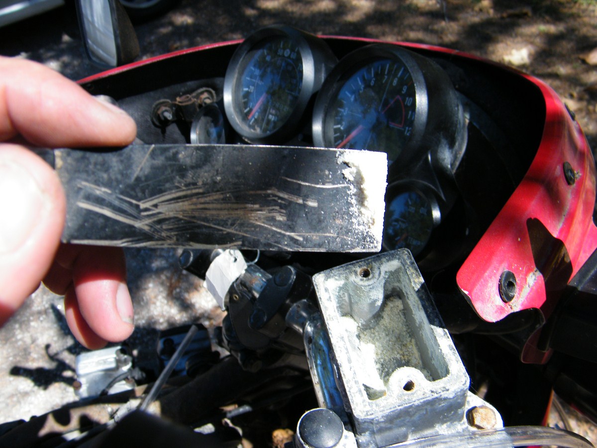

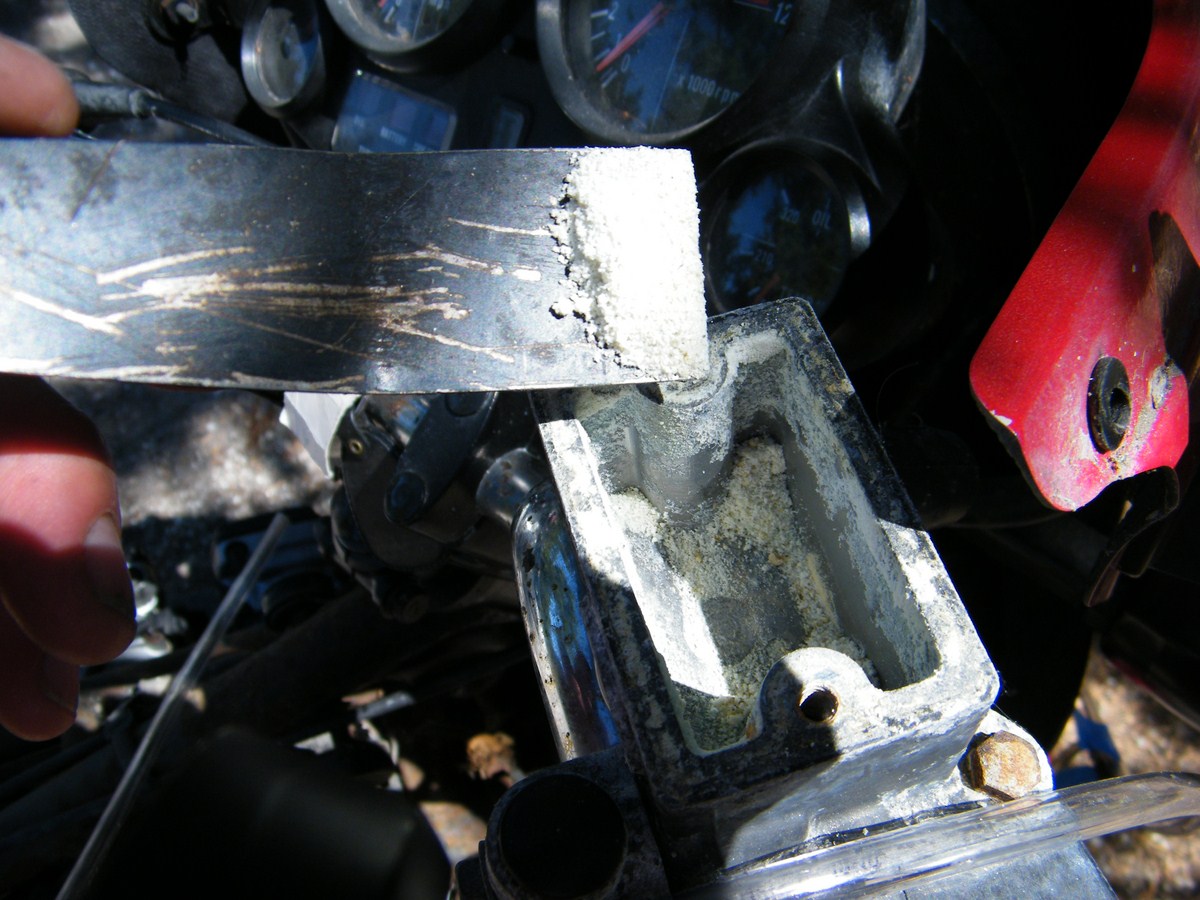

no front brakes and i wanted to fix that while i had it on ground level again from last night,fogged window and 0 brake lever feel.....but found it full of dust..it had turned to crystals....got fluid after a rubber mallet..all the bleeder screws took the worst of the exposed iron stuff and are butter soft..vise grips and a new complete bleeders screw order list ,,,,but vise grips for now to complete the bleed...nature smoothed ...
had to pop off the bubble to bleed em...next is oil and and gas....lunche
got pics of the crystals

this is a first for me..window was fogged...got it all blown out and tried addning fluid...it bubbled and drank one fill then bubbled the second and still tons of effort no brakes...may try and fire it in the morning but i need a new master cyl it is popped ...got some new clean fluid out of the one side just from the filling of the lines and tub twice...........find a score on new front mstr
no use starting it( or not there yet/putting gas in the clean dry tank /no use trying) when i have to free wheel as rolling it around now..i want to be able to apply brakes if it runs
argh....
argh....

Dear lord that is some nasty stuff, certainly not what you want in there while trying to make the brakes work.

Have you tried snorting that stuff Tri? :woohoo:
