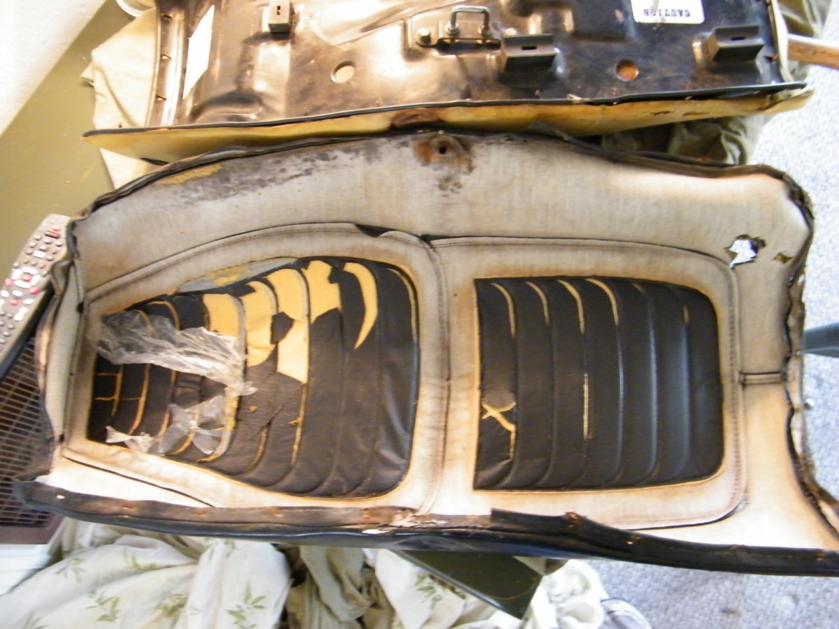

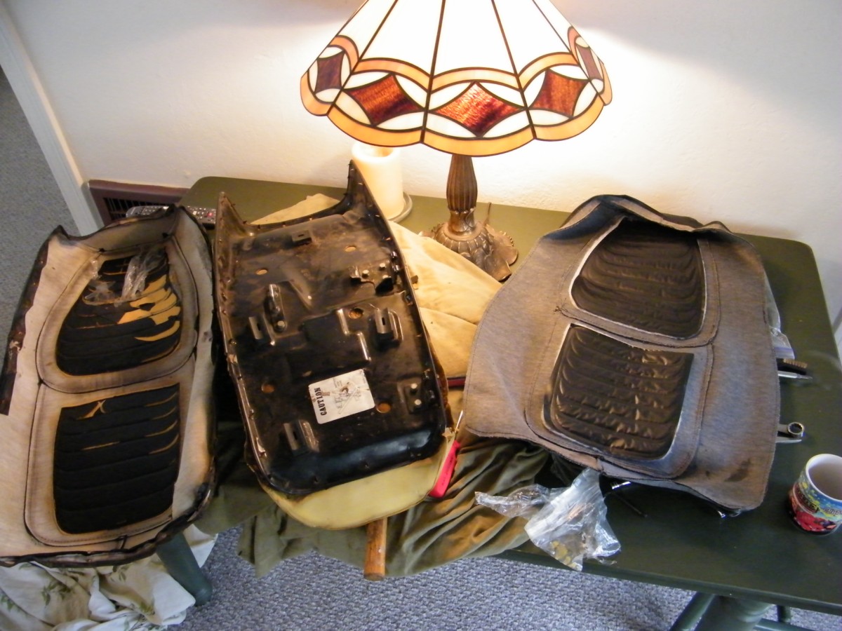

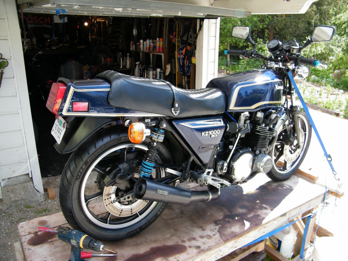

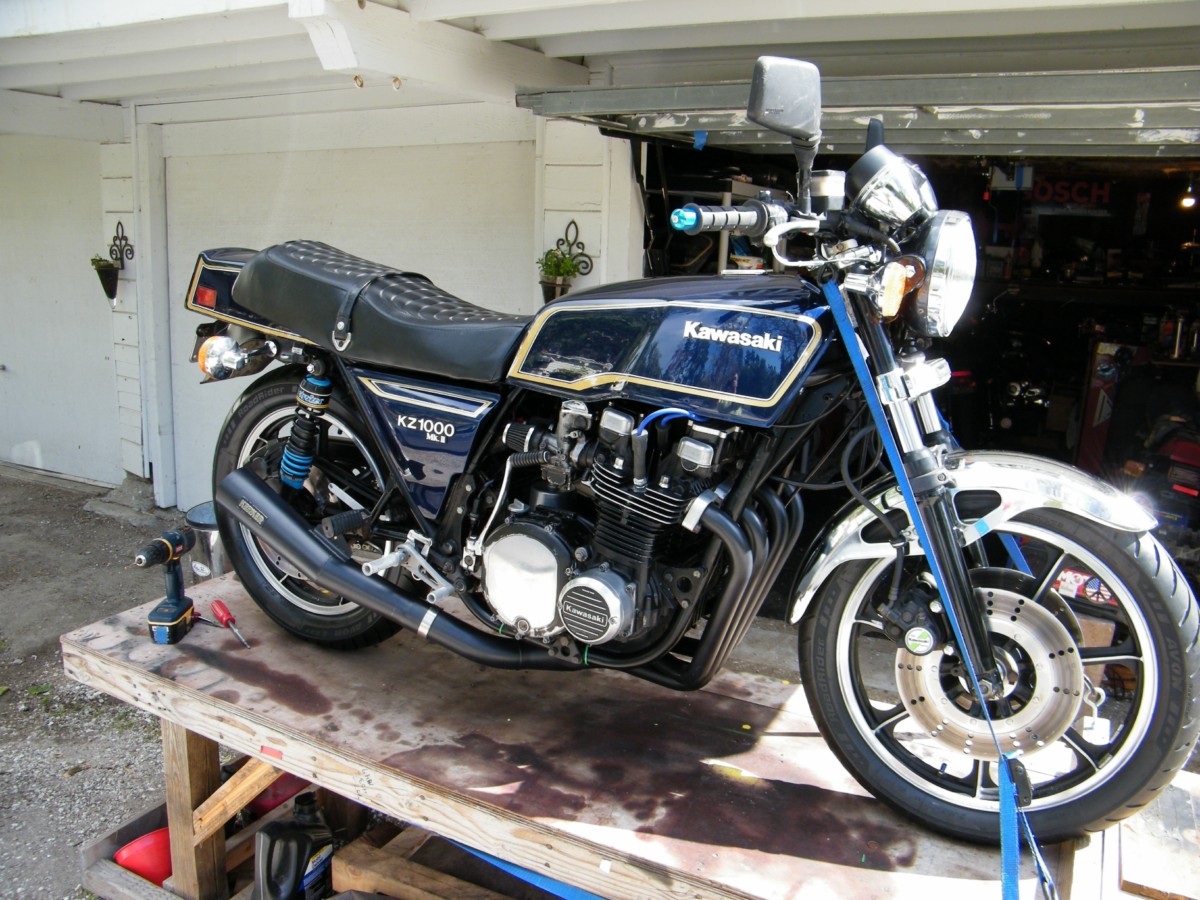

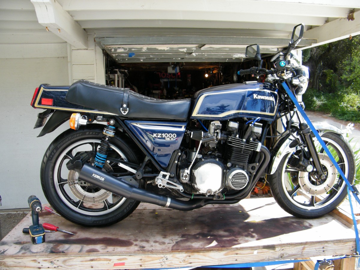

bunch of little adjustments ,detailing stuff,engine paint re-touch,and some riding and i should be set for friday morning....

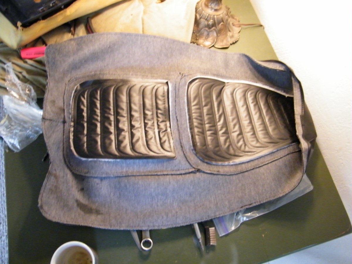

the seat cover was well worth the money and i can say 100% that it is a sure enough likeness ....it went on easy and this seat is a drag with a heat molded original......
here are some pics for the MKII guys that wanted a review and a link to the seller

No eBay APP ID and/or Cert ID defined in Kunena configurationthe cover came fast and well packaged although it had no instructions....duh...like it needs em...kinda does...i sat mine in the sun for an hour first and went slow...back center...front center...one pin in each corner and worked and reworked the sides and corners....looks great up close too...for being a repro imo.....
100 % satisfied ,as they said i would be too,

Wire came loose from the bench to the first ride ....inside the head light....one hazard stays on no headlight or turn signals...no big...need to adjust the throttle cable...and a bunch of stuff...front end needs tweak to the left/aligned/steering bearings tight....countless little things but i can hit those after work each day....psi is goofy on these new avons..harsh @ 36 front 34 rear...
It screams and hauls ass....now if i can get it to feel half decent ...by friday
