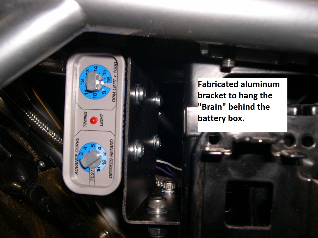

03 Sep 2011 11:58tk11b40 wrote:
Back to the KZ...
I received all the electrical stuff from Z-1 Enterprises, they are the best!!
Now I have the bike all torn apart again, putting in the new Dyna 2000 ignition. So many wires hanging all over the place, I will be glad when this thing is done.
The install is pretty straight forward, it's just the thought of getting into the wiring yet again.
I fancied up a flat pattern for the Brain bracket and hung it behind the battery box.
Oh man, that's nice!

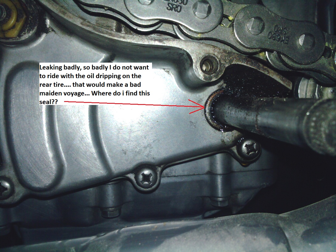

HELP!!
I parked the bike on the street, and after an hour, there was a huge oil slick under it, looks like the shift shaft seal is bad....
Where where where do i find this seal??

06 Sep 2011 02:26:S :S
I must have this Seal??? I can't find it on the Z-1 Websight, I have found it on some sight from the netherlands, but wary of giving up the Credit card # to an outfit I know nothing about.
It's gotta be some standard Japanese seal.....anyone?

Re: 1975 KZ 900 , ZRX Swingarm, 89 GSXR front end
06 Sep 2011 03:59
It may not be available individualy, but isn't it included in the seal kit on Z1's website?
www.z1enterprises.com/Engine-Oil-Seal-Ki...Z900-KZ1000-181.aspx

06 Sep 2011 04:01At kawasaki.com after getting to 1975 Z1, look under "Engine Covers" to find part number 92049-004 shown as still "active," meaning supposedly available through Kawasaki dealerships.
Here's a link for help with navigating the site and finding information.
kzrider.com/index.php?option=com_kunena&...w&catid=13&id=376734
06 Sep 2011 08:32
They should be out there somewhere. I bought a kit that included both shift shaft seals (one for the outer engine cover too) and the countershaft seal. My MKII leaked from there too. Not a drop since replacing the seals. I think I got the kit from Z1E but might have been eBay.
06 Sep 2011 19:51
Is this the one you are looking for?
www.schnitzracingstore.com/catalogs/cata...26698&showprevnext=1
06 Sep 2011 20:07racer54 wrote: Is this the one you are looking for?
That's it! Takes 2 but the one in the sprocket cover is just for support...not sealing any oil.
.....has oil leak, $5 part, easy fix..... :laugh:
