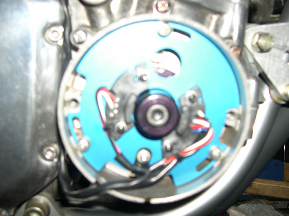

29 Aug 2011 02:38 - 29 Aug 2011 02:42Back to the KZ...
I received all the electrical stuff from Z-1 Enterprises, they are the best!!
Now I have the bike all torn apart again, putting in the new Dyna 2000 ignition. So many wires hanging all over the place, I will be glad when this thing is done.
The install is pretty straight forward, it's just the thought of getting into the wiring yet again.
I fancied up a flat pattern for the Brain bracket and hung it behind the battery box.

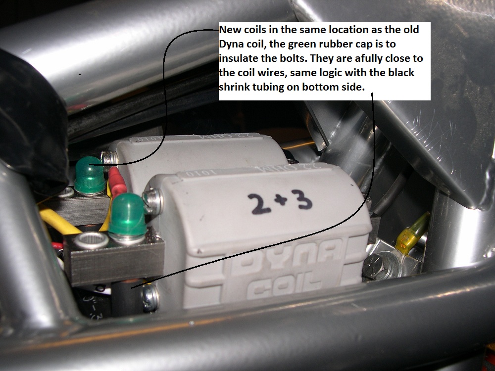

29 Aug 2011 02:40The old Dyna coils were for the point type ignition, so they had to be replaced with the new coils..
