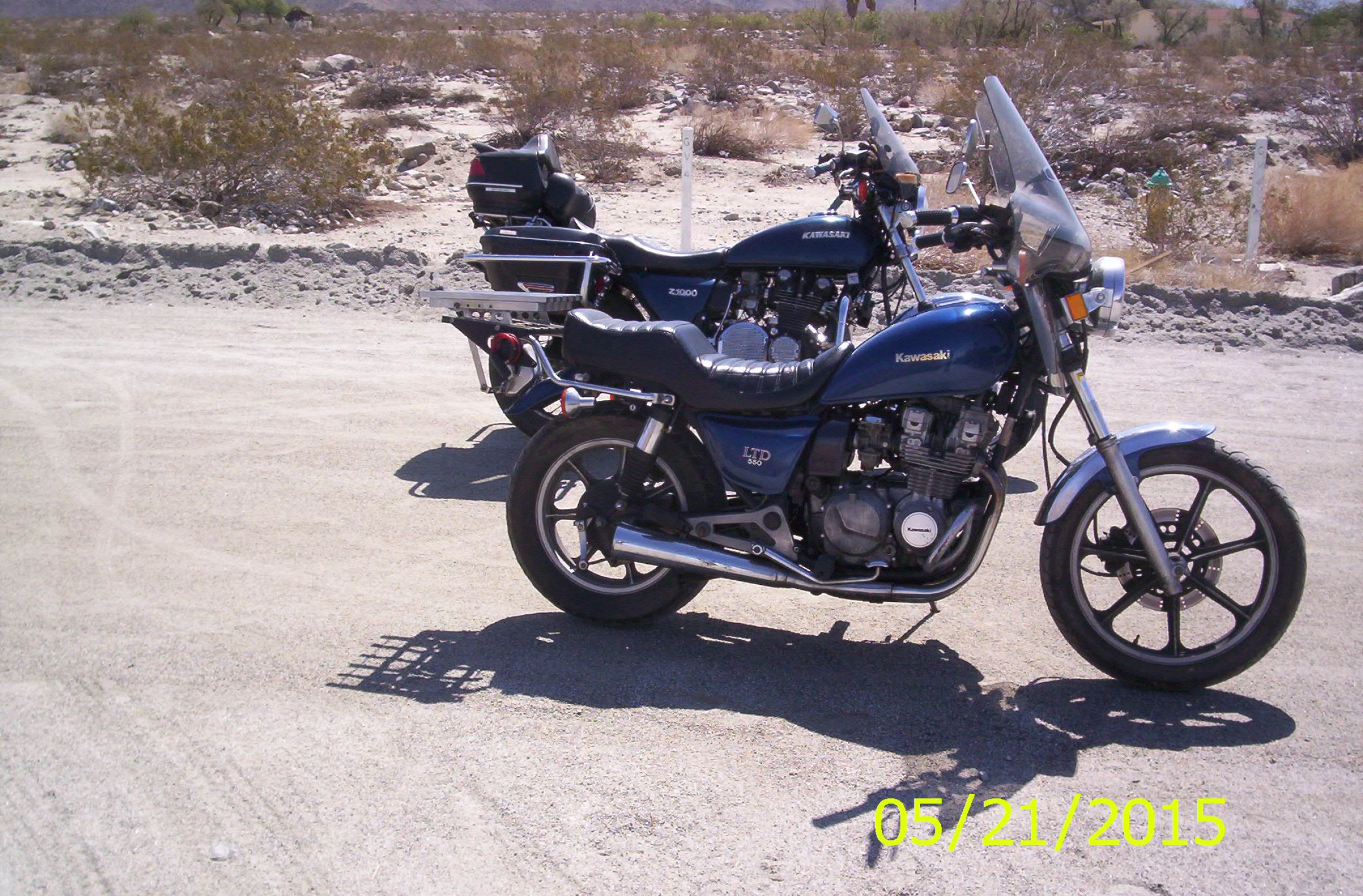

What would you think it is actually worth as is? Not running, low compression, VERY clean, no rust, inside of gas tank is pristine but there is one sizable dent on the opposite side of the picture (repairable for sure), and a rip in the seat. I would think a few hundred is the top of the mark for any run-of-the-mill (not very collectible), NON-RUNNING, Japanese bike but maybe I'm off. I'd guess most would pay scrap value plus some extra for any parts that could be sold.

Once running the compression can come up. I'd get it running then decide what to do with it. Last year I picked up a non running KZ 550 for free. All the shops told him it wasn't worth fixing. Cost me $100 in gas and a few hours working on it. Sold it with no title for $800. The guy that got "FOUND HIS BIKE."Big grin from ear to ear when he rode it away. Could have got as much as $2800 if I got the title.

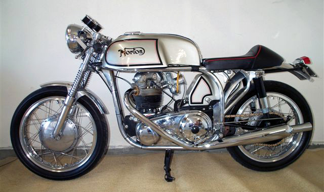

HOLY CRAP!!!! Are you kidding?? If not, you really need to do a LOT more study on the subject because you are VERY confused. Except for the fact than both machines have two wheels there is very little remotely similar between the two. You may want to attend a flattrack race or two so you can start to appreciate the level of effort that goes into building a flattracker. Below is a good example of each. Ed
Lesson #1:
FLATTRACKER
Attachment harley-davidson-xr750-racer-2-4441-2.jpg not found
CAFE RACER

Sorry, I guess I was speaking from a styling perspective of a custom build on a Japanese bike. Obviously the two are very different from a purpose perspective like suspension settings and engine tuning. Regarding your examples, that HD XR is a factory built oval track bike made to spend its life mostly sideways drifting turns. The Norton isn't far off from factory either. Take the Harley and throw on some clip on bars, change tires to a slicker tread, and ditch the giant air filters and I think most lay folk would assume they are at least cousins of the same bike style family.

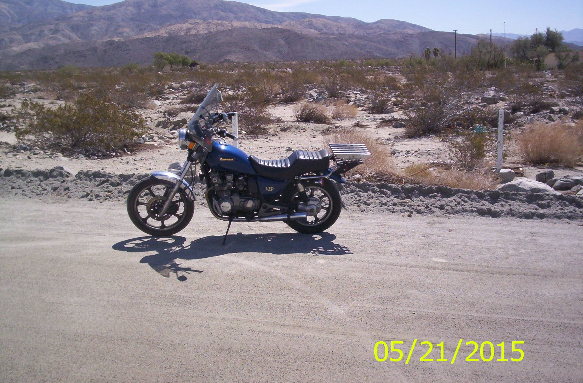

The kz750M is different in many ways from the 76-79 "B" The head-stock rake on the M is 28.5 degrees while on the B it is 26.5 degrees. The M has more fork offset, and has leading axle forks while the B has standard forks. all of this will make it handle "slower" than the B models, but be more steady at higher speed.The M has a 16" rear wheel while the B has a 18" rear wheel. The the sub-frame seat rails are much lower on the M than the B to accommodate the cruiser look Kawasaki was going for. There are also some mechanical differences, namely the carbs, but also components of the engine such as the clutch adjuster.
Not the most Ideal candidate for a cafe racer, TBH, but that doesn't mean it can not be done.
If you haven't ridden this style of bike before i would suggest you get it running and make sure there are no surprises waiting. Then ride it a bit, and if you find you like it then do whatever the hell you want with it. As you said, a non-runner of this particular model, even if its nice, isn't worth much. If you need a copy of the Factory Service manual PM me your email.

06 Oct 2016 21:31tv_cafewannabe wrote: .................Take the Harley and throw on some clip on bars, change tires to a slicker tread, and ditch the giant air filters and I think most lay folk would assume they are at least cousins of the same bike style family..
They might assume that , but they would be incorrect.
