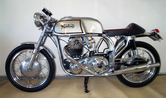

07 Oct 2016 06:04I think he's confusing flat tracker with street or brat tracker.650ed wrote:tv_cafewannabe wrote: . My understanding of the difference between a flat tracker and a cafe bike are really just the handle bars and a the fuel tank on a tracker is typically smaller. Just about everything else is interchangeable from a design perspective.
:woohoo: :laugh: :laugh: :laugh: :laugh: :laugh:
HOLY CRAP!!!! Are you kidding?? If not, you really need to do a LOT more study on the subject because you are VERY confused. Except for the fact than both machines have two wheels there is very little remotely similar between the two. You may want to attend a flattrack race or two so you can start to appreciate the level of effort that goes into building a flattracker. Below is a good example of each. Ed
Lesson #1:
FLATTRACKER
Attachment harley-davidson-xr750-racer-2-4441-2.jpg not found
CAFE RACER
