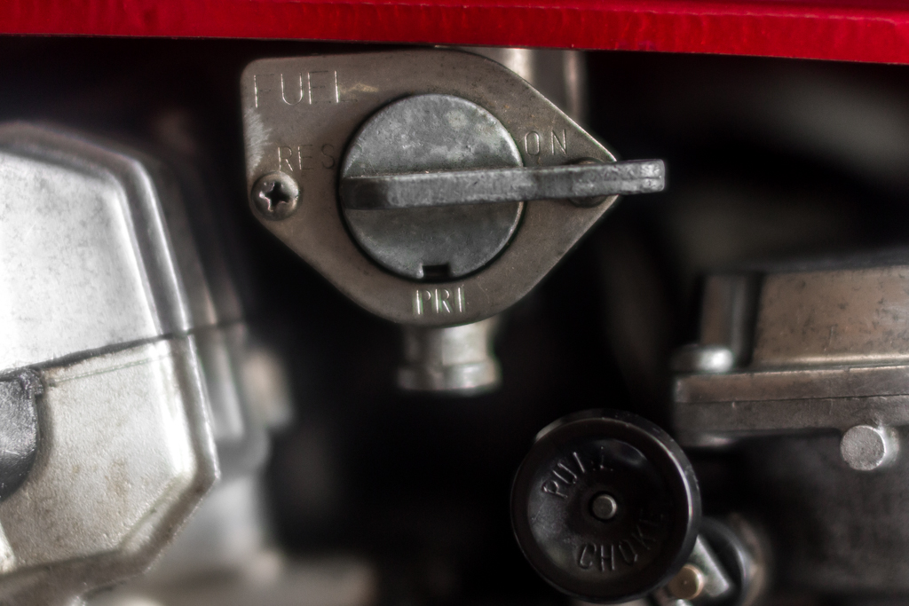

So to make sure I'm on the same page with this petcock business, I was unsure if the picture below was in the "ON" position or the "RES" position until I ran it out of gas and had to use it. Wasn't sure if the turn handle was "pointing" to the "RES",
My further question is...what is the "PRI" for? what does it stand for? when is the setting used?

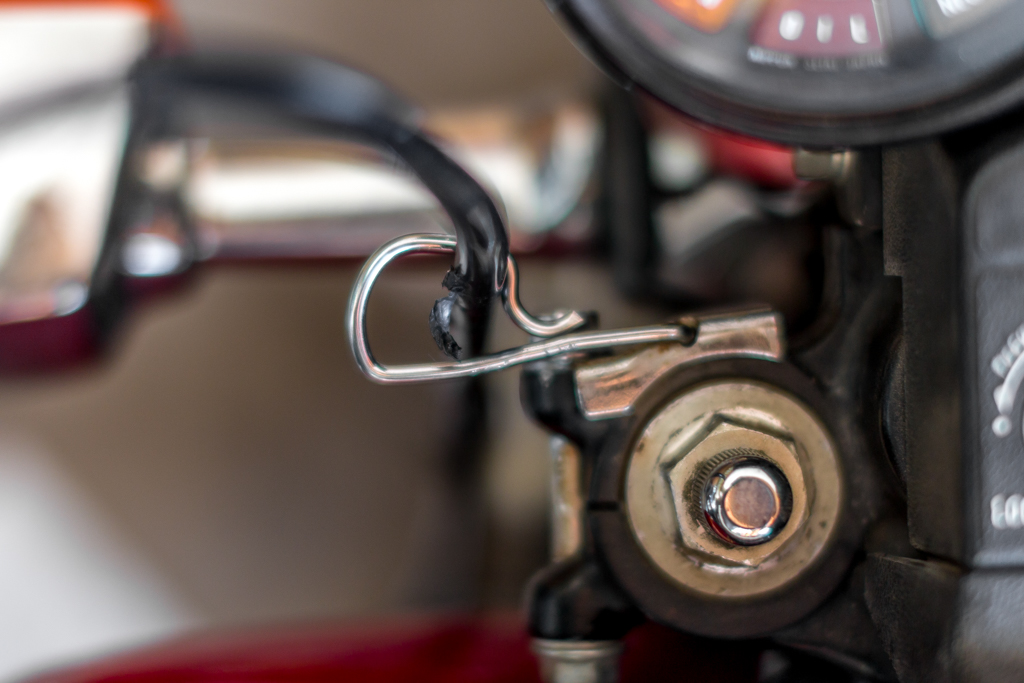

In other news my clutch cable kept getting snagged and torn up by the mounting/clamping bolt head every time I turned to the right. I tried to solve it by moving the clutch lever up the handlebars an inch and it did help, but the cable was still being damaged by the bolt head. So since the guide was already screwed up pretty badly (see pic of gages earlier) I bent and extended the guide out and away from the bolt head. The aftermarket handlebars just extended the clutch lever just a bit too far, but now it should work well with no worries.

This is what wiredgeorge answered about petcocks on another website, he's in the business of rebuilding carbs for many decades
A manual petcock will generally have an ON, OFF and RES (reserve) position. The vacuum petcock will have a RUN, PRI (prime) and RES (reserve). In case this hasn't been covered, prime is for opening the petcock to flow gas without the engine running to fill the carbs in the event they are dry before starting. This position is usually not necessary if the bike has been operated within the past few weeks.
and this is how my cables are routed to give you a better idea of how you should bend the loop so your cable isn't getting kinked or the sheathing getting mangled up

10 Jun 2016 14:37 - 10 Jun 2016 14:41pete greek1 wrote: This is what wiredgeorge answered about petcocks on another website, he's in the business of rebuilding carbs for many decades
Pete
Interesting. How long would somebody leave the valve in PRI for to refill the carbs typically? I'm guessing like 5-10 seconds??? I'd imagine this would be used after bringing the bike out of storage or after working on/cleaning the carbs or further engine work.

10 Jun 2016 15:50SmokyOwl wrote:pete greek1 wrote: This is what wiredgeorge answered about petcocks on another website, he's in the business of rebuilding carbs for many decades
Pete
Exactly.
