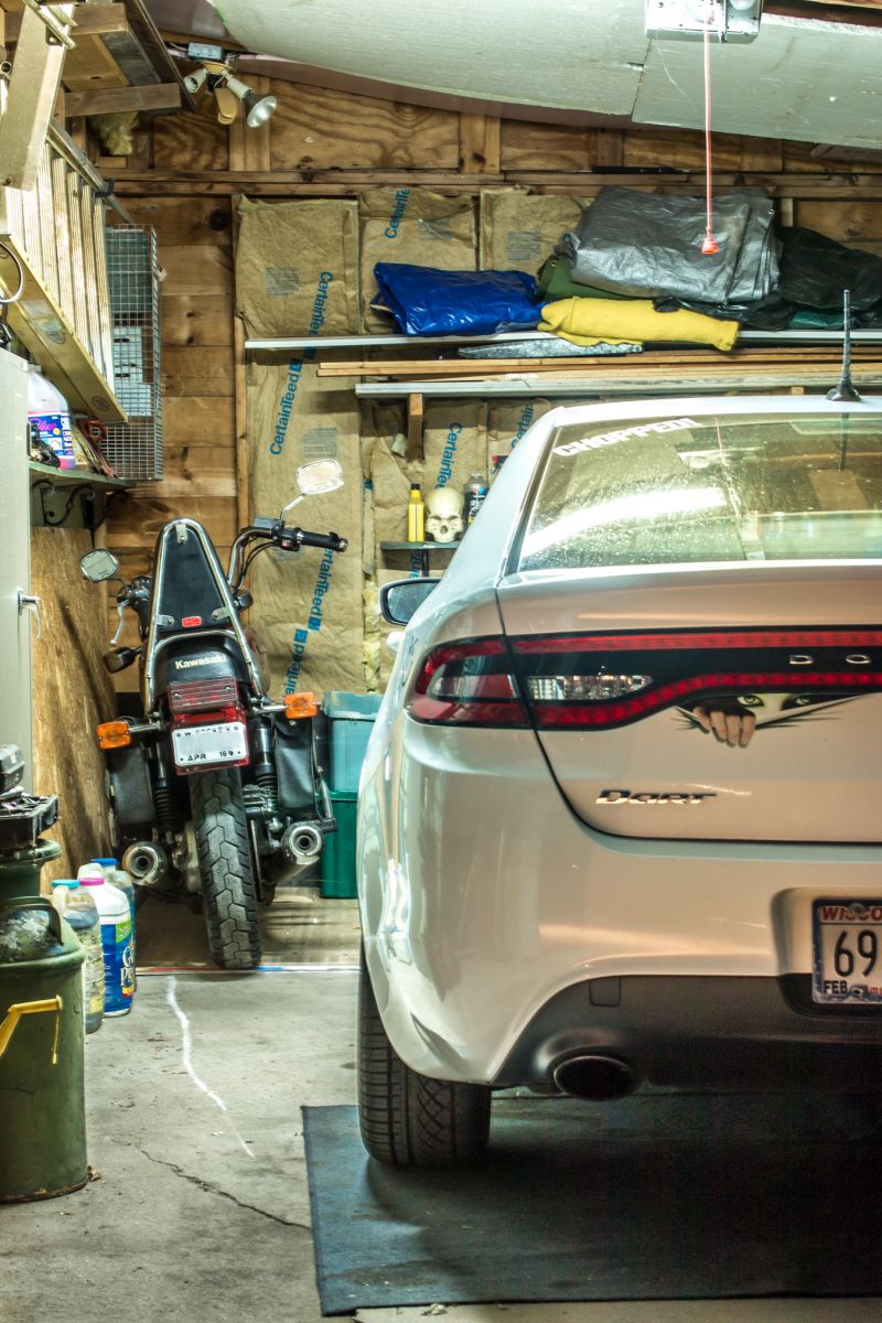

So I managed to fit my bike in the garage, I was really worried about space. Cleaning the garage out a month ago really paid off.
Now my car and bike will get to know each other better!
I know, I still got to put the bike on it's centerstand, but I'm going to need to jack it up in place for that to happen, probably next weekend.

15 Nov 2015 16:15??SmokyOwl wrote: ...
If you just need to get it tight into the corner turn the bike around and back it in.
The thought had crossed my mind, but the battery access is easier this way, rather not work between the bike and the wall. Plan on removing the battery and keep it inside until taking it out and hooking it up on weekends for weekly starting.
