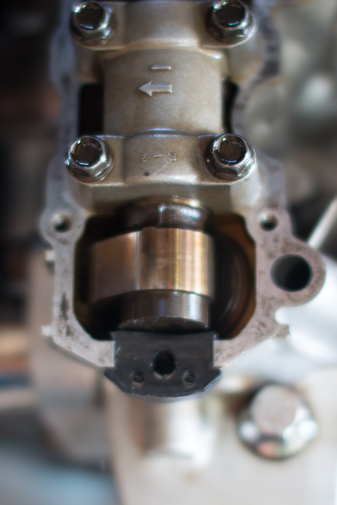

Well things went fairly smooth. If I have to do it all over again cause of a leak...I'll know how to do it faster now. Left the black plugs alone, I was running outta time and it was stupid hot & humid out there. I'm sure it'll leak a lot less now if at all, I did a really nice job cleaning off the old gasket material. One thing that bothered me were looking at the camshafts....a couple of 'em had a gold/copper finish to them instead of chrome. Looked like they heated up too much. I also found the "small leak" was actually several "small leaks" all over the place lol. Cleaned up the cover nicely, there was a lot of old caked-on oil in the middle where I couldn't see.

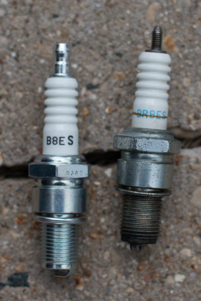

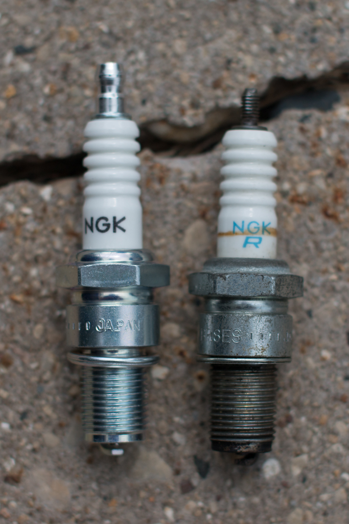

Oh and as far as those spark plugs....it's weird, I have BR8ES plugs in the bike now...they work fine. But both the manual and the stores computer has B8ES plugs. I'll still have to do a comparison between the two plugs as I haven't put them in yet, but I found this to be very strange. More details about this to follow.

So update on those spark plugs....they are physically identical except I noticed the "R" under NGK. I'm thinking maybe the electrode might be a bit different? I put the new ones in, ran just fine.
And here's a pic of that gold colored camshaft....

Gold color is normal. R is for resister. Check what it says on the sidewall of the tires. I run 45 LBS in mine. At 30 it would waddle like a duck. :lol:

Like swest wrote, R is for resistor. Those plugs are designed to reduce RF interference. When using those plugs, be sure that you are NOT using resistor wires or resistor caps. Too much resistance can create problems.
