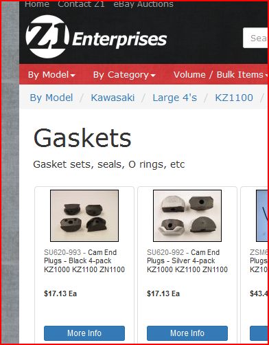

The black plugs on the ends of the cover....the shop mechanic strongly advised me to replace them as he had issues with the plugs in the past. Any backup on this viewpoint? I've seen them on eBay, but they are hard to come by and I have a long 4-5 hour trip up north next weekend so unfortunately I have no time to spare to order parts.
Secondly, the plugs require a gasket maker sealant. The shop mechanic advised going with the "Ultra Black" RTV sealant, it is designed for 500 degrees (intermittently) and maximum oil resistance. However, next to it I found the "Ultra Copper" which is not as good in oil resistance as the black, but is designed for the higher 700 degrees heat. I currently purchased the black, but am having doubts with the temperature.

If you are talking about what are commonly called cam end plugs and you have any doubt about them, replace them. They are not expensive and are widely available at dealerships, Z1E, partszilla, etc.
For sealant, Three Bond is best (aka, Kawibond, Yamabond, Hondabond, etc.)
