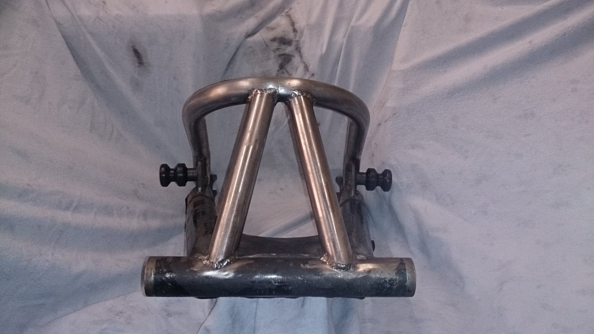

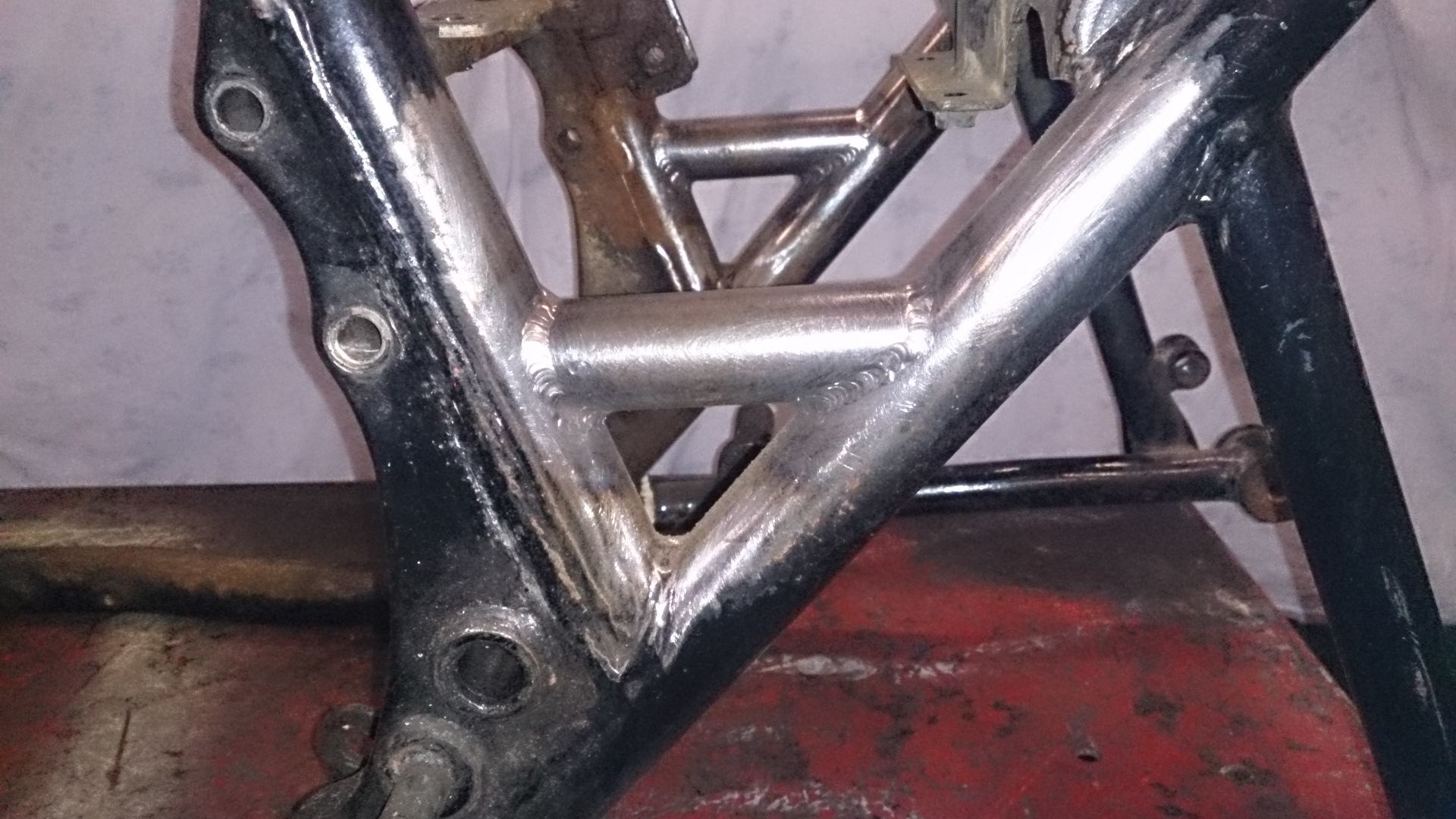

The frame bracing and swing arm bracing was commissioned by the previous owner, it's a common thing over here, it tightens the frame up, kits can be bought on the internet, i put the adjustable TEC shocks on, which i have adjusted to around 370mm in length, around an inch higher than stock they are made in the UK and are fully re-buildable and a good price, the front forks are just standard with a grade higher oil in them, just these simple and not expensive things make for a better handling bike, here is a link for the shocks, and cost me at today's exchange rate $180 usd, also some pictures of the frame mods. P.S i am only around 150lb's wet a year ago i was over 220lb's.
