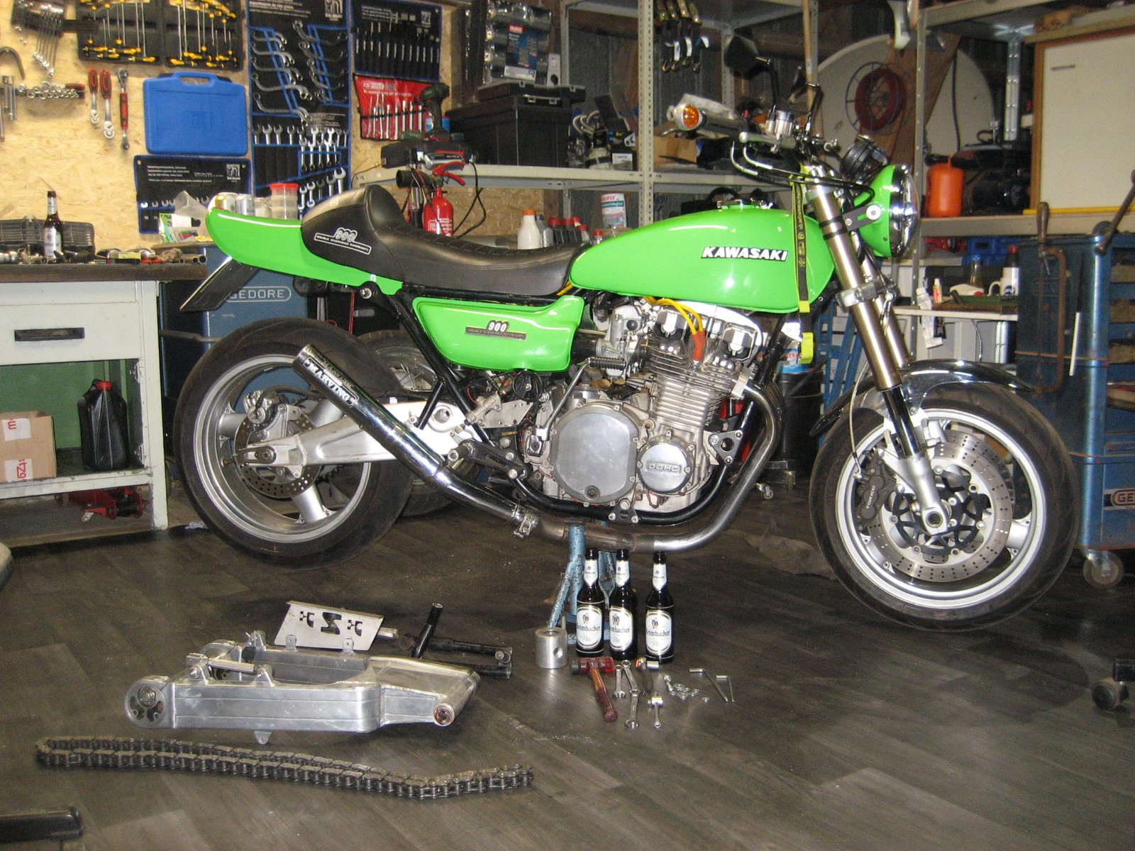

Im looking to possibly build a swingarm for my Z1. What other models share the same pivot tube so I dont hack up a Z1 or early KZ arm?

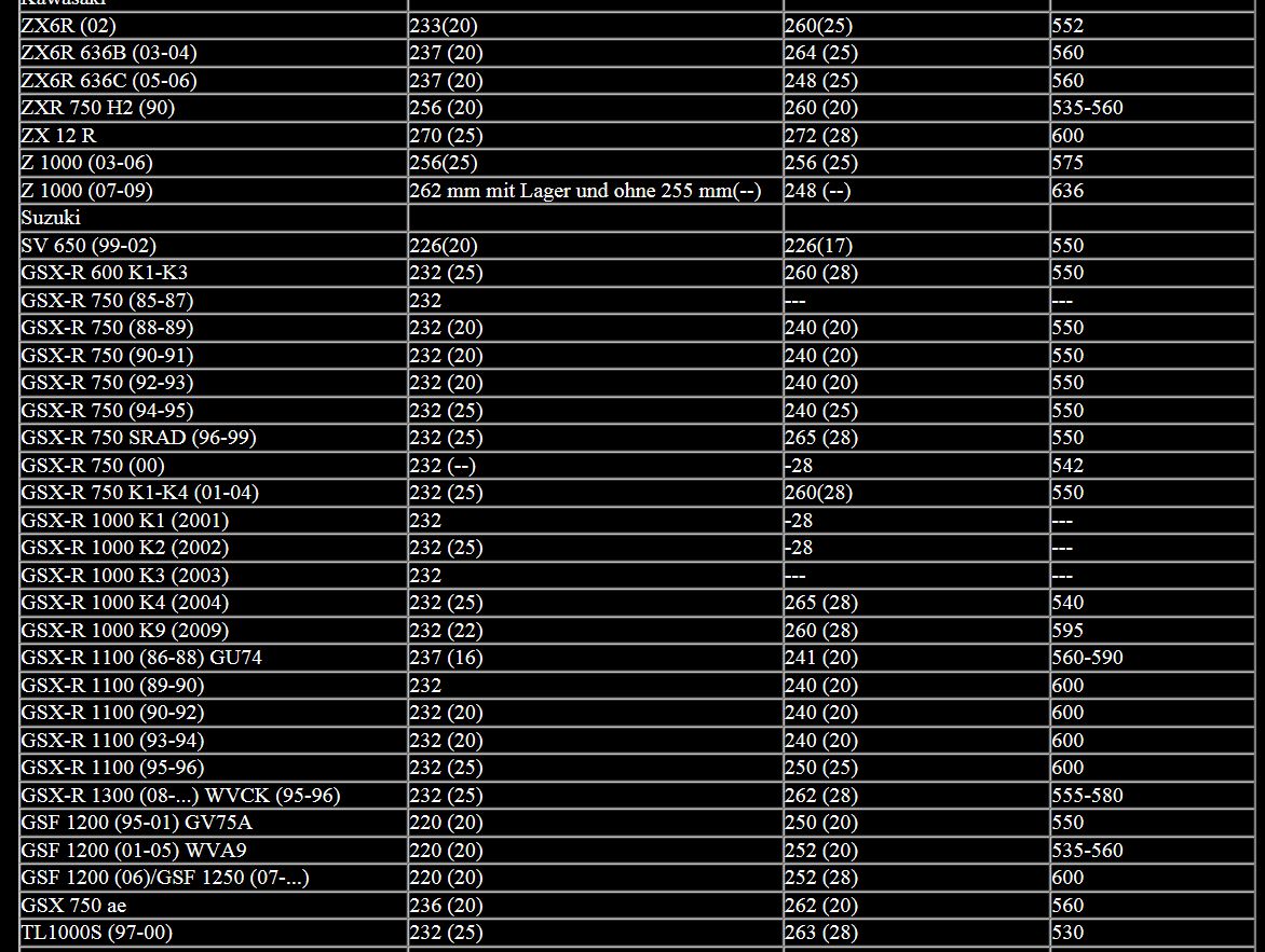

As fare as i know the GSX-R 1100 (86-88) GU74 share the same 16 mm OD pivot tube as Z1

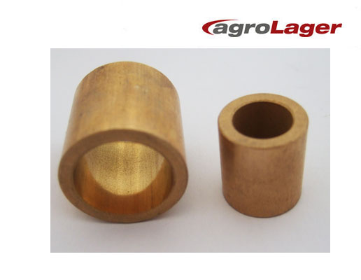

All other swing arm (Z1 = OD 16 mm pivot to swing arm 20 ,22 ,25 mm OD pivot ) need a brass sleeve/bushing for the Z1 16 mm pivot.
Some swing arm charts
www.sellifighter.de/technik/masse/masse.htm
