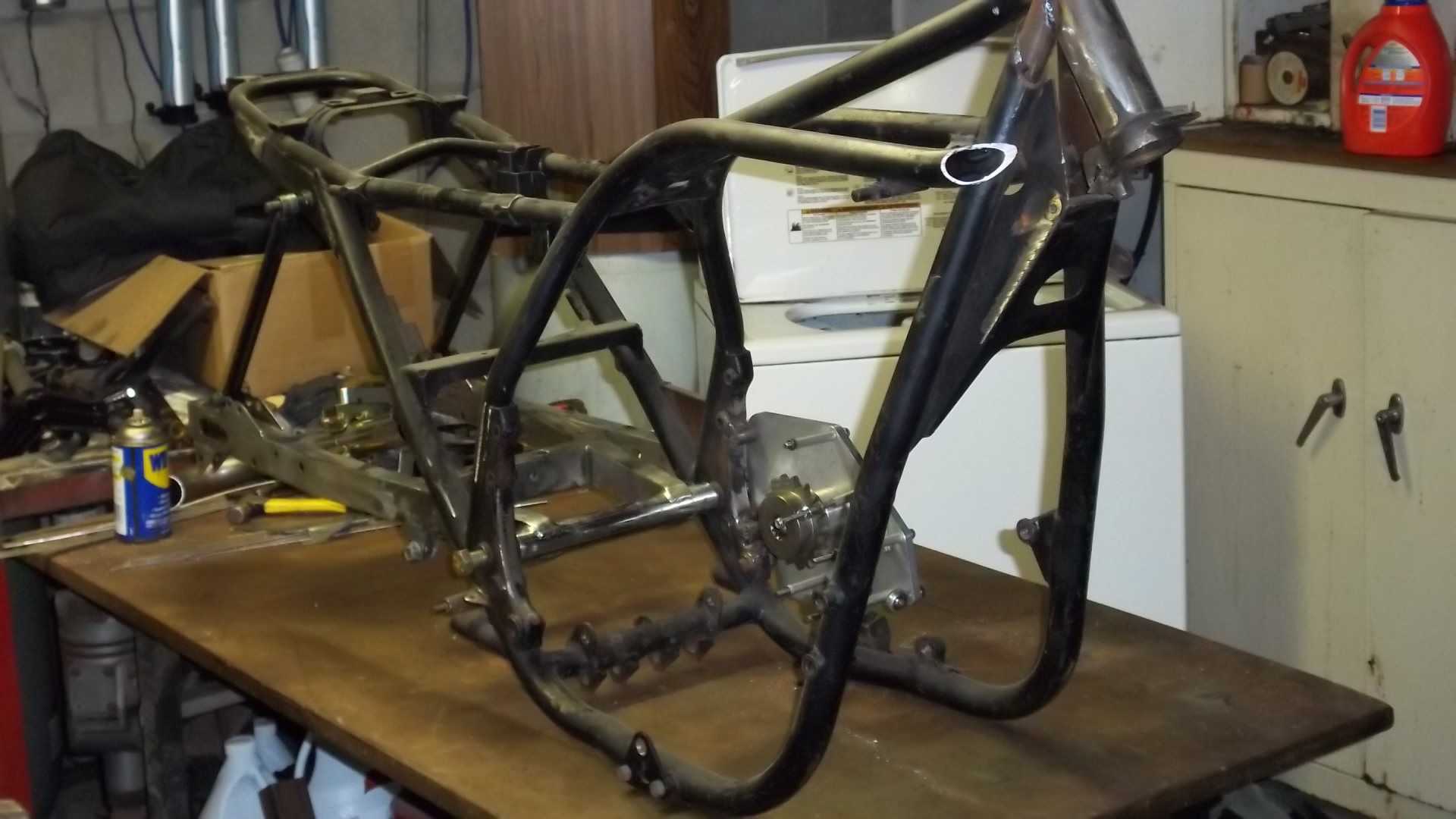

No matter what, you need some fabrication work. PBI has great sprockets. Anyone who makes the flat plates, will do.
This is a 5/8" offset. Had to weld to the frame, (KZ900)

You know far more than I do about Kz's....but is that not a bit over kill for a street bike? I could see going to that extend for a drag bike, but it seems as though a lot of people are using the 5/8's offset without too much additional work...?
