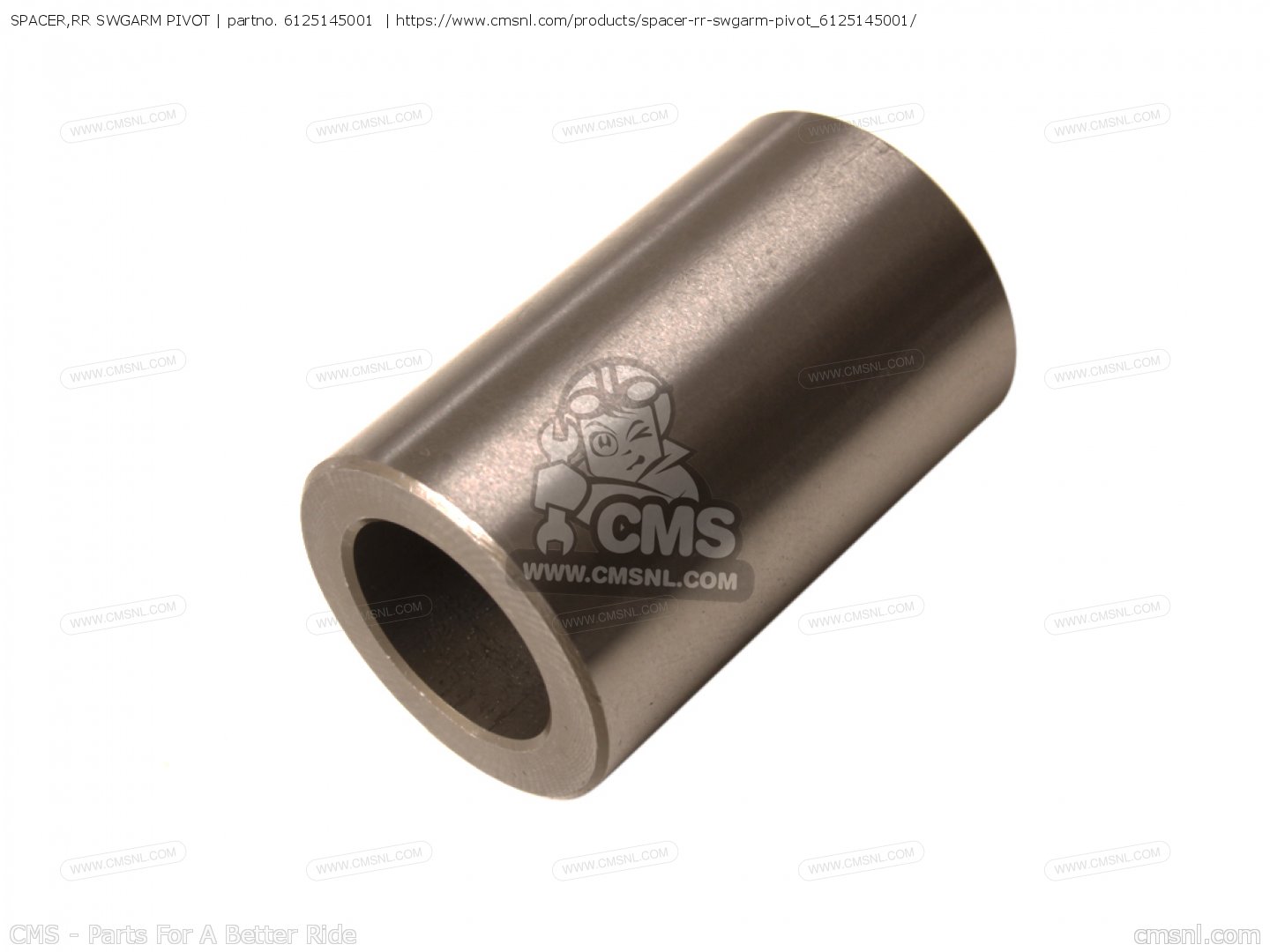

Your swing arm sleeve ID = 14 mm / OD = 22 mm
This Suzuki sleeve has the same ID/OD, 2 x € 10.50
www.cmsnl.com/suzuki-gs550e-1981-x-e01-e...145001/#.XESdRrmWw_w
Shorten your old grooved sleeve parts on both sides on a lathe by the lenght of the new Susuki sleeves
Your old sleeve work like an spacer between the new sleeves.
Happy wrenching

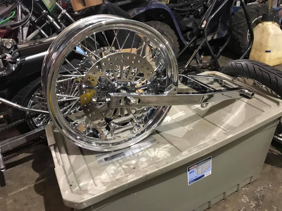

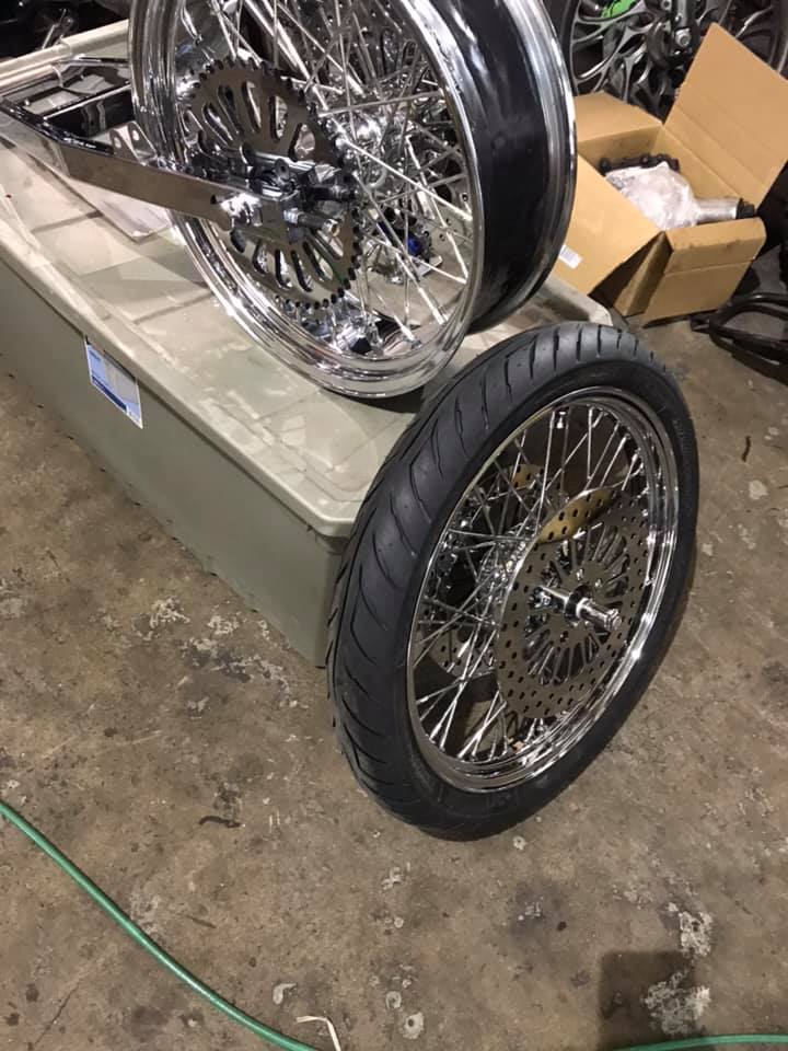

I'm picking up? Your not in the USA? Wider rear you need wider swingarm. The GS1100 Suki is a good swap. will handle 160 / 180 if pulled back on chain adjusters.
Plus an offset sprocket.
But Cheap parts! Believe it or not Harley! 18" x 5" x 180 wide wheel with 530 chain size which would help with clearance. disc brake, which you have.
I built this about 6 yrs ago when I lived in a different house. Sold it out of State.
Nothing like a wide wheel on an old Kaw

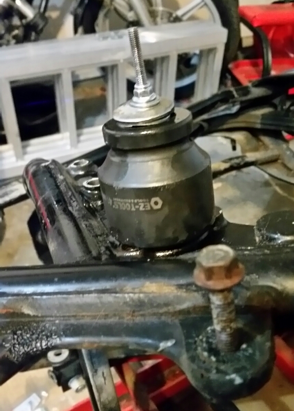

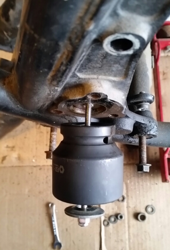

Pulling everything off frame was straightforward enough, except for the swing arm bushings. The service manual's instructions to thread a bolt into the bushing and pull were not effective so I must turn to the collective wisdom of the internet to provide inspiration on how to solve my problem.
Most of the solutions I found involved fastening some manner of a slide hammer and pounding the bushings out. Folks mostly seemed to have used vise grips to build a slide hammer or drilled and tapped the bushing to match a slide hammer they already possessed.
Having reviewed other's solutions to my problem, I needed to identify a course of action which was both expedient and (more importantly) cheap. Time to soak the bushings in liquid wrench while I ponder.
Since I do not posses a slide hammer and am not fond of drilling out the bushing to 5/8-18 to accommodate a rental slide hammer, I decided I shall fashion one myself. Seems simple enough, a slide hammer consists of a threaded rod, a large mass, and a stopper.
Voila!
A few bucks of hardware later I have my slide hammer and am feeling pretty proud of myself. A M5x0.8 threaded rod, the heaviest impact socket I've got, a couple washers and a flanged nut.
After applying some heat to the frame around the bushing and a far bit of persistence, this setup actually worked. But only on one side. The right side bushing was more stubborn and required a different solution.
Inspiration struck and I rotated the impact socket around and used the tool like a flywheel puller, tightening the nut with an 8mm wrench.
The little threaded rod held up and the bushing finally came out.
Time for a celebratory beer!
