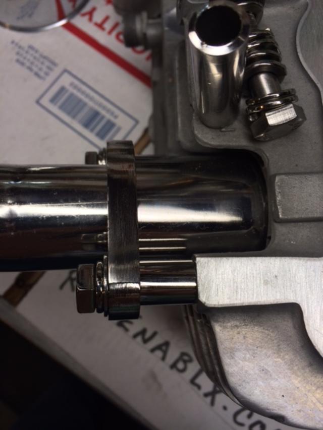

Just reaching out to see the general opinion of using stainless exhaust studs. I know that stainless screwed into aluminum doesn't play well together. That's where the locktite comes in. Should I use the traditional plated or are the stainless studs hard enough for use? I want EVERYTHING to be "purdy" Im using a Delkevic front section pipe and these things are beautiful stainless. I cant use the back/muffler cause of my 300 swingarm. Tom

21 Jan 2019 16:42tomsbadkz wrote: I know that stainless screwed into aluminum doesn't play well together. That's where the locktite comes in. Should I use the traditional plated or are the stainless studs hard enough for use? Tom
You are talking about galvanic corrosion.
Be careful not to get any galling on the threads of stainless steel hardware.
They will seize and then the fun begins. I would use anti-seize instead of locktite.
