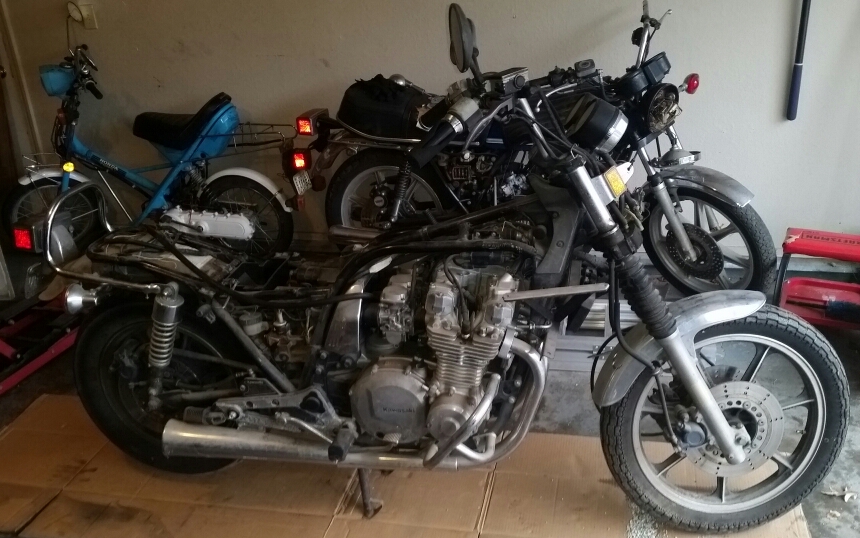

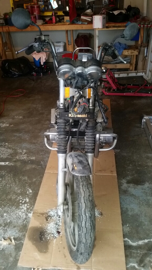

After flipping a KZ1000 Police bike and gifting a 77 RD400 to my father in law, I had this big gaping hole in my garage that I needed to fill. So it worked out great that Rich was looking to part with his 83 KZ1100ltd.
Drove a good 2-3 hours to pick up the bike along with a mountain of parts, Vetter fairings, and hard bags. Somehow, with the help of Rich and his son, we got the bike and all the parts into the truck. Everything rode well enough back home and now there be no more hole in the garage. Problem solved!
Looking to keep this one close to stock and just give it a complete refresh: powder coat the frame, new bearings all around, rebuild the forks, master cylinders, etc... This is my first full teardown and rebuild but I'm confident I won't screw things up too bad!

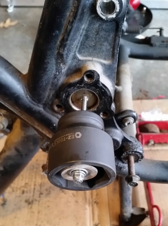

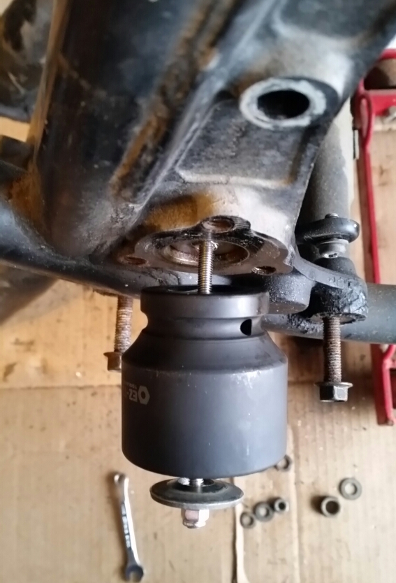

Pulling everything off frame was straightforward enough, except for the swing arm bushings. The service manual's instructions to thread a bolt into the bushing and pull were not effective so I must turn to the collective wisdom of the internet to provide inspiration on how to solve my problem.
Most of the solutions I found involved fastening some manner of a slide hammer and pounding the bushings out. Folks mostly seemed to have used vise grips to build a slide hammer or drilled and tapped the bushing to match a slide hammer they already possessed.
Having reviewed other's solutions to my problem, I needed to identify a course of action which was both expedient and (more importantly) cheap. Time to soak the bushings in liquid wrench while I ponder.
Since I do not posses a slide hammer and am not fond of drilling out the bushing to 5/8-18 to accommodate a rental slide hammer, I decided I shall fashion one myself. Seems simple enough, a slide hammer consists of a threaded rod, a large mass, and a stopper.
Voila!
A few bucks of hardware later I have my slide hammer and am feeling pretty proud of myself. A M5x0.8 threaded rod, the heaviest impact socket I've got, a couple washers and a flanged nut.
After applying some heat to the frame around the bushing and a far bit of persistence, this setup actually worked. But only on one side. The right side bushing was more stubborn and required a different solution.

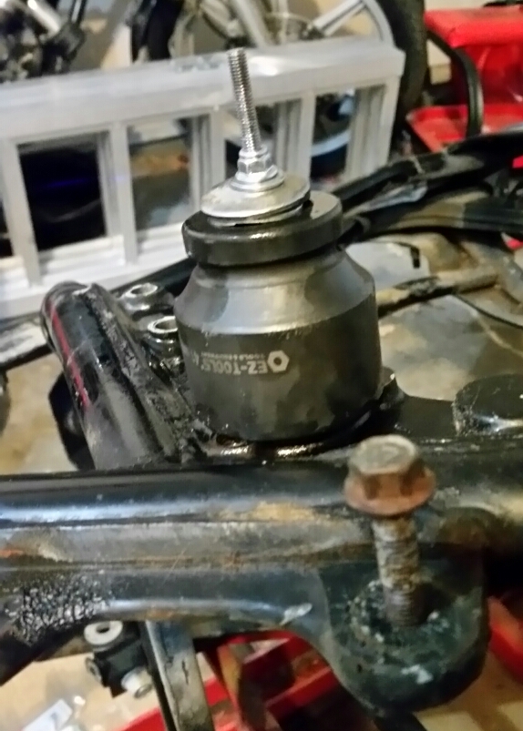

Inspiration struck and I rotated the impact socket around and used the tool like a flywheel puller, tightening the nut with an 8mm wrench.
The little threaded rod held up and the bushing finally came out.
