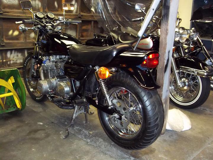

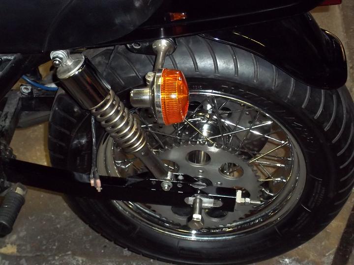

I'm picking up? Your not in the USA? Wider rear you need wider swingarm. The GS1100 Suki is a good swap. will handle 160 / 180 if pulled back on chain adjusters.
Plus an offset sprocket.
But Cheap parts! Believe it or not Harley! 18" x 5" x 180 wide wheel with 530 chain size which would help with clearance. disc brake, which you have.
I built this about 6 yrs ago when I lived in a different house. Sold it out of State.
Nothing like a wide wheel on an old Kaw

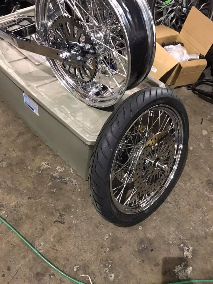

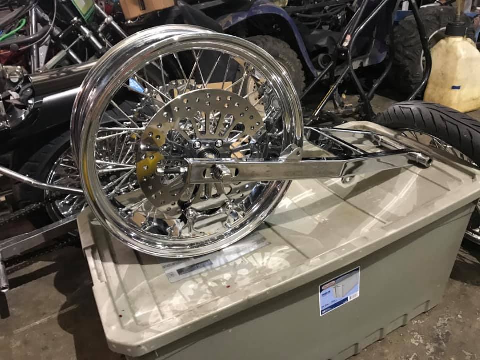

No eBay APP ID and/or Cert ID defined in Kunena configuration18" disc hubs are hard to find for the KZ1000, only made them 2 years 77-78.
Find a hub, Buchanan spokes sells all the spokes you want 16" OR 18"
And rim rings.
Or if your financially loaded? $5,000 can but this set up! both wheels and swingarm, discs etc. it's on a FB site.
This guy uses Harley hubs, 5 hole pattern, same as disc side.
www.facebook.com/jrspeedracing/posts/10156922415859036

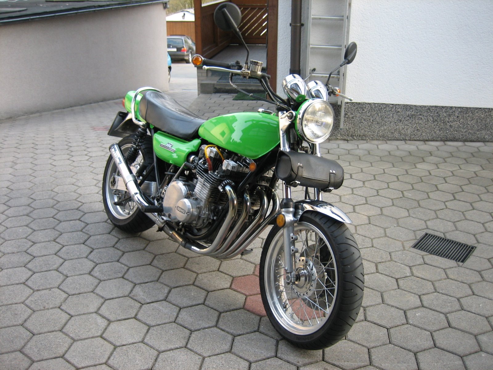

700 Dollar for a single rim, insane!!!
I think about i could sale my both AKRONT wheels (5.75 x 18 /3.50 x 18) for 700 Euro.
I have to resit to thought about it.....
Some pics of my bike more than 10 years old...

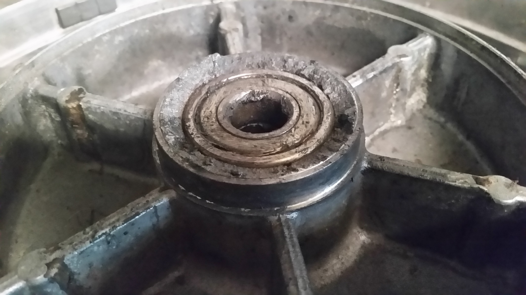

I found and bought a rear spoke rim off flea bay for $150. $90.00 +shipping and got screwed. The hub where the bearing is is broken off.
