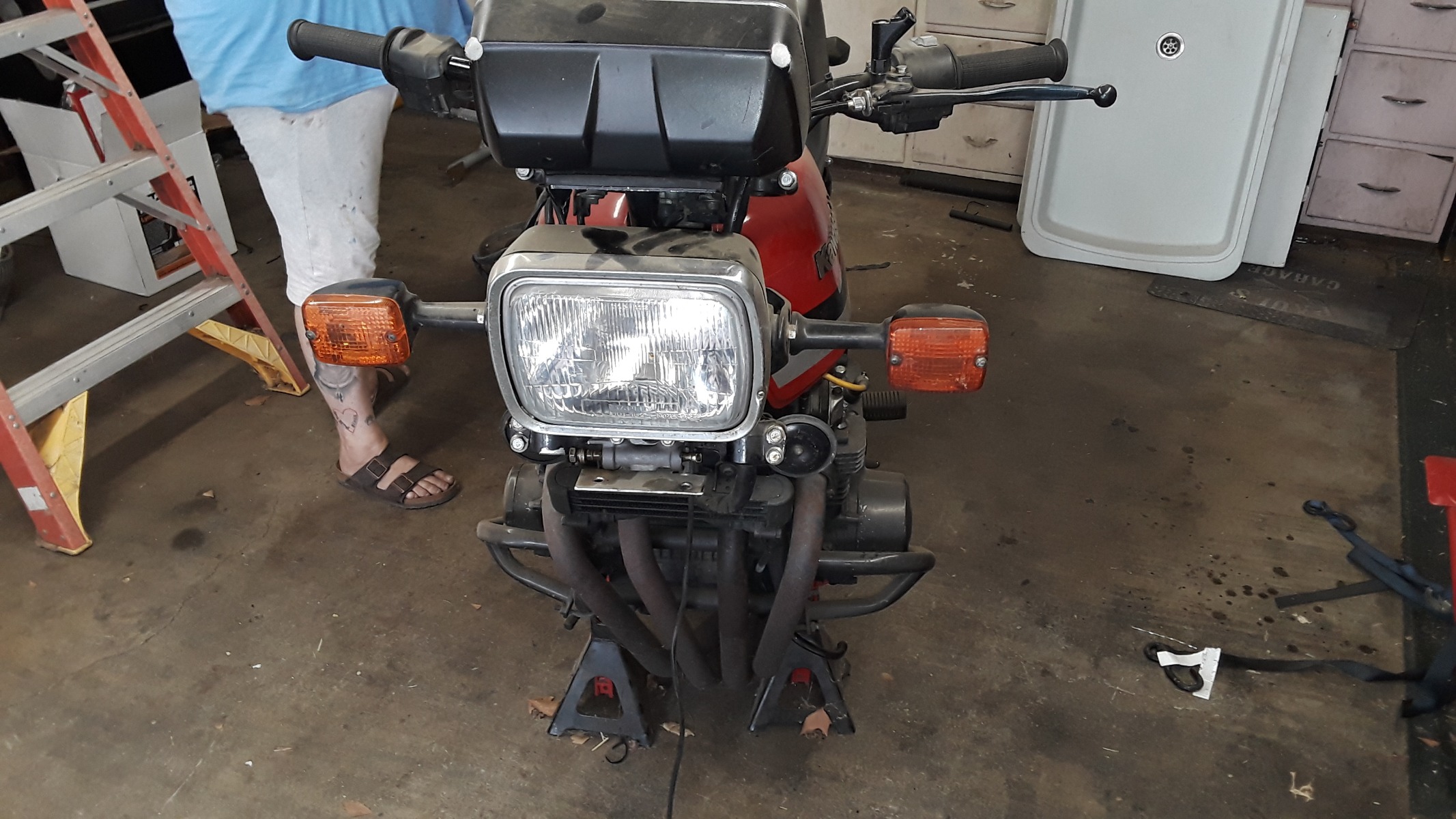

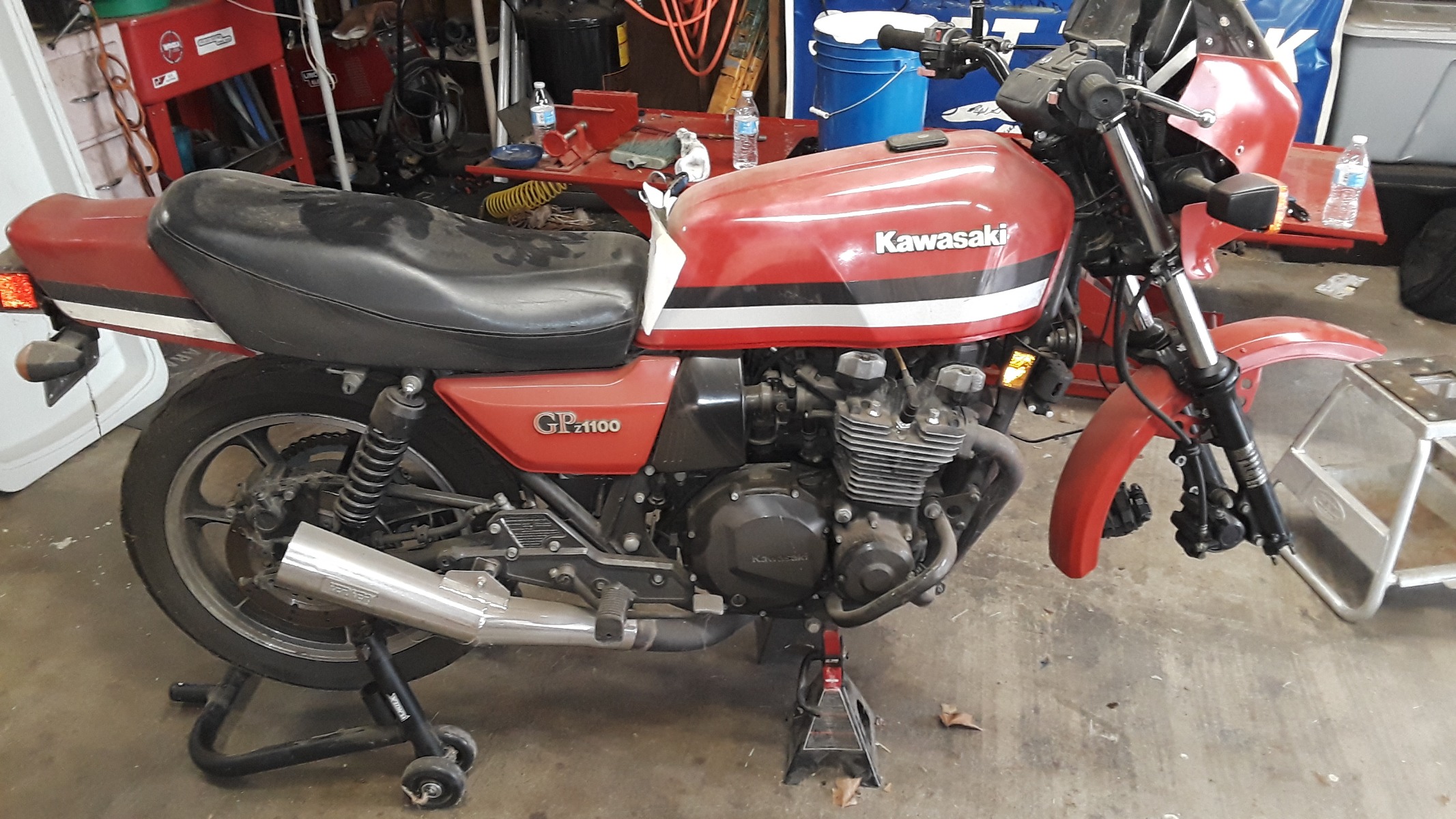

Fellas, I just wrapped up the upgrade on my Suzuki, well, almost... and so the lift was clear for the first time in a long time. My wife has always ridden & owned her own motorcycles & her big GPz is next up on the lift. Plans include a Suzuki aluminum GS1100 swingarm conversion, fresh brakes & maybe a fork swap as well... we'll see how it goes & what SHE wants!
Wow. Somehow doubled up on pictures... you'd think I had done this before :blush:
So the entire front end has been removed & the front brakes disassembled... What a mess. The fronts were horrible! Z1 to the rescue! pads & stainless lines in the basket.
As my credit card is still smoldering after upgrading the GS, This one will likely be spring before completion.

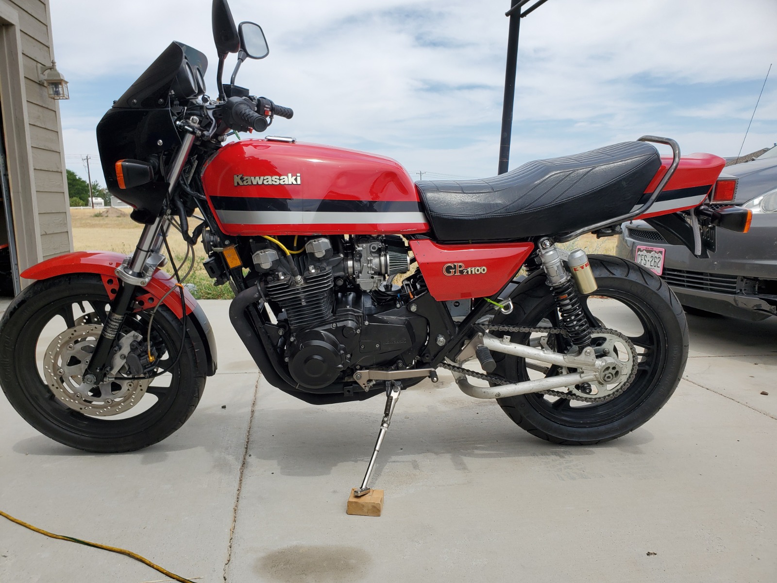

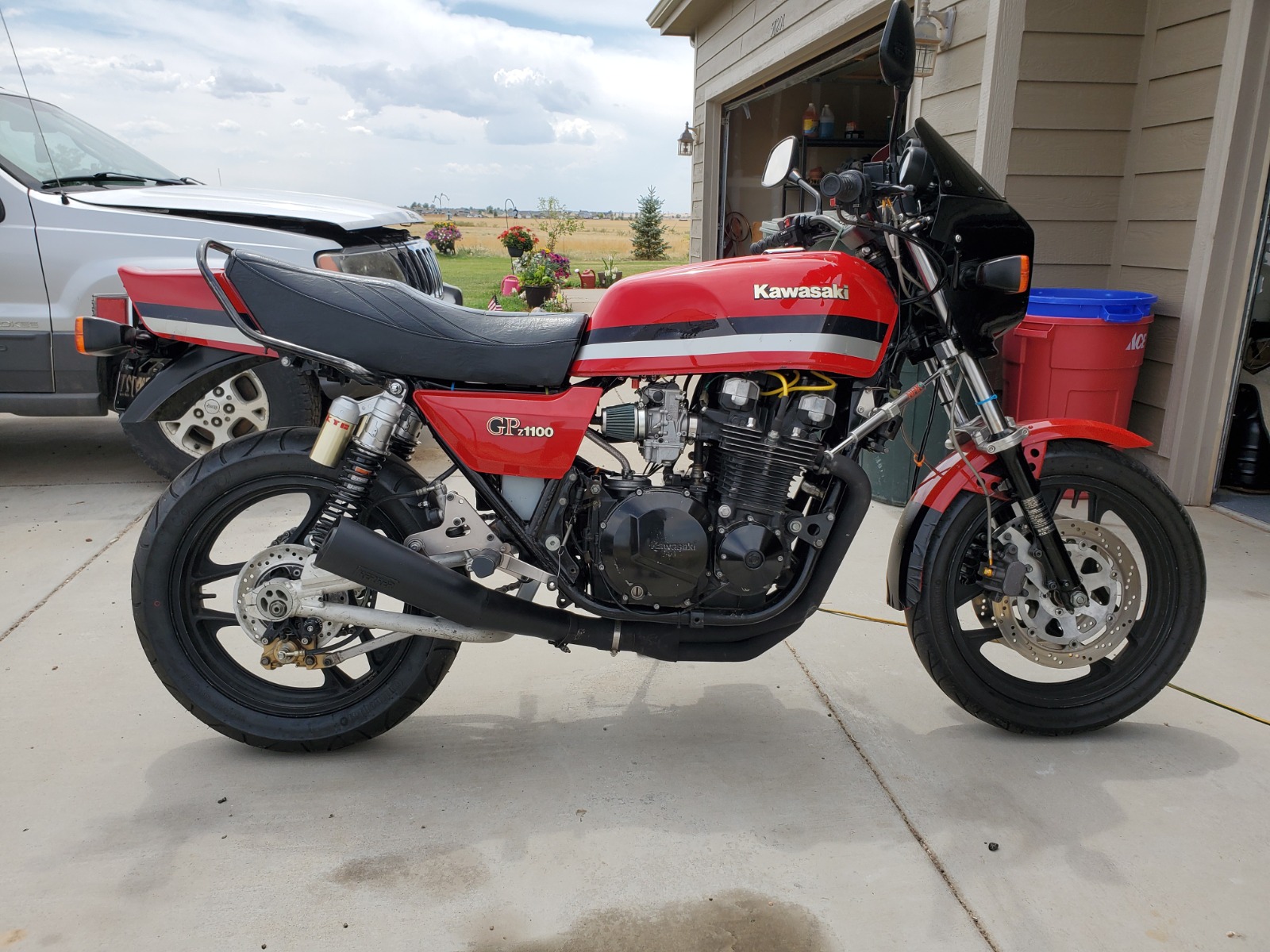

Ride report and update..
So I now have a full summer of riding on the GPZ1100 with suspension upgrades...wow what a difference! I LOVE riding this bike! I used it to commute to
work about 70% of time this summer, and have put at least 5000 miles on it. I ride 600 miles a week commuting, about 60 miles one way on back country roads.
Needless to say I really let're eat on some sections....rock ass solid at 100+ no problems. No slappers, wobbles, pogoing...nothing just stable as can be. Power is wonderful now that I have the Mikuni RS34's dialed in as well. It will pull redline in every gear...roll on is massive no need to downshift. It easily is making the same power as my ZRX1100.
Here is what my current suspension mods are sitting at:
1. ZRX1100 rear swingarm with 20mm through bolt (zrx1100 rear axle) upgrade, hole reamed slightly tight for zero slop per Dr. Gamma advice.
2. 1986 GSXR1100 front and rear wheels, for a 4.0 inch rear with a 150 mounted and a 2.75 front with a 110 mounted.
3. Critical step here..front and rear wheels perfectly aligned < than a 1mm off. They were at least 1 cm off when I first checked it! This is key to fixing slappers.
4. NHK high end steering dampener.
5. S1 style lower triple clamp from Motogp. Stiffened the forks.
6. ZRX1100 rear shocks overhauled by DMR Jamie Daughtery << great guy.
7. Installed RaceTek Cartridge emulators both forks with O rings for a tight fit..1.5 clicks in. per side.
8. RaceTek fork springs.
9. Critical point here, multiple weeks testing the perfect fork oil mixture for this setup. For me 20ml ATF with seal conditioner, 30ml 75-120w synthetic gear oil (for rebound), then the remaining 10-30w synthetic motor oil. Also 10psi air per fork. For more rebound add the gear oil in 10ml increments. Caution this only works in ancient NON cartridge forks. I use this same basic formula in my RZ350 also...works perfect.
10. Change the fork oil often, dirt and grit contaminate it causing leaking seals. I found a way to change the GPZ1100 fork oil in about 15 minutes. I use a an old Hyperlube bottle which as a cone sprout. It fits perfectly into the air valve hole (remove the valve) and I have pre measured the oil and just let drain in. cap it and use a bicycle hand pump to put 10psi in per side. ..and Bobs your uncle.
11.Lasty, a Fork Brace.
Before modifying the forks like above, they were worthless...bottomed on braking, zero dampening down right dangerous. Now, they work like modern forks, fork travel is around 3.5 to 4 inches max..no bottoming, no diving on hard braking, and great rebound dampening. They are far less harsh than my ZRX, that just beats me to death. I can go over a real bumpy patched road surface at speed 90+ and it just floats over it...never gets upset. I tried Dr. Gamma's trick of slapping the bars ar speed to try and induce wobbles and nothing...I did this at about 65mph...not 90 like he does..not that brave..
