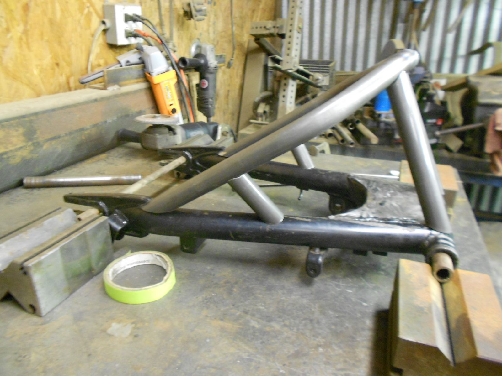

All right, lots of pics, so probable will have to break this up. First, things first.
Mark,
Yes it appears it is a 12mm threaded nut. As you can see, it is about .810" deep. It threads onto the stock KZ shock mount per the picture. It is also an allen drive for use.
Bob,
I know you were asking about some dimensional information for the ZRX swing arm. I have both the 1100 and 1200. All dimensions are center to center and in a straight, most direct line.
ZRX1100: Swing Arm Pivot to Lower Shock Mount Bolt: 17.25" / Lower Shock Mount Bolt to the Center of the Essentric locking bolt: 5.50" / Swing Arm Pivot to Upper Shock Mount Bolt: 15.875"
ZRX1200: Swing Arm Pivot to Lower Shock Mount Bolt: 16.75" / Lower Shock Mount Bolt to the Center of the Essentric locking bolt: 6.50" / Swing Arm Pivot to Upper Shock Mount Bolt: 18.25" (on a KZ)
So that should take care of those questions...
Now for the fabrication... I started with welding the upper shock mounts. I tried to match the slope of the stock ZRX, but had to go a little further leaned over due to clearing the factory frame gusset. I made a jig to reference off of the stock KZ shock mount and used a machinist square to ensure it was parallel to the frame tube.
Then started with the lower frame gussets and worked around the bike. The only issue I had with the LH side #7 frame gusset. Pretty sure it will interfere with the seat lock. Next weekend will finish up with installing the oil cooler, steering damper and clearance that gusset if needed.
The finished (for the weekend...) product.
Cory
Mark,
Bob,
Cory
