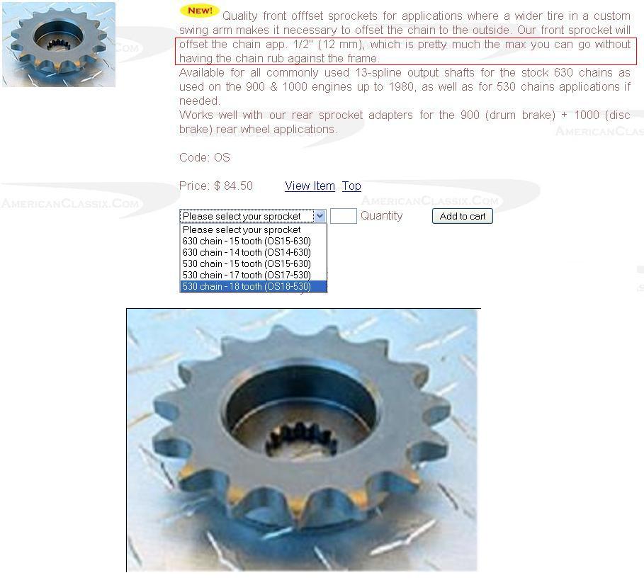

Replied by SBK Racer on topic How to figure proper amount of offset on sprockets
15 Jan 2013 16:47 - 15 Jan 2013 17:38
You can not just guess or wing it... You need to take accurate measurements...
First the rear wheel must be centered on the bike... Changing the swing arm complicates things... You can not just eye ball it...
From there you measure the distance from the center of the wheel to rear sprocket mounting surface... You compare this number to the OEM rear wheel distance from the center of the wheel to rear sprocket mounting surface...
The difference is the amount of offset you need...
You can move the rear sprocket in towards the center of the wheel a little... You can machine the hub/sprocket carrier spacer a couple millimeters... You can also remove the studs and machine the hub/sprocket carrier a couple millimeters... The limit is when the tire rubs on the chain... (On the 2006-09 GSXR 600/750 the limit is 5 millimeters.)
From there the counter shaft sprocket can be offset out...
If it comes to close to the frame, I think bracing outside of the frame and trimming the inside of the frame, is a better option than offsetting the center of the rear wheel just to make it work...
Right?
Luis
