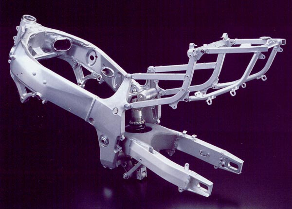

what kind of work would i have to do for the gsxr arms with mono shocks?
Replied by 531blackbanshee on topic 1978 KZ1000 a2 swingarm swap
06 Sep 2013 11:41
808rob
97-03 gsxr 600 arm has no upper brace.
92 gsxr 1100 arm no upper brace.
you wannna go dual shock or mono?
