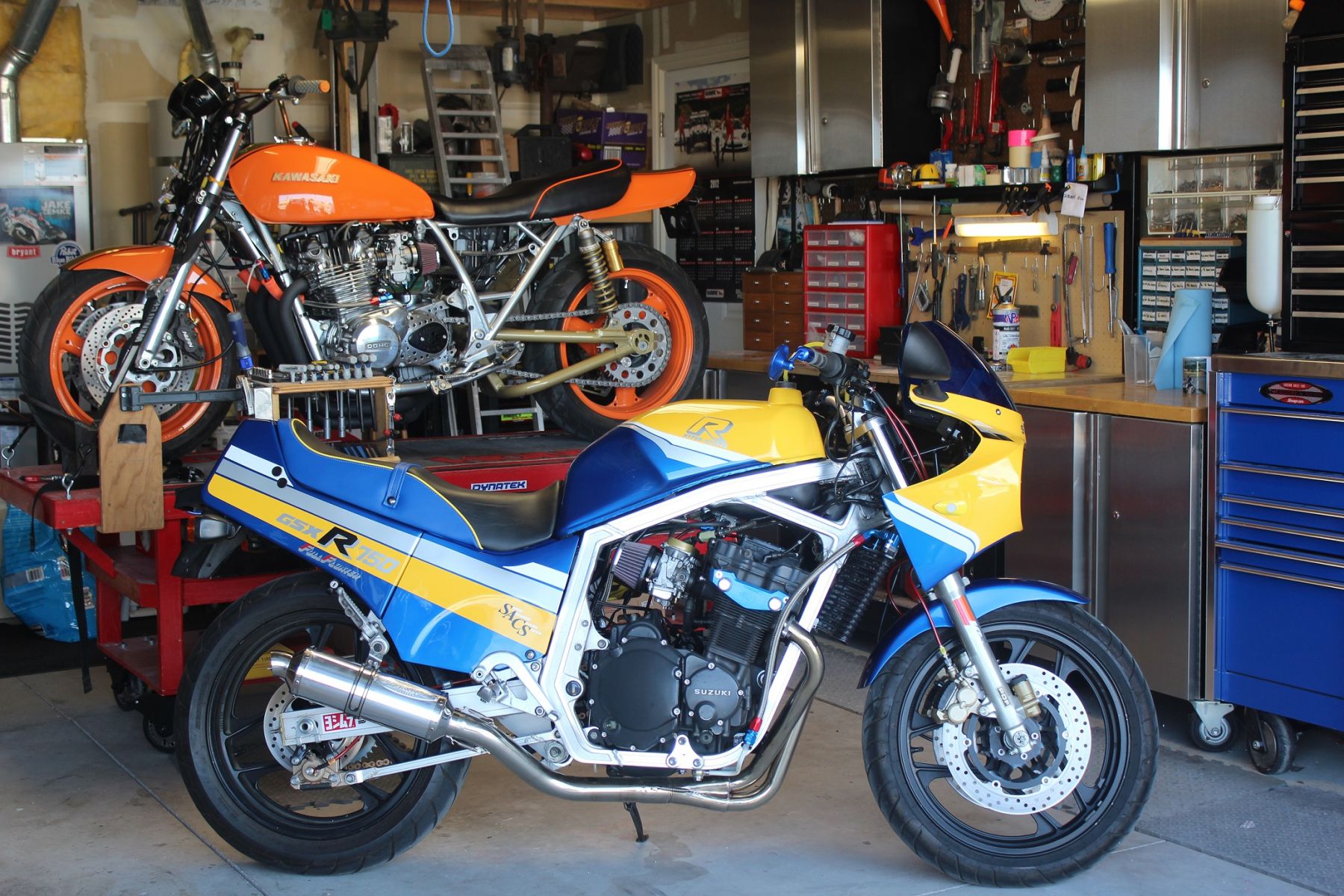

25 Aug 2014 04:31spdygon wrote: thanks........ill chave to check if the bottom part is the same as the 93 gsxr
Another option is www.motionpro.com . Just tell them what ends it needs on it and what length and they will make the customer cable for you. Not much cost difference vs. a standarded cable.
As always, a beautiful, well thought out bike!
Cory

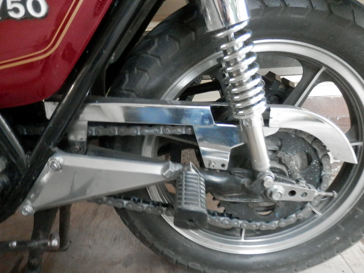

24 Aug 2014 21:54Replied by JR on topic Will Chain Guard from 750H (LTD) fit 750E (1981)
24 Aug 2014 17:22
It should - no guarantees though - but may need a little work with a dremel type tool.
I picked up the chain guard in the photo below at a recycling yard a long time ago and am almost certain it came from an LTD. I needed to enlarge the cutout a little to fit the original rear shocks which have since been replaced. The chain guard has holes for 3 bolts but the swing arm on my 1980 E1 has fittings to accept only 2 bolts.
At the time I just needed to make the bike street legal.
Good luck
