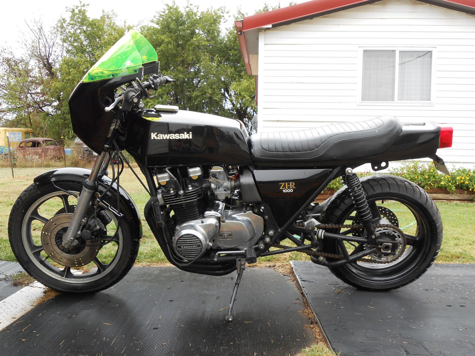

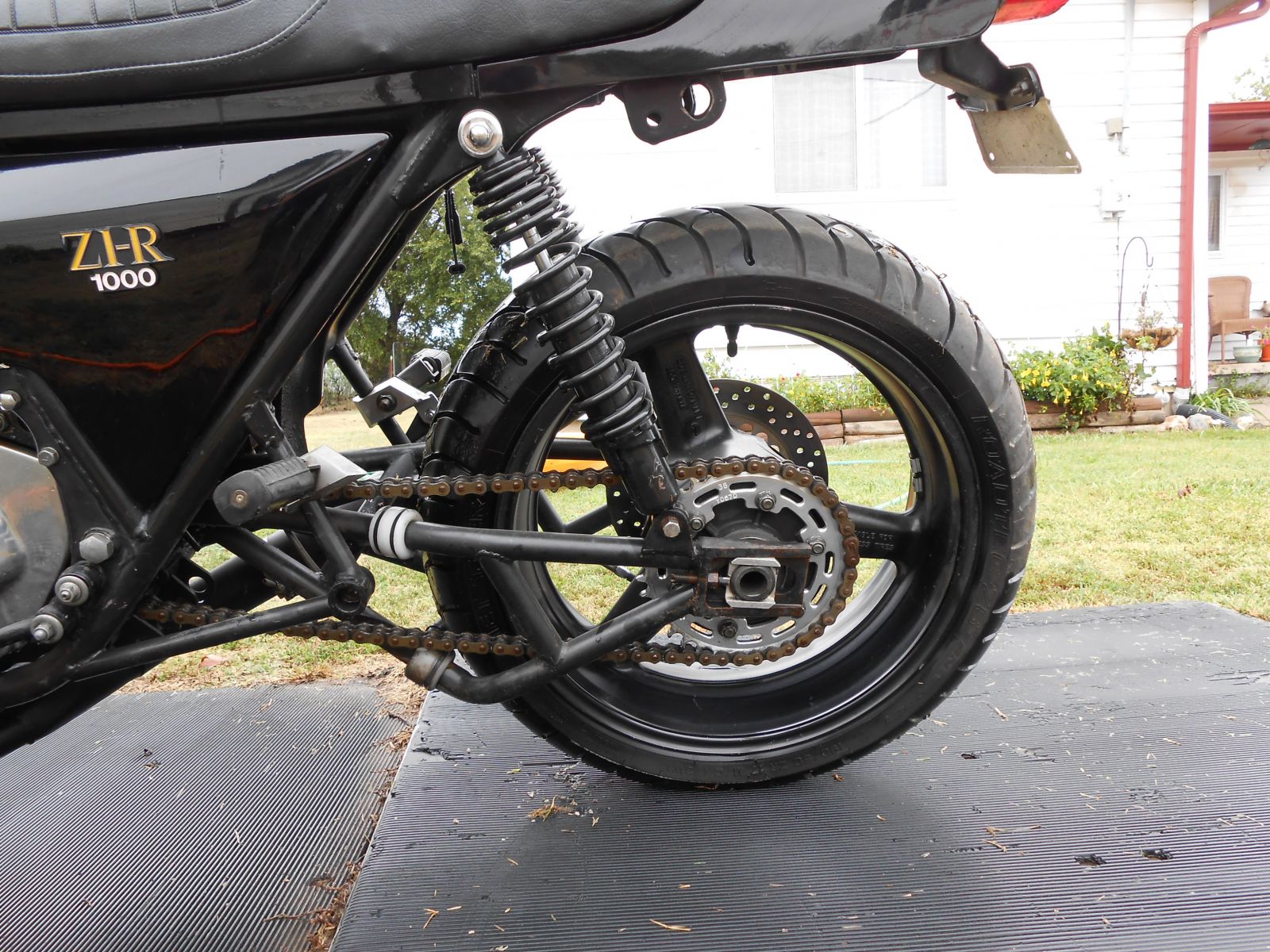

Replied by davido on topic Front end swing arm and new wheels and tires
29 Apr 2015 11:46 - 29 Apr 2015 11:50
This is the CSR1000 Im busy with at the minute.
From what I understand the CSR is pretty close to the LTD. Anyway,Its got a ZX9R front end complete(a stem press was all it took).Back end is a GSXR600 swinger(straight in with a couple of washers,Shock mounts welded on, Chain tensioner adapters made to fit the smaller diameter axle)
and a Bandit 600 back wheel (160 tyre,sprocket carrier turned down to bring the chain in a bit to clear the frame and tyre) Itll also need an offset front sprocket but I havent got that far yet.
It took a lot of head scratching, 3 rear wheels and many hours on the interweb to get to this stage. I wish I had been around earlier to post a list of the parts I would need and the work I would have to do to make it all fit!!
My only doubt is ground clearence.I still havent decided on an exhaust yet and as you can see the engine isnt in the frame yet. So,.I cant say.Time will tell.
Good luck with yours
