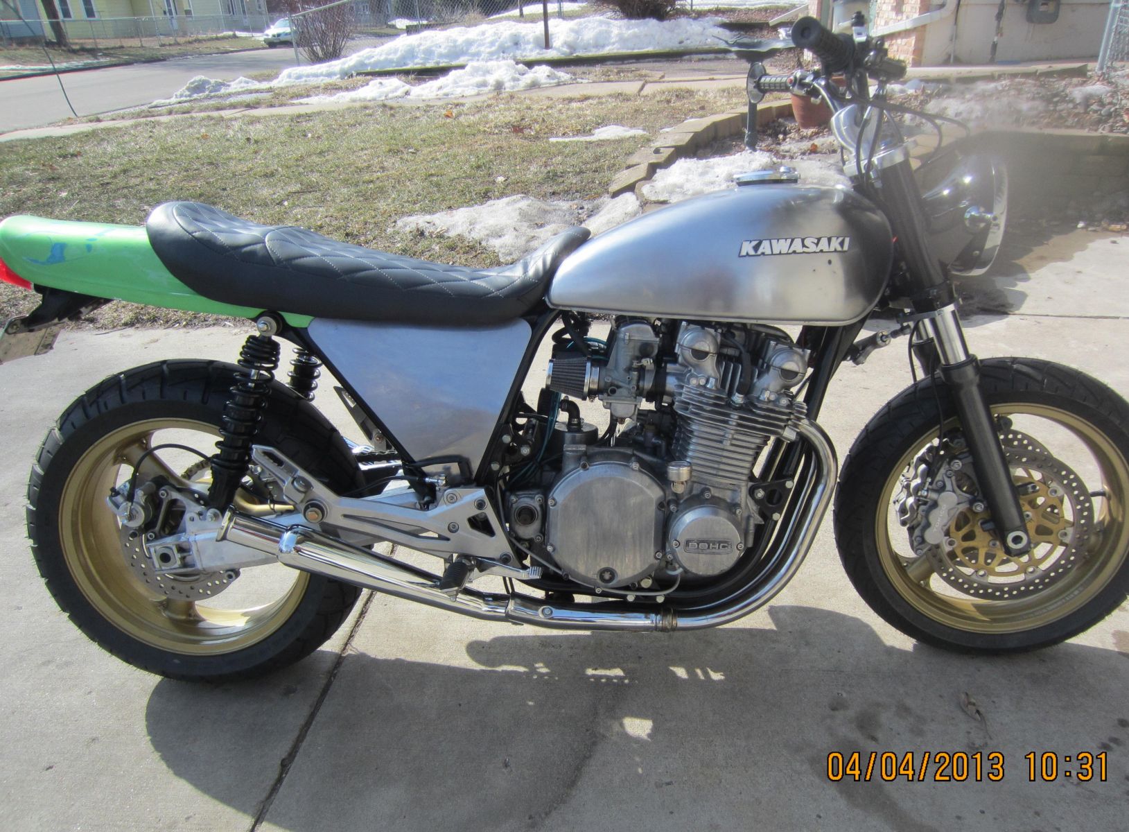

Black Beard and I are beginning a project with an LTD 1000. We would like to exchange the front end ( forks, front wheel and tire, swing arm and rear wheel and tire with a newer bike. As far as the rear wheel and tire we are looking to put a wider tire so we would greatly appreciate any input on compatible components we could use.

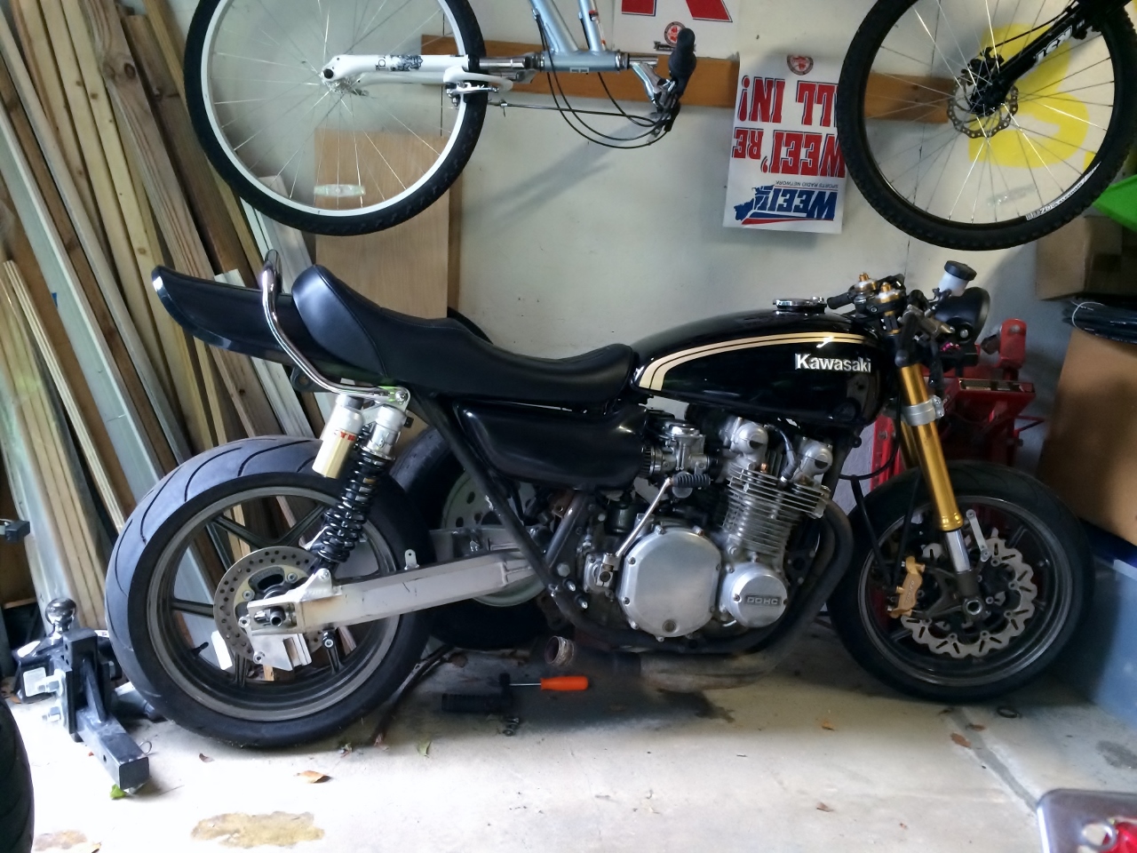

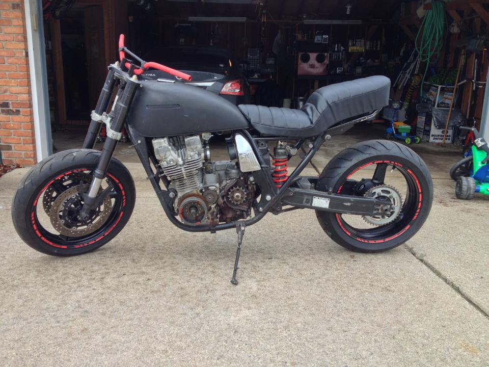

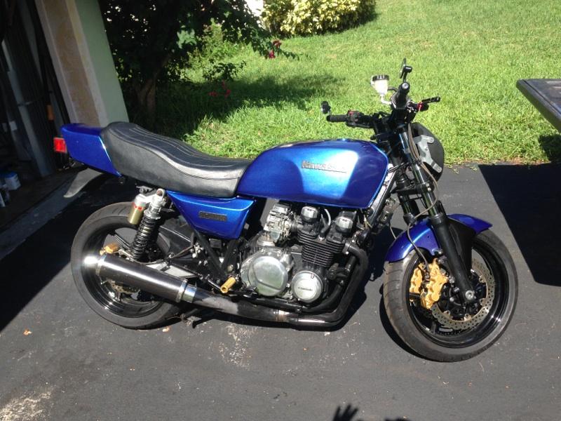

zx636 arm and front end
04/05fz1 arm 07 r6 wheel
r1 front end fz1 arm
zx636 arm
zx636 arm
heres a few,

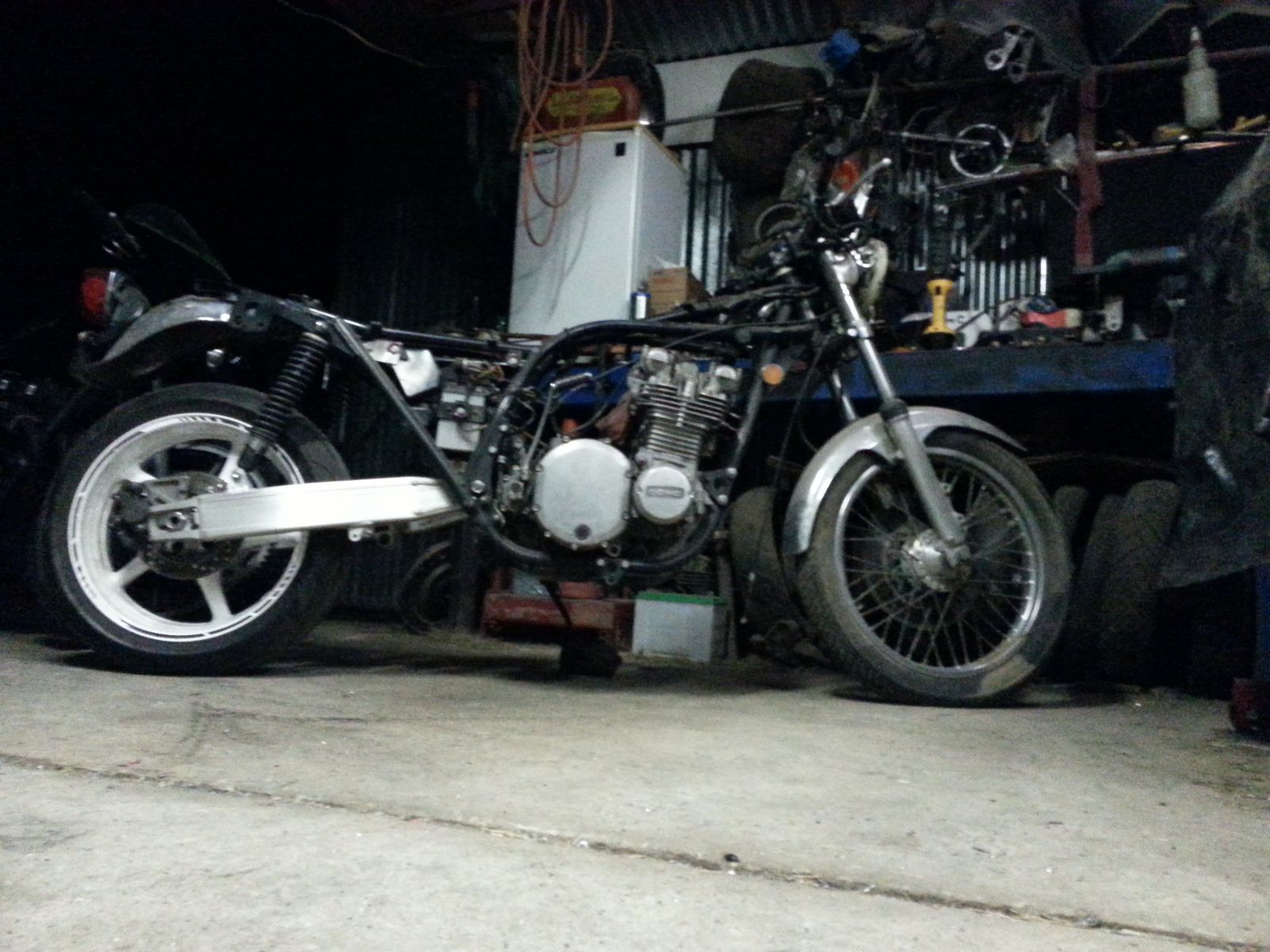

This is the CSR1000 Im busy with at the minute.
From what I understand the CSR is pretty close to the LTD. Anyway,Its got a ZX9R front end complete(a stem press was all it took).Back end is a GSXR600 swinger(straight in with a couple of washers,Shock mounts welded on, Chain tensioner adapters made to fit the smaller diameter axle)
and a Bandit 600 back wheel (160 tyre,sprocket carrier turned down to bring the chain in a bit to clear the frame and tyre) Itll also need an offset front sprocket but I havent got that far yet.
It took a lot of head scratching, 3 rear wheels and many hours on the interweb to get to this stage. I wish I had been around earlier to post a list of the parts I would need and the work I would have to do to make it all fit!!
My only doubt is ground clearence.I still havent decided on an exhaust yet and as you can see the engine isnt in the frame yet. So,.I cant say.Time will tell.

03/04 zx636
then it needs the pivot machined narrower and modified to fit the kz pivot bolt.
and,
shock brackets if your gonna run dual shocks.

BlackBeard said the same thing about modifying it, What I'm trying to accomplish is to have the back end of the bike sit up higher and have the ability to place a wider back tire on the bike. is this possible with stock parts?

Another thought is could I adjust the existing forks and have the front of the bike sit lower?
