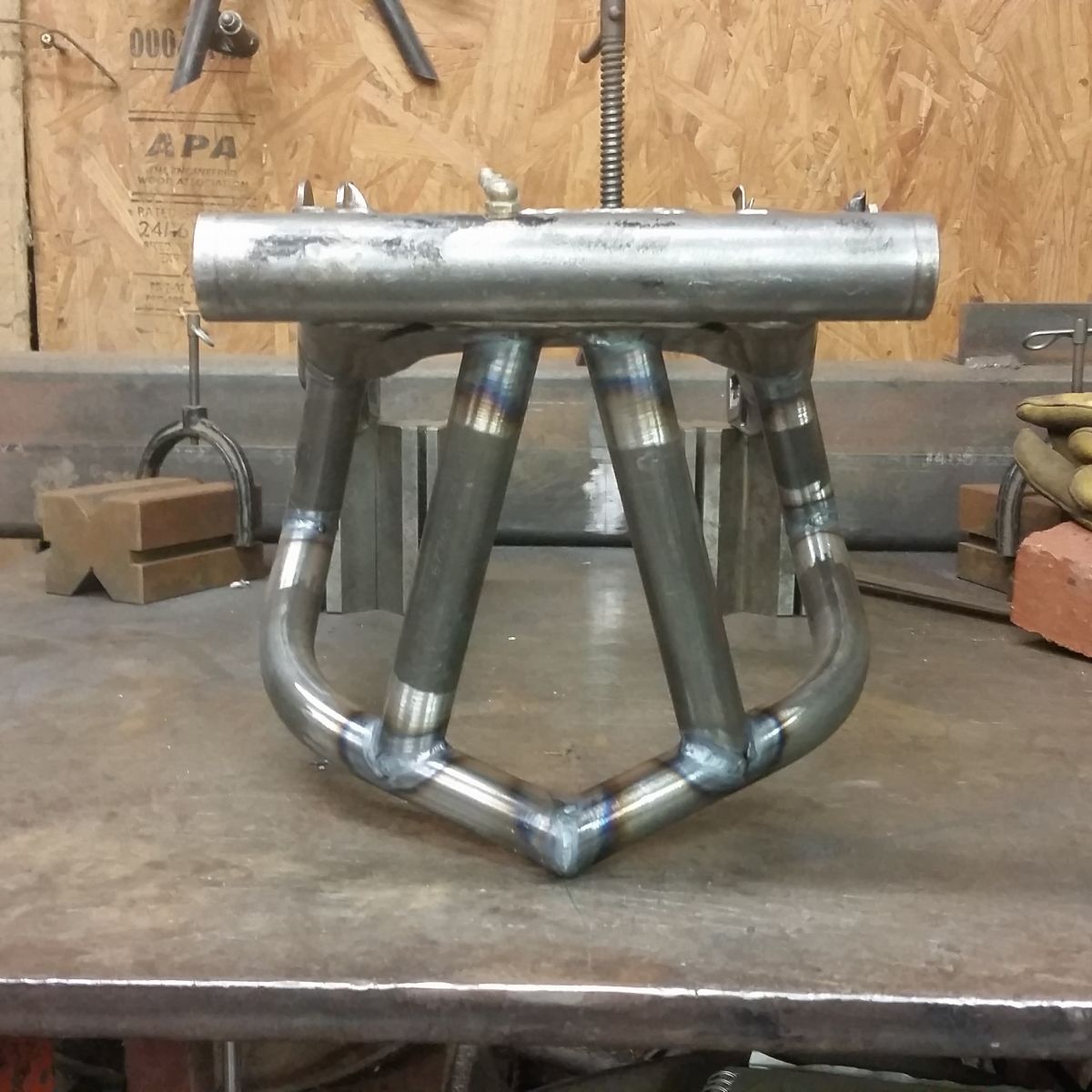

Replied by 531blackbanshee on topic Kawasaki vs Suzuki frames.
20 Nov 2015 04:30 - 20 Nov 2015 04:44redhawk4 wrote: I don't know about the swing arms, I guess changing one for a stronger aftermarket one would answer that particular question.
a braced stock arm can make a huge difference when you are pushing one.
here are a few i've done.
when it was time to address my own 80 z1r's handling i went with a 17x6 inch wide rim with a 190mm wide tire :whistle: .
it's overkill.but rock solid in the corners with no added frame bracing.
i'm sure a good 160 series tire would hold one of these bikes juts fine.
what i'm saying is a good strong arm can go along ways to taming one of these old beasts :evil:
p.s.
looks like some folks think the uki steel arm could use a lil help to.
only added a lil bracing to the frame tho.
