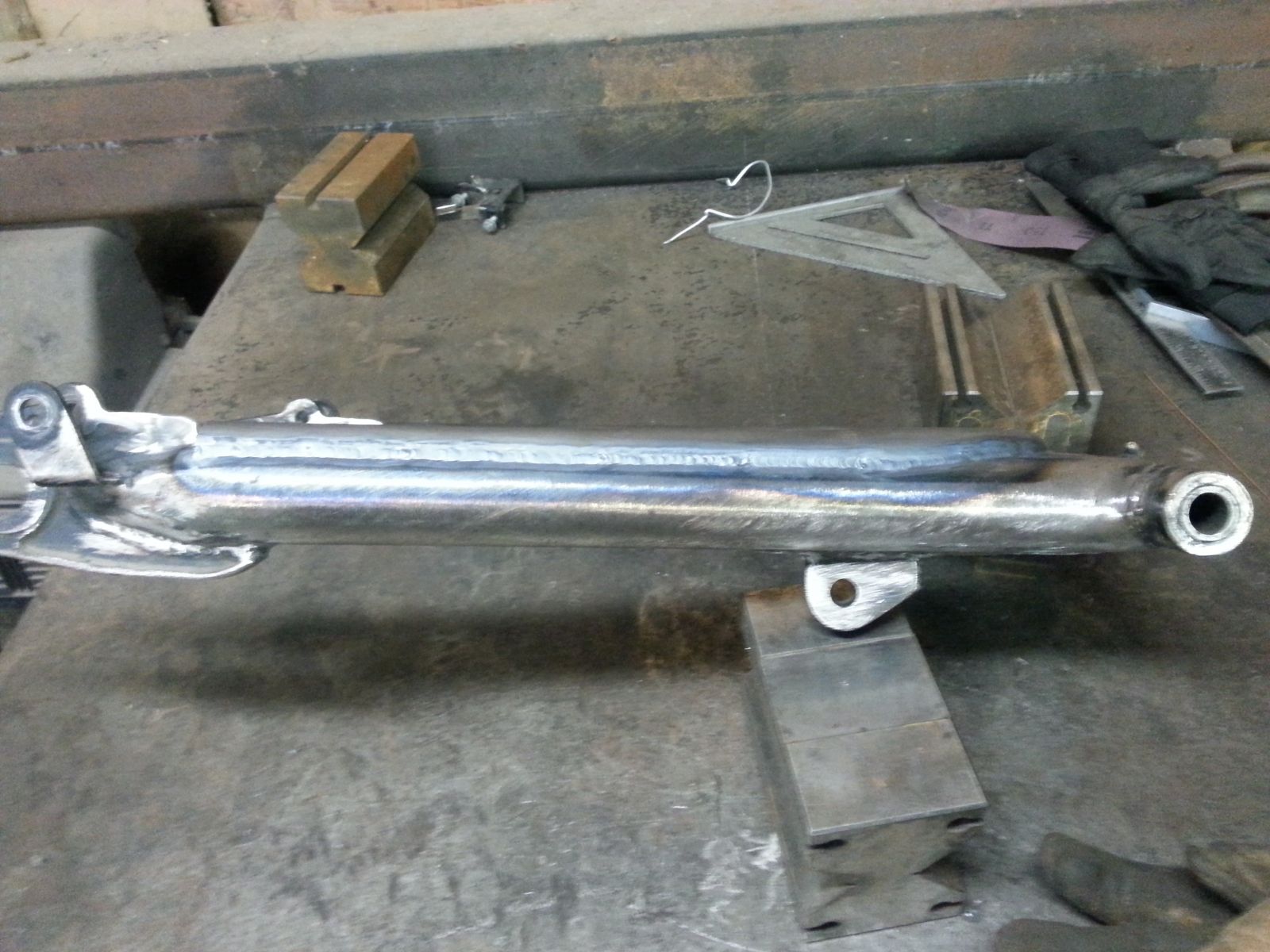

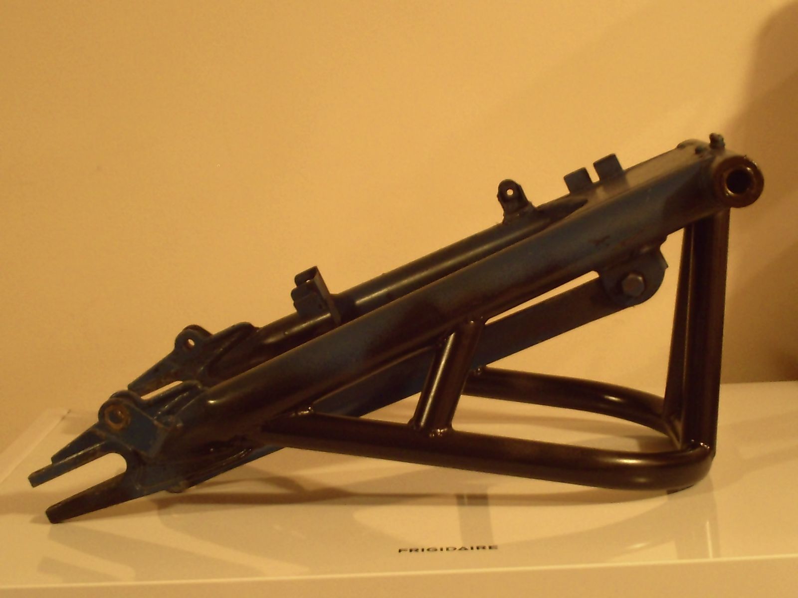

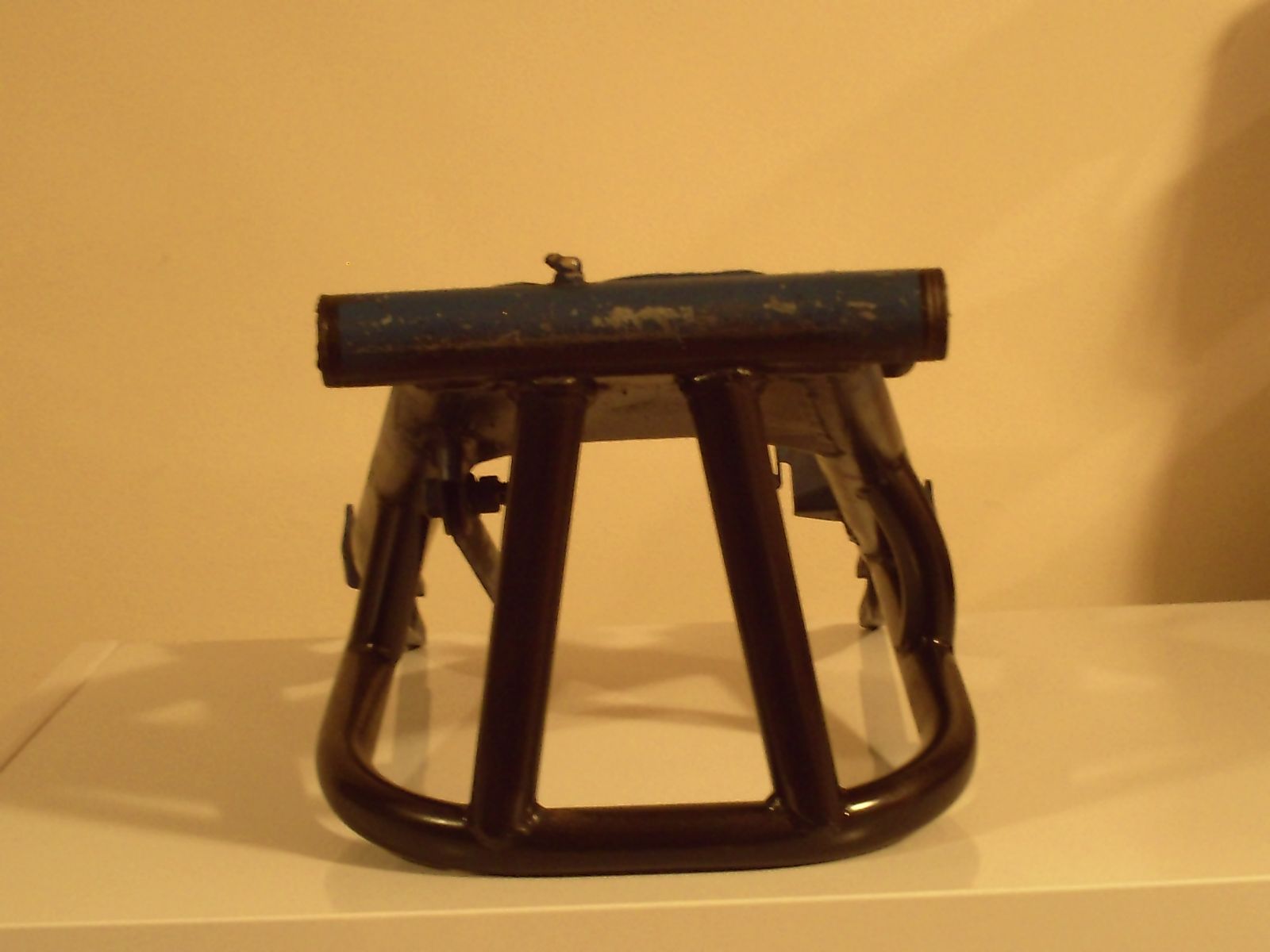

20 Nov 2015 04:30 - 20 Nov 2015 04:44redhawk4 wrote: I don't know about the swing arms, I guess changing one for a stronger aftermarket one would answer that particular question.
a braced stock arm can make a huge difference when you are pushing one.
here are a few i've done.

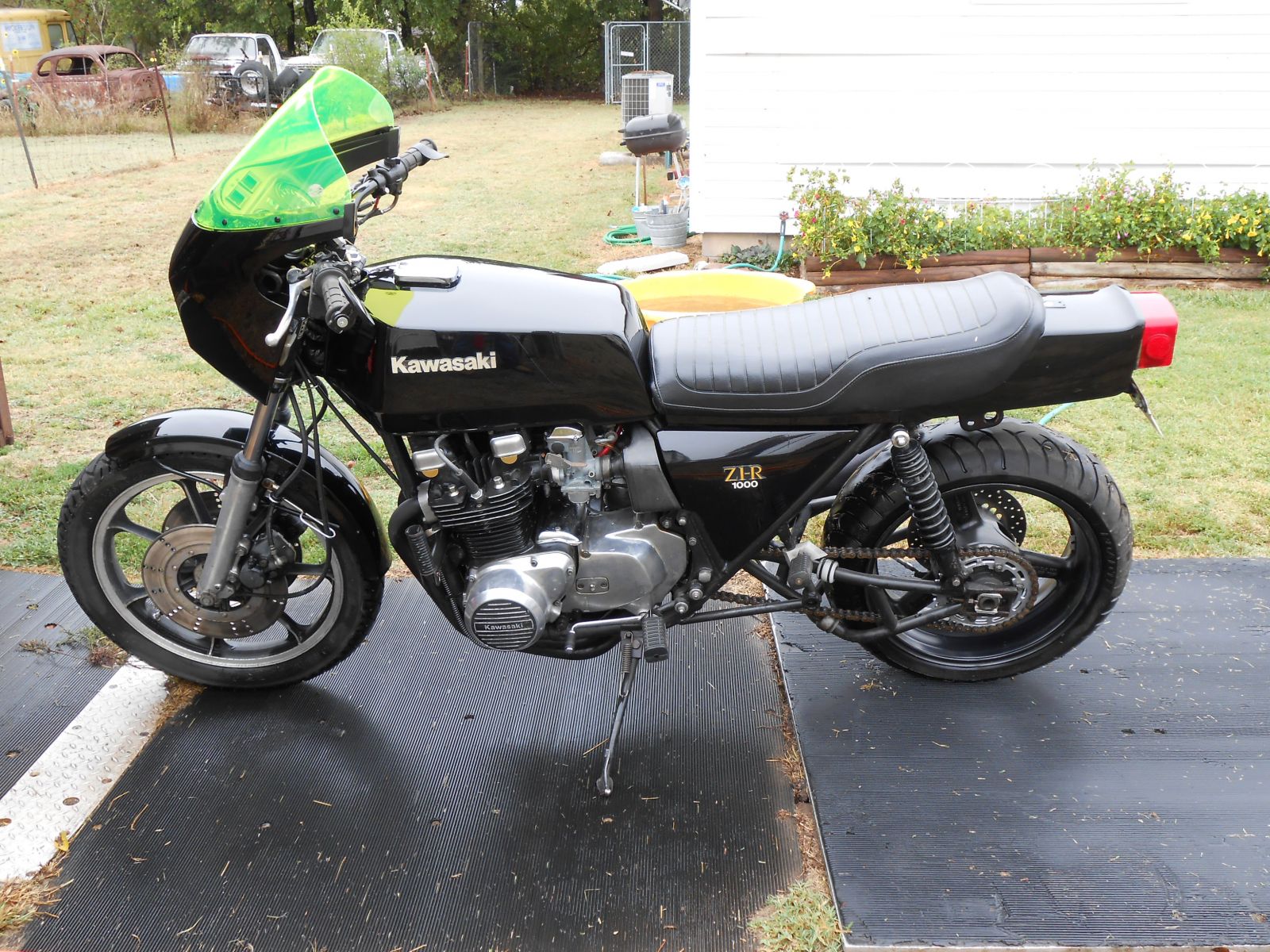

when it was time to address my own 80 z1r's handling i went with a 17x6 inch wide rim with a 190mm wide tire :whistle: .
it's overkill.but rock solid in the corners with no added frame bracing.
i'm sure a good 160 series tire would hold one of these bikes juts fine.
what i'm saying is a good strong arm can go along ways to taming one of these old beasts :evil:

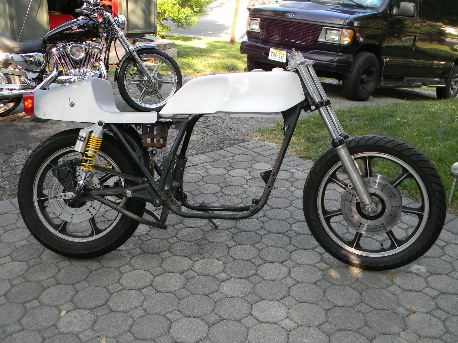

p.s.
looks like some folks think the uki steel arm could use a lil help to.

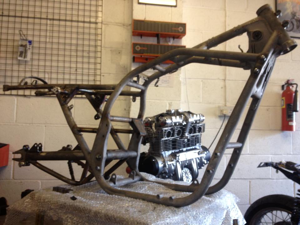

only added a lil bracing to the frame tho.

I really like the look of those braced swing arms too, nice work.
I wonder if the rear suspension units have a problem with not being matched in terms of performance, it seems that, with a less than rigid swing arm, that would have the rear wheel moving round and steering the rear end every time you go over a bump.

20 Nov 2015 05:22redhawk4 wrote: I really like the look of those braced swing arms too, nice work.
I wonder if the rear suspension units have a problem with not being matched in terms of performance, it seems that, with a less than rigid swing arm, would have the rear wheel moving round and steering the rear end every time you go over a bump.
thanks for the kind words.
and,
yes the stock swingarms have the rigidity of a limp noodle.
there are pictures of eddie lawson on the "black beast"with a stock braced swingarm before they started making the underbraced s1 swingarm.
