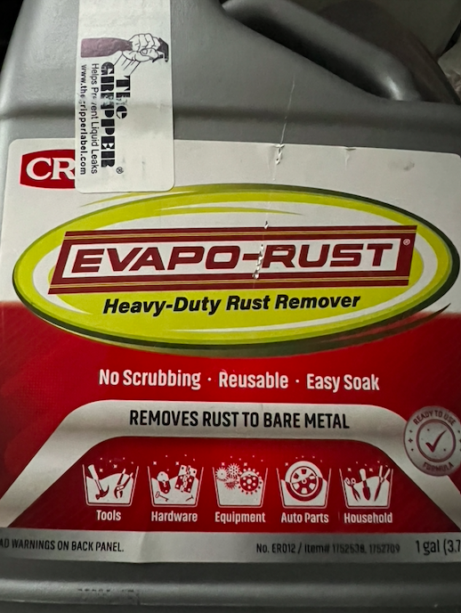

27 Mar 2023 13:49Well, it has arrived. Here we go!!!No special potions needed.
Once cleaned out just fit and fill the tank with fuel asap and keep it topped up.
If the tank is going to sit empty a while then simply pour in some thin oil and rotate the tank until the inside is coated.
Both tried and trusted, simple and effective methods that have served many well since the invention of the motorcycle.
- Mc Tavish
- Posts: 101
- Thanks: 35
Re: Flash Rust post Evaporust KZ Tank: PICS
28 Mar 2023 05:08
Be sure to read the warnings on the back panel.
Motor will "crap out" after use!

28 Mar 2023 08:08Stale.Be sure to read the warnings on the back panel.
