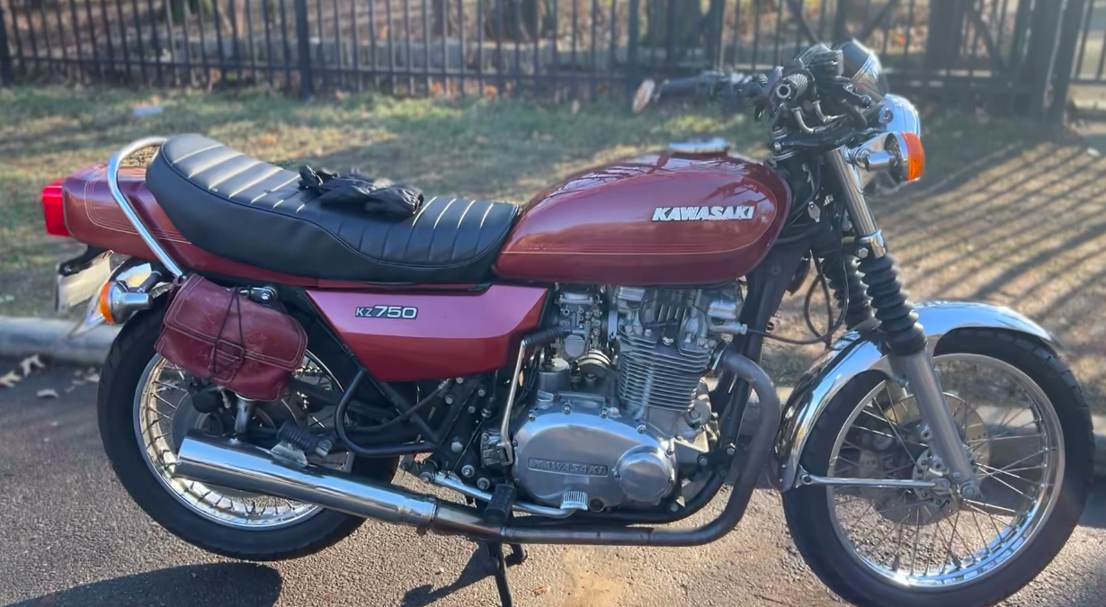

I noticed a little bit of flaky rust in my KZ750 Tank.
Evaporust arrives today via Amazon. I have a water distiller at home (I havent drunk tap water for over 10 years - dont eat red meat either, but I digress..) and plan to wash the tank with it after emptying the Evaporust.

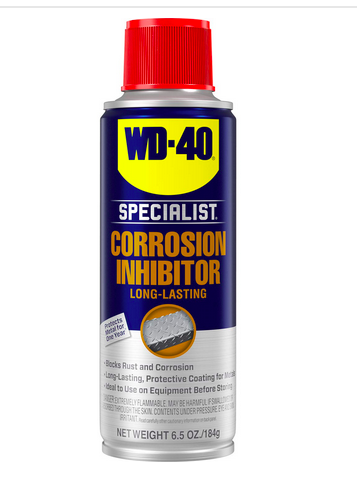

I also bought WD40 corrision inhibitor spray, but wonder if there is a better way to stop the almost instant flash rust that occurs?

Try the search function. This topic has been discussed many times.
BTW, that WD-40 stuff is the wrong stuff. Regular WD-40, in large quantity, would be more appropriate.

25 Mar 2023 14:14 - 25 Mar 2023 14:29I called WD-40 makers and they said, in the case of preventing tank flash rust, this works BETTER than their regular stuff. Im using it.Try the search function. This topic has been discussed many times.

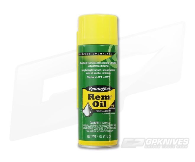

Prior to moving my KZ cross country here in the U.S., I had to drain the fuel tank and was quite concerned with flash rust that might occur with the fluctuating humidity. The only thing I had on hand was a can of Remington "Rem Oil" gun lubricant spray. I fogged the inside of the tank liberally and had no issues at all with flash or surface rust, even today, a yr a half later. Don't get rusty.....
Last edit: 25 Mar 2023 15:04 by urankjj.

25 Mar 2023 16:27Prior to moving my KZ cross country here in the U.S., I had to drain the fuel tank and was quite concerned with flash rust that might occur with the fluctuating humidity. The only thing I had on hand was a can of Remington "Rem Oil" gun lubricant spray. I fogged the inside of the tank liberally and had no issues at all with flash or surface rust, even today, a yr a half later. Don't get rusty.....
Awesome. Thanks for this.

25 Mar 2023 16:36Prior to moving my KZ cross country here in the U.S., I had to drain the fuel tank and was quite concerned with flash rust that might occur with the fluctuating humidity. The only thing I had on hand was a can of Remington "Rem Oil" gun lubricant spray. I fogged the inside of the tank liberally and had no issues at all with flash or surface rust, even today, a yr a half later. Don't get rusty.....
Just did some research and this stuff is highly regarded, so I will be using this. Thanks so much! I learned something new today!
