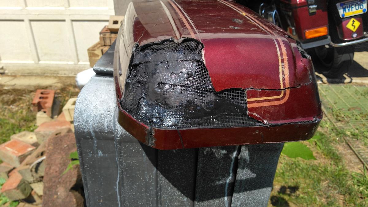

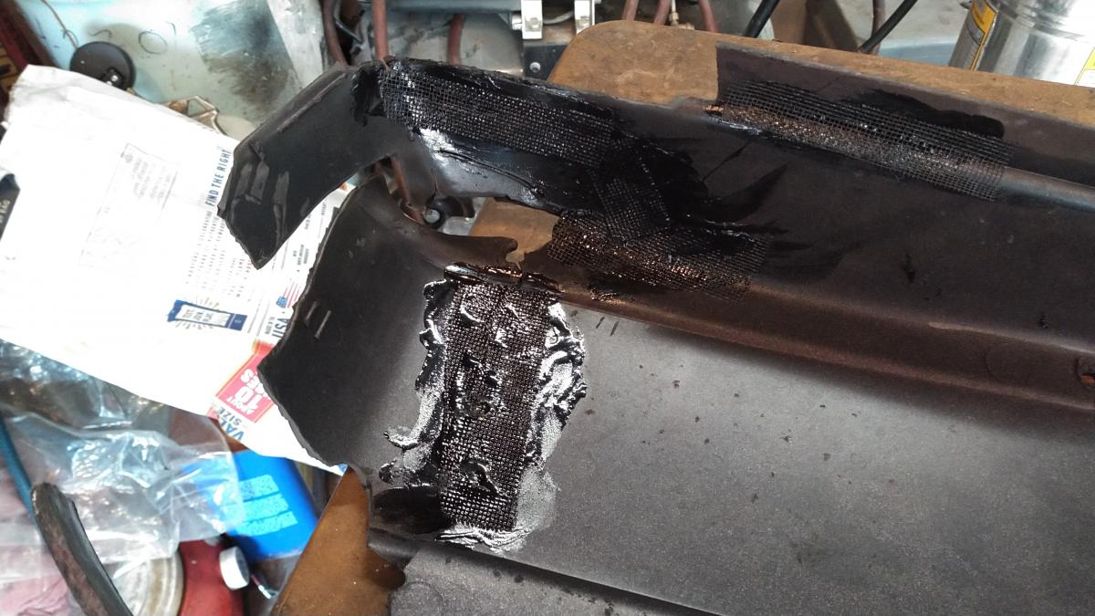

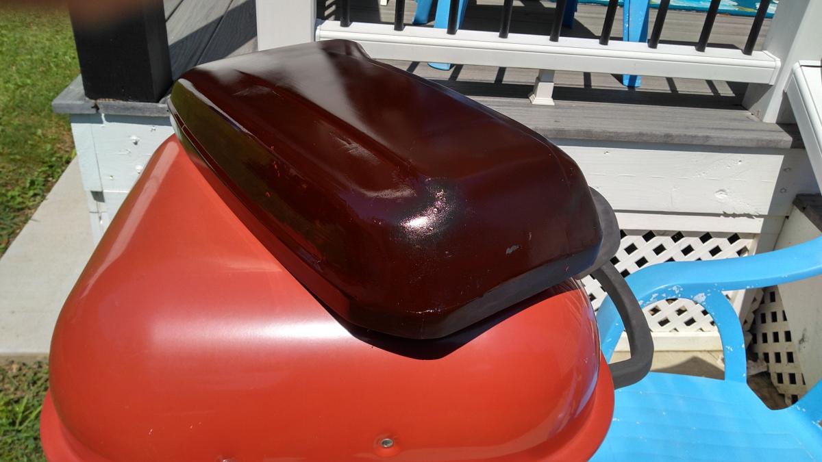

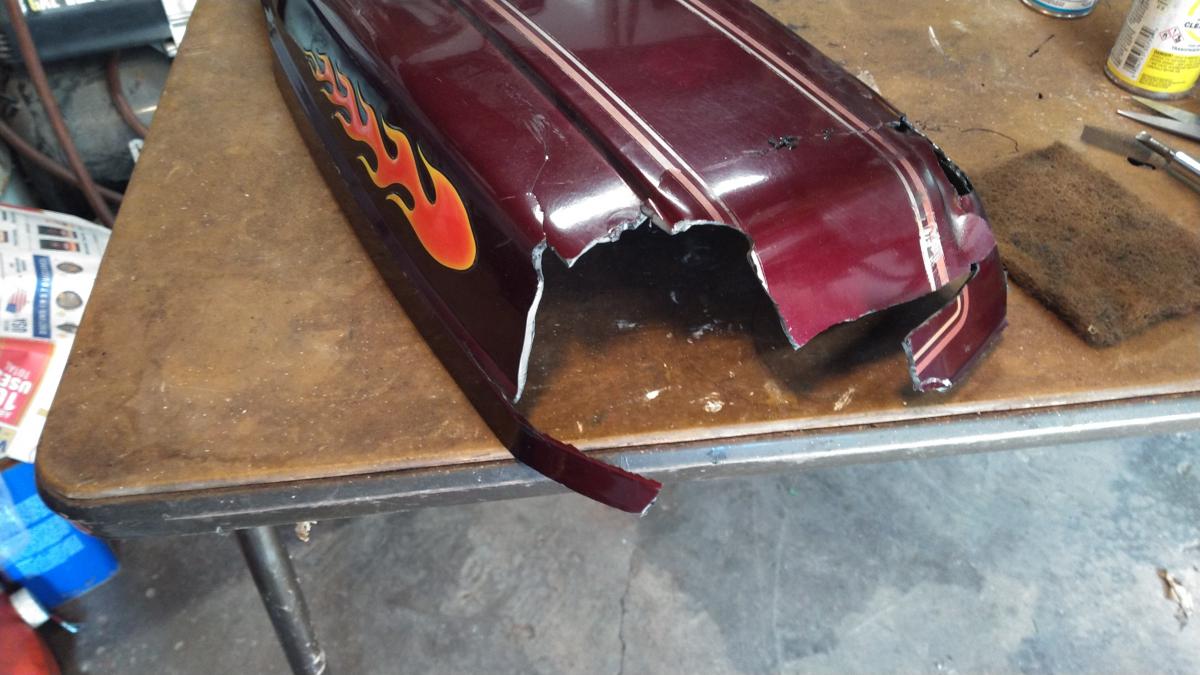

I've done the ABS shavings in Acetone method.....JB Weld for Plastic as well. Both seemed to hold up ok. I lost a lid to my saddlebag on my old Goldwing and it got smashed. I rebuilt it with ABS cement and plastic window screen. I only intended it to be a temporary fix until i found a replacement in the proper color for a reasonable price. That was about 2 or 3 years ago and it's still holding up. I sanded it out better and found a closer color of paint after the last picture
