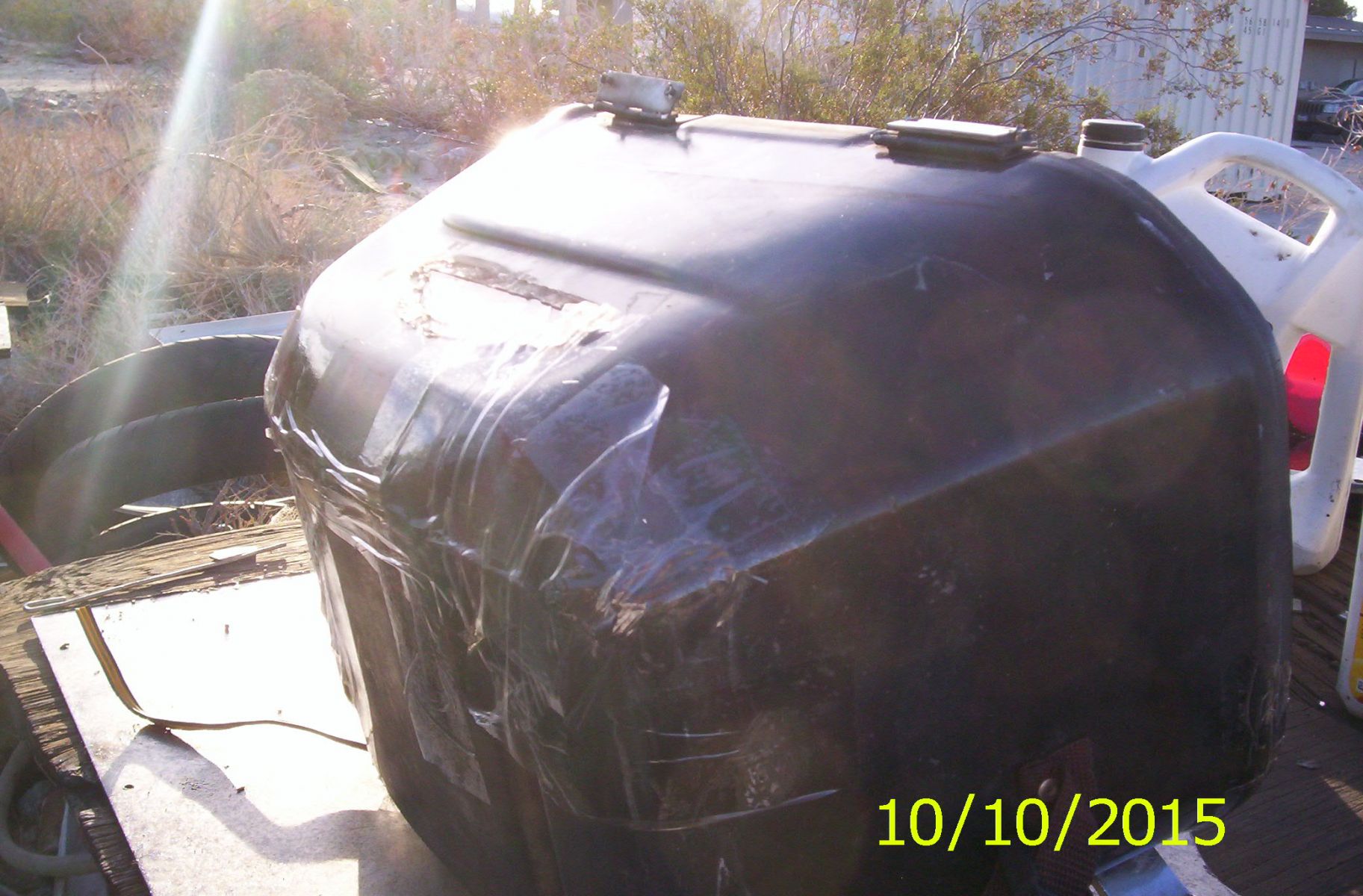

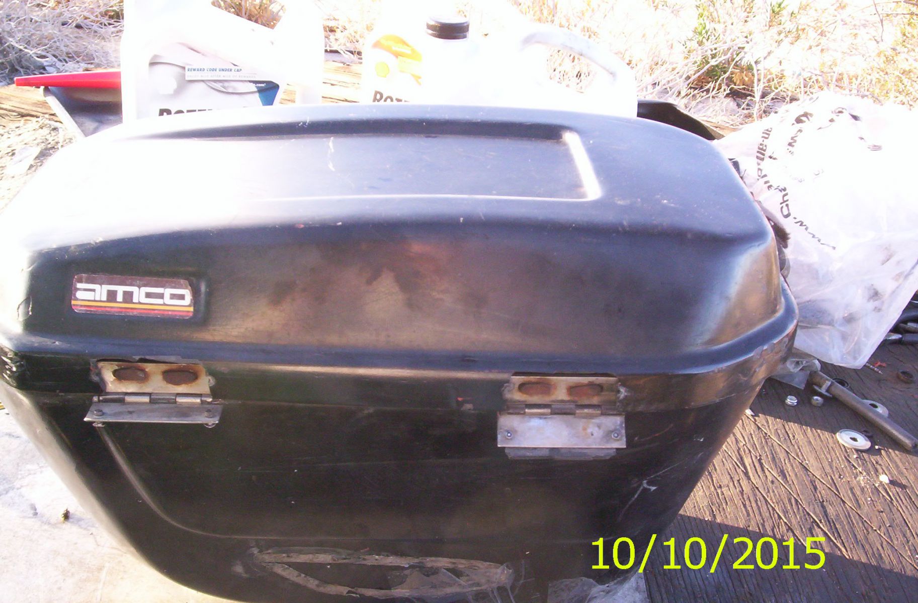

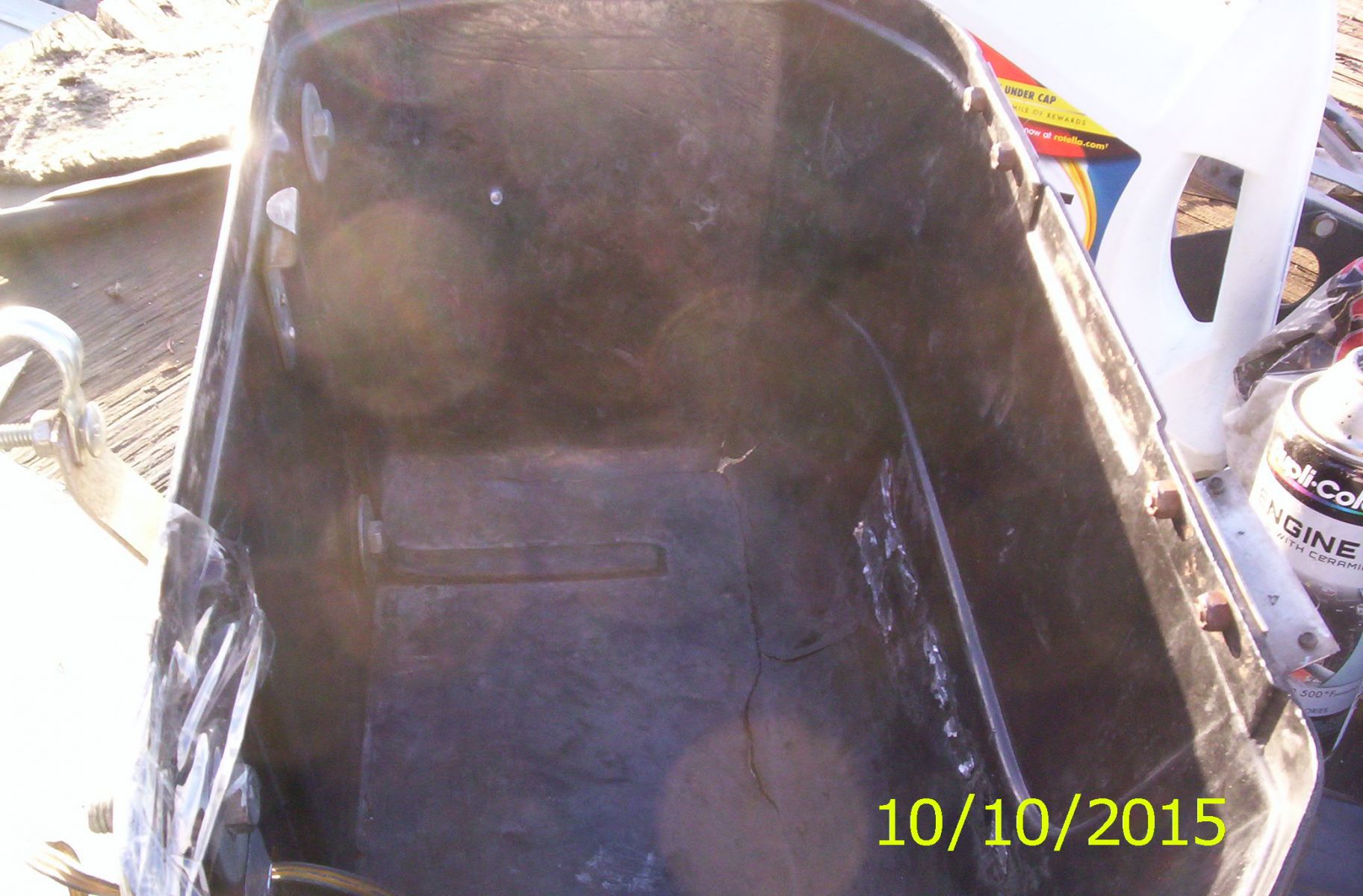

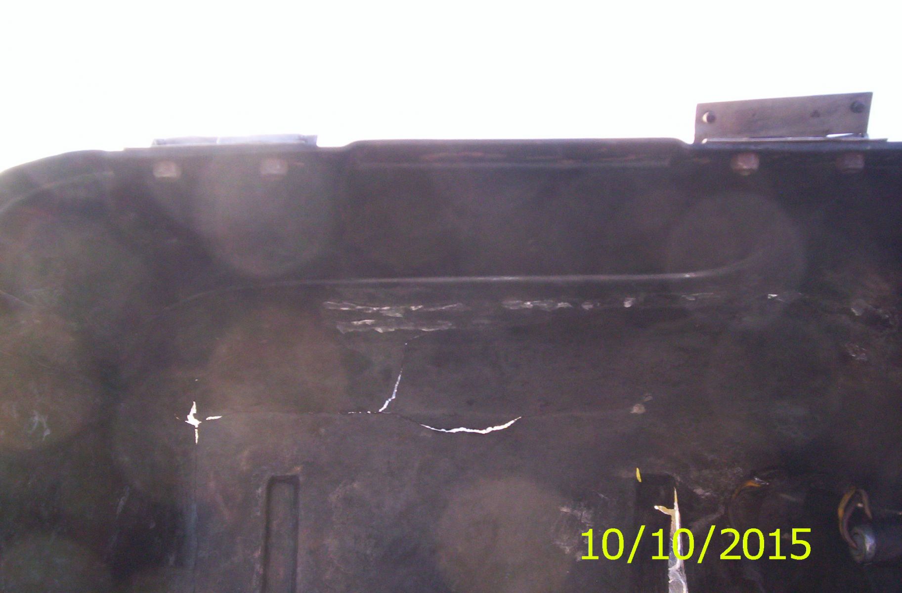

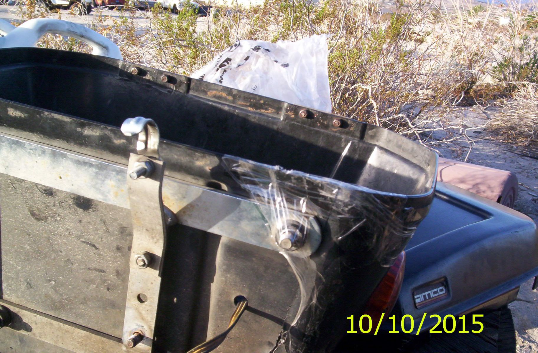

As suggested I'm starting a new thread on my boxes repairs. Last night I was able to use my heat gun to get the cracks to match. There is a gap where the plastic shrank on the bottom. That will be covered with fiber glass. I'm heading to Depot for supplies.
It will take another cleaning and light sanding to rough up so it will stick.

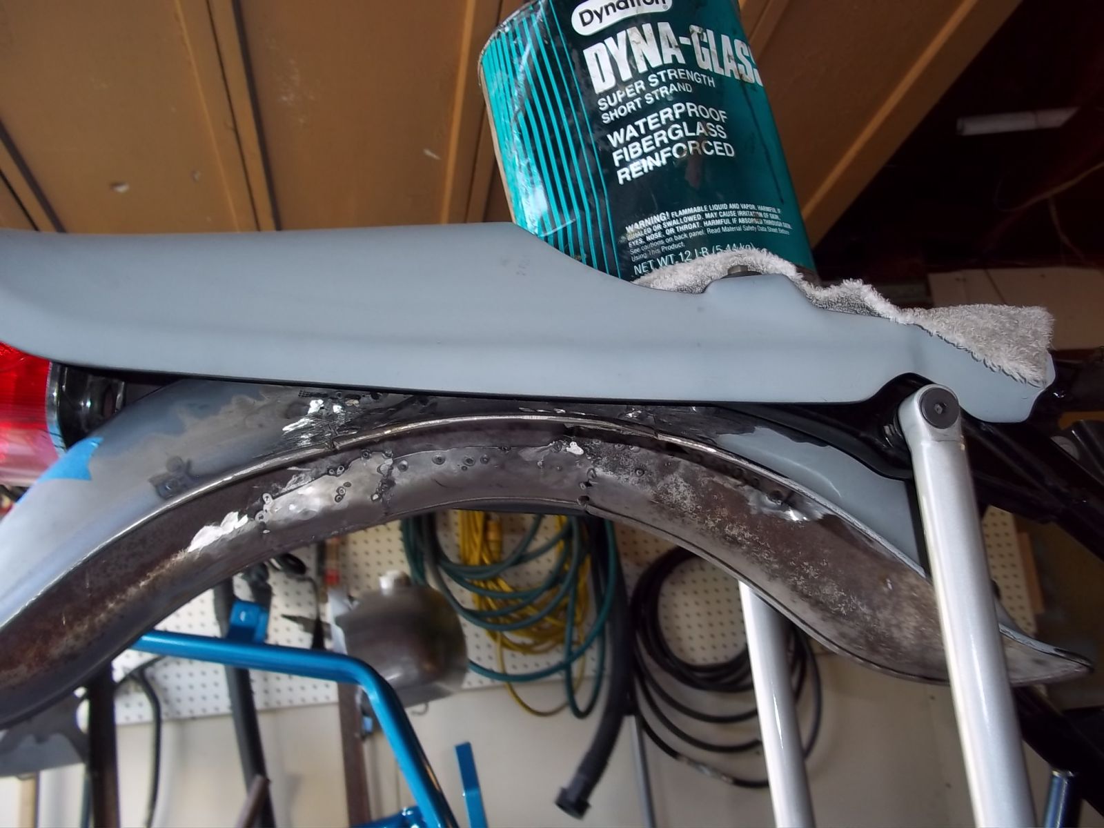

Basic fiberglass resin and fiberglass cloth! They sell kits at all the auto parts stores.

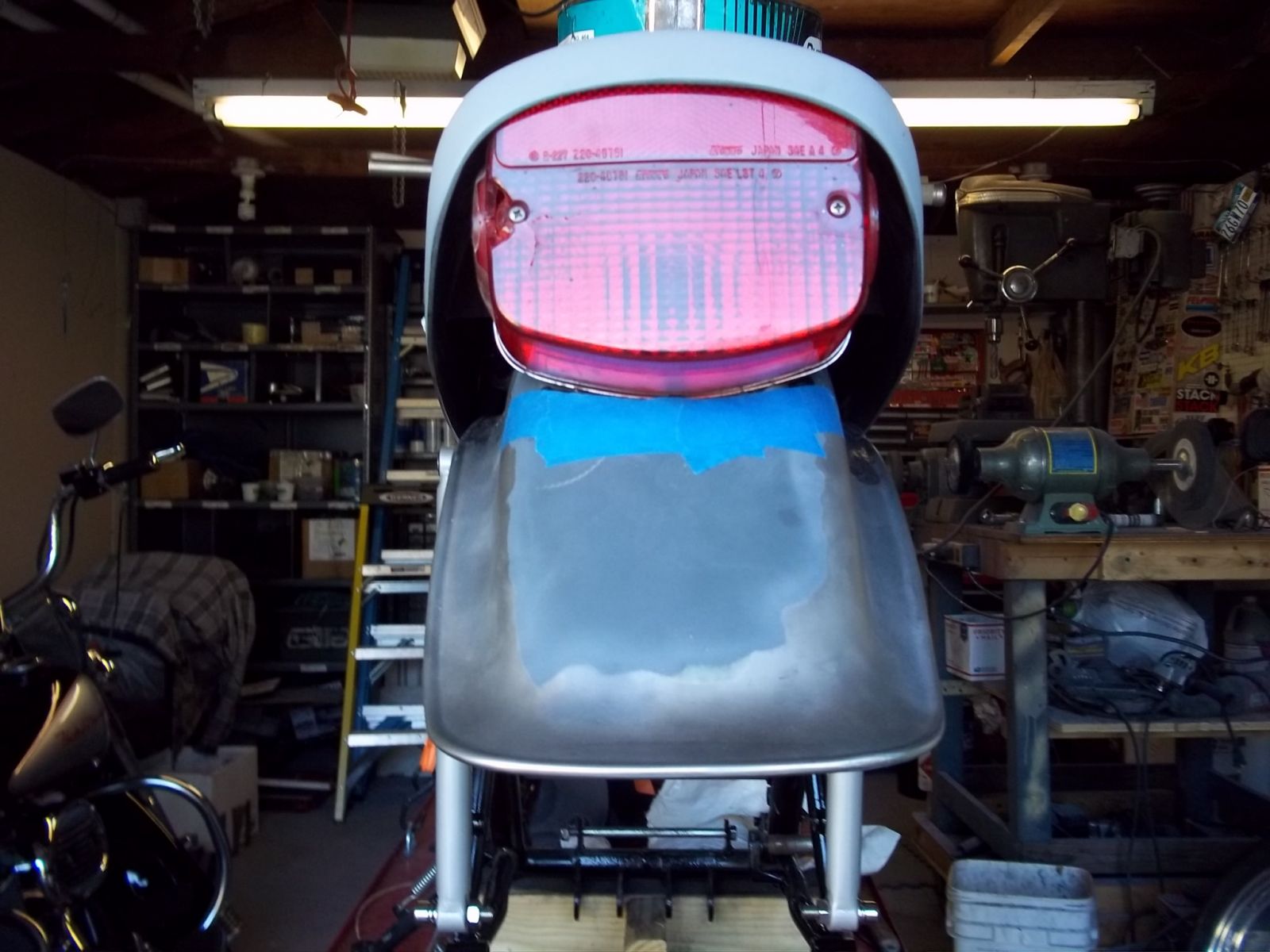

I have this 25 year old gallon of Dyna Hair, fiberglass, reinforced stuff!
Gonna finish my 3 piece fender one of these days!

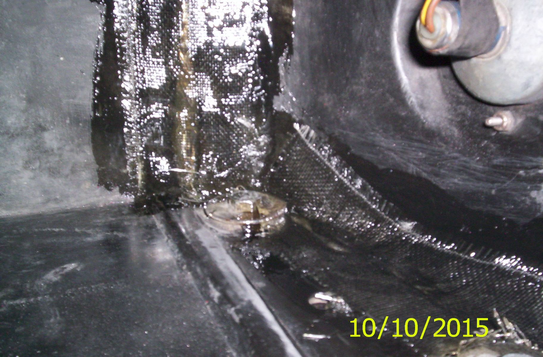

I've used the ABS cement (nasty stuff!), some ABS sheet and a heat gun (to shape the sheets) to repair KZP cases. It works, but it certainly isn't the prettiest. If all you have is cracks and no missing bits, the ABS cement alone can repair it.
One of my cases was coated on the interior with fiberglass by a PO. It is way sturdier than the pure ABS cases and has never cracked, broken, or deformed. I guess that's anecdotal evidence that fiberglass will stick to ABS.
So I'd say fiberglass is the way to go for a good looking and durable repair. It sure is messy to work with though.

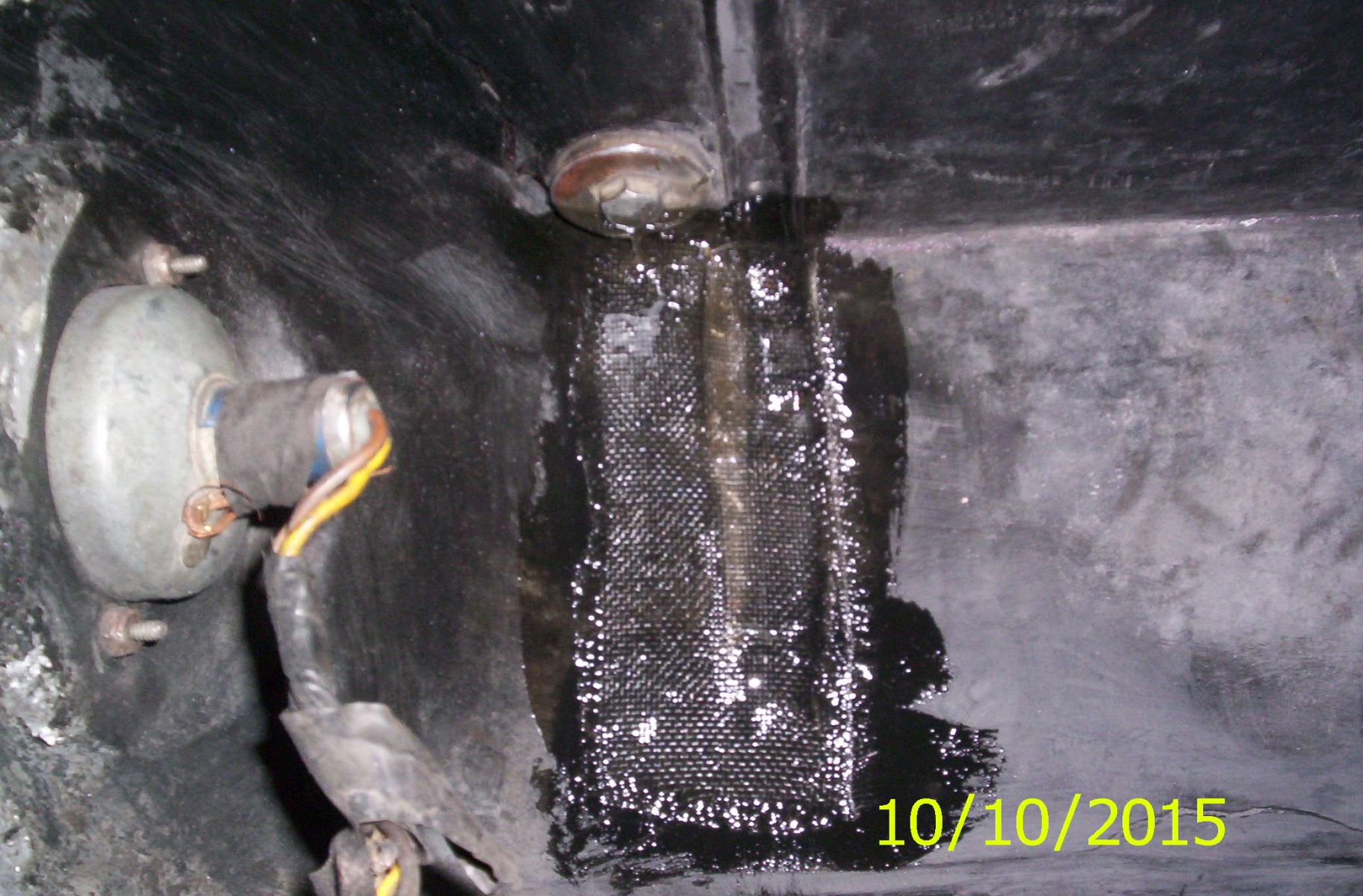

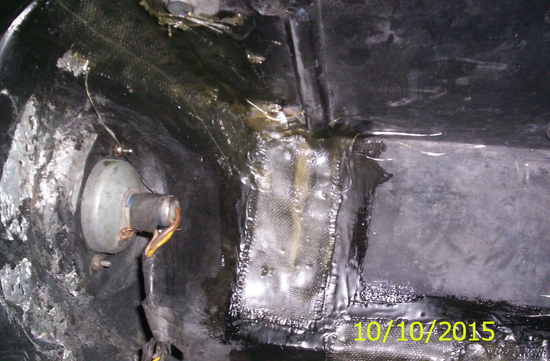

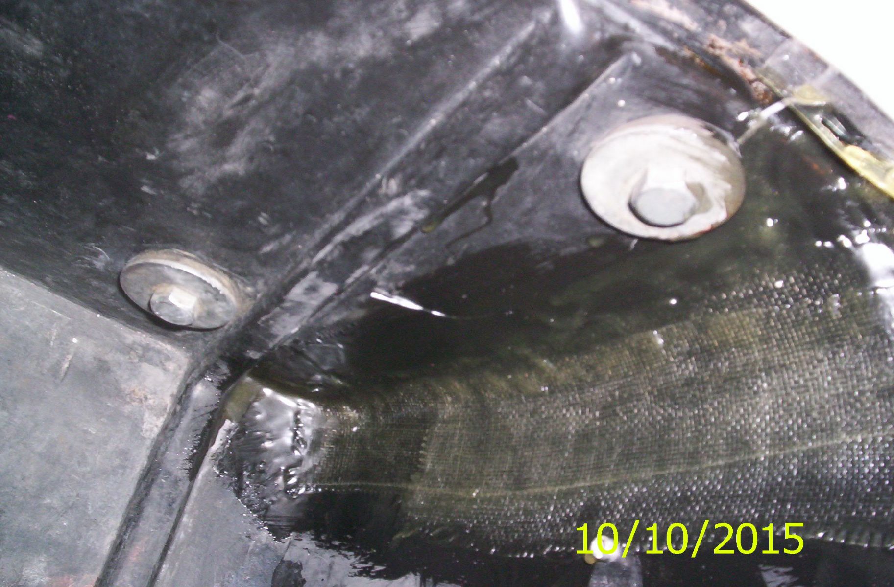

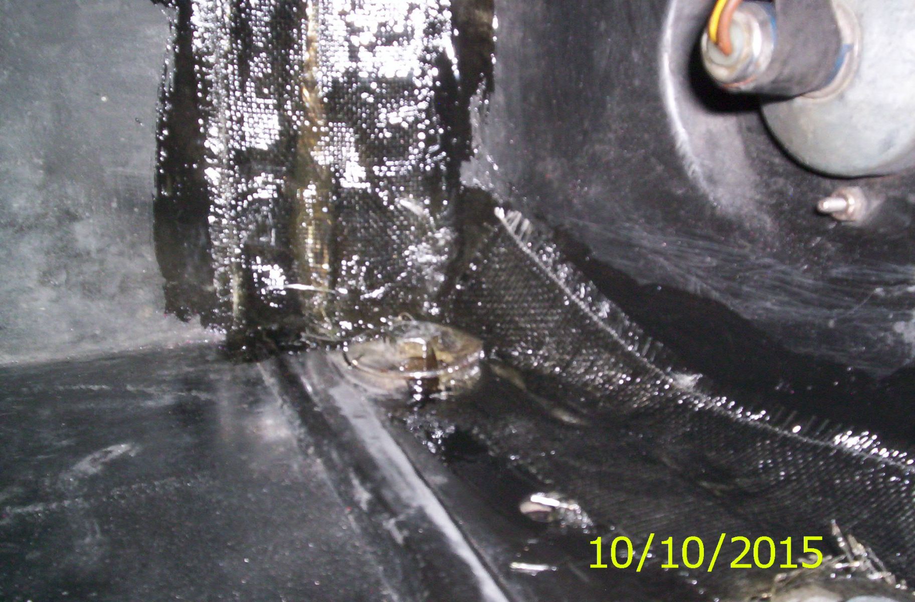

After cleaning with thinner, I roughed up the areas with #100 and #80 paper.
For those that haven't done this before, you fold the paper in half. Fold it back and forth a few times so it will tear easily at the seams.
Fold it again to make 1/4 sheets. They will now fit a sander, sanding block or fold it again to make hand sanding easier.
Clean again.

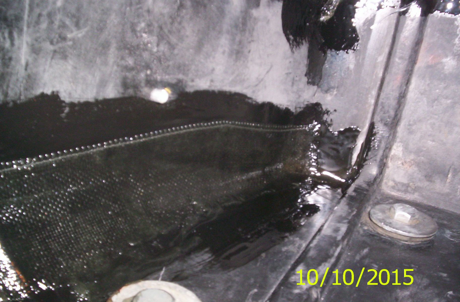

Brushed the thinner and it became like glue. Time to apply the first course of fiber glass.
It'll stick.
Got in the corners.
Now to let it cure and apply another course.

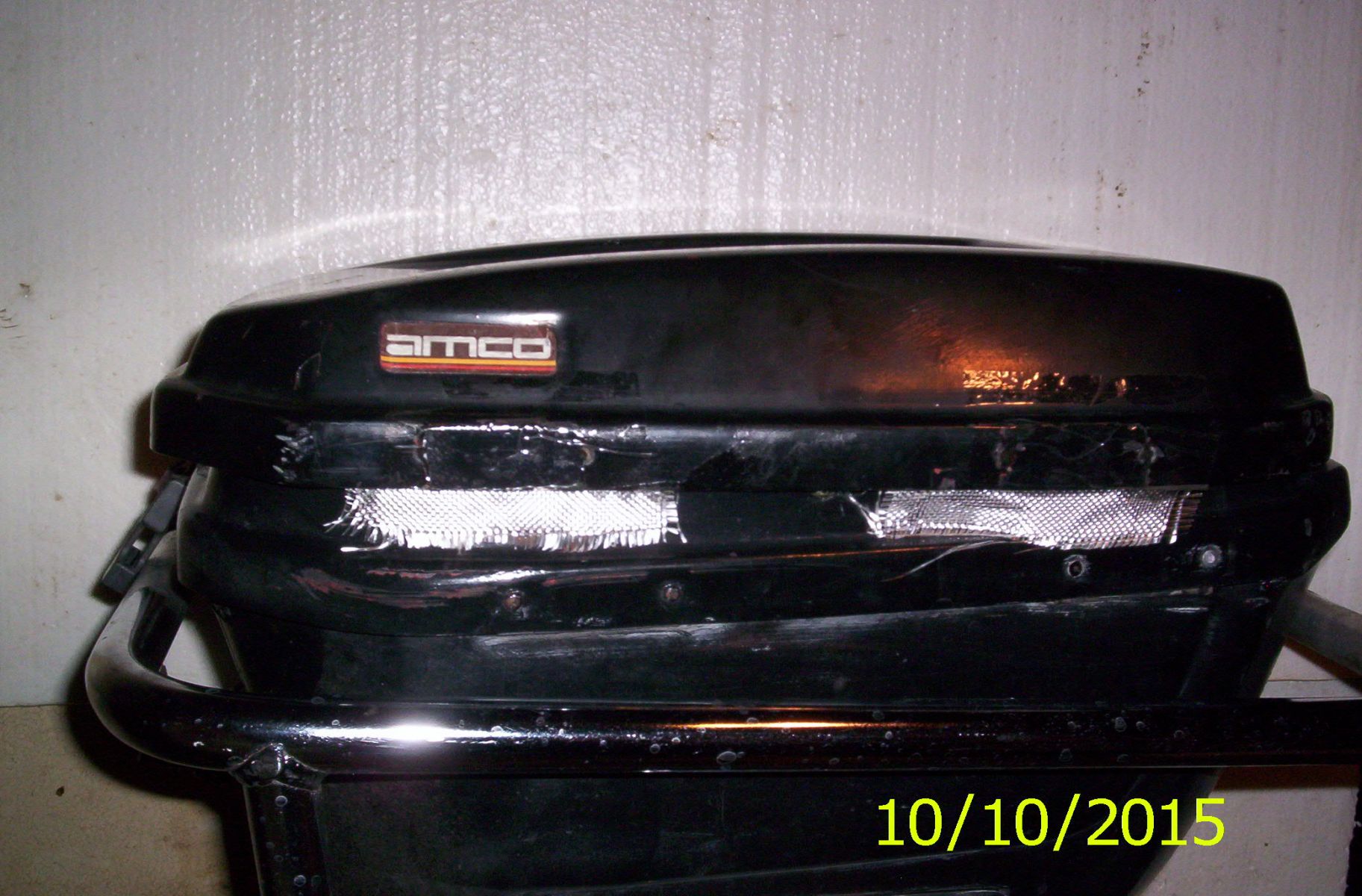

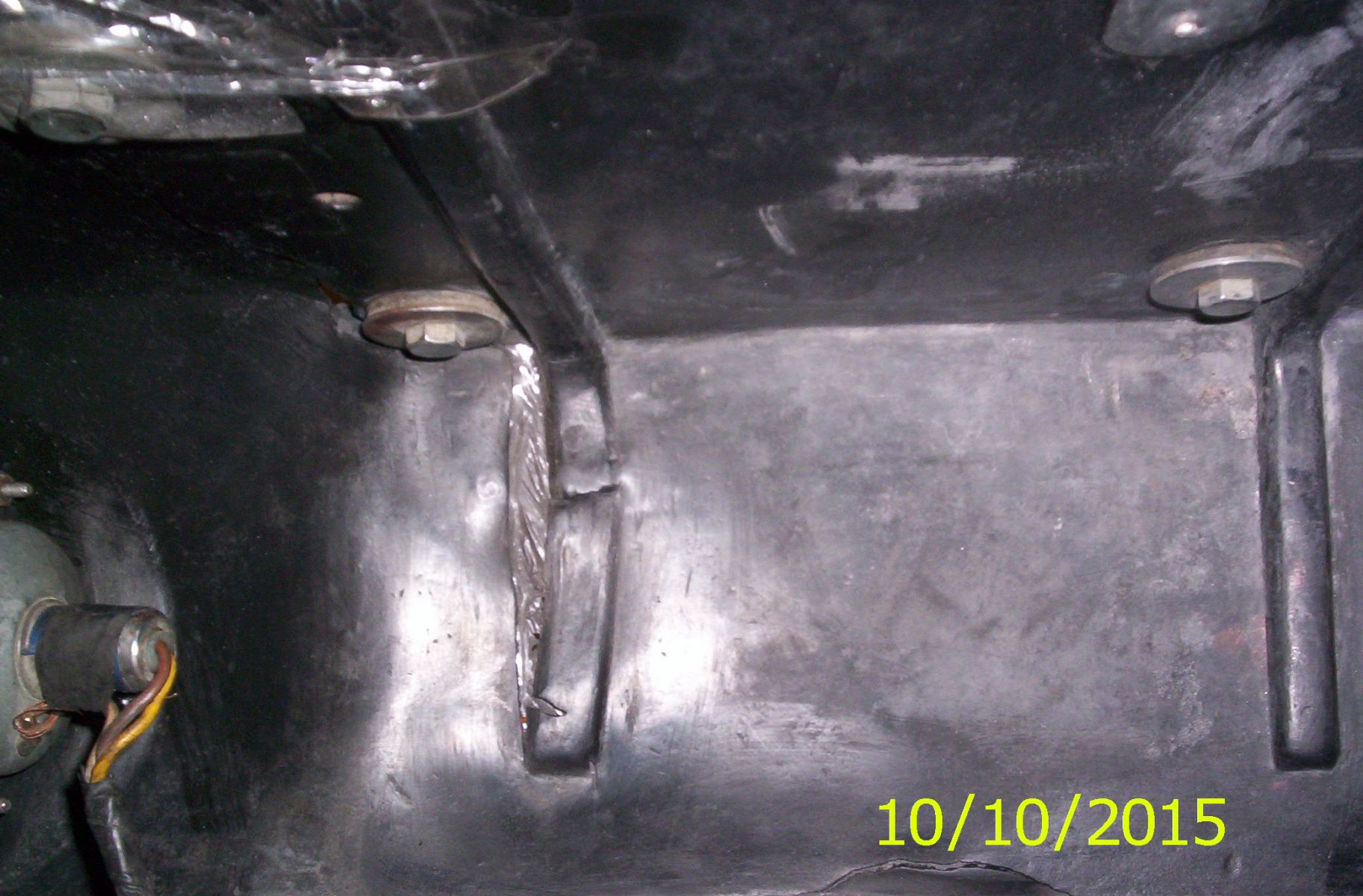

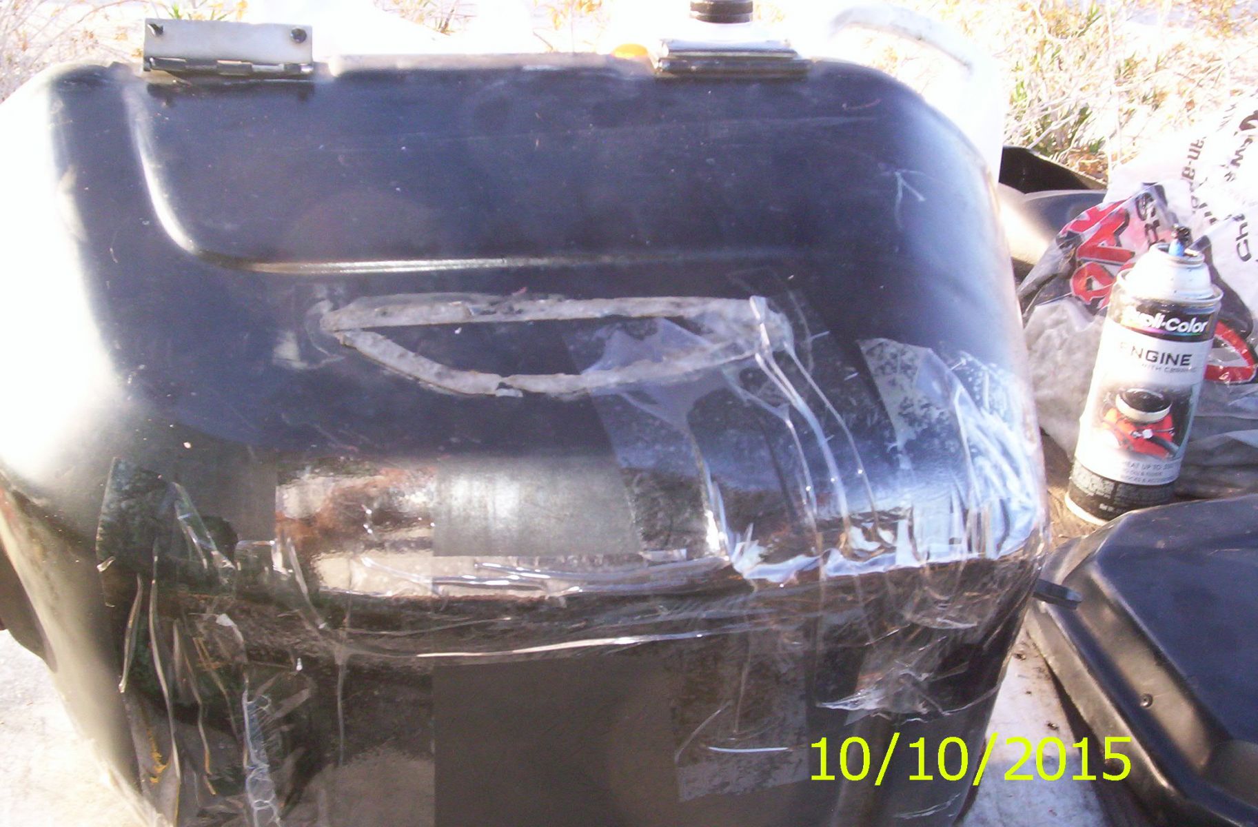

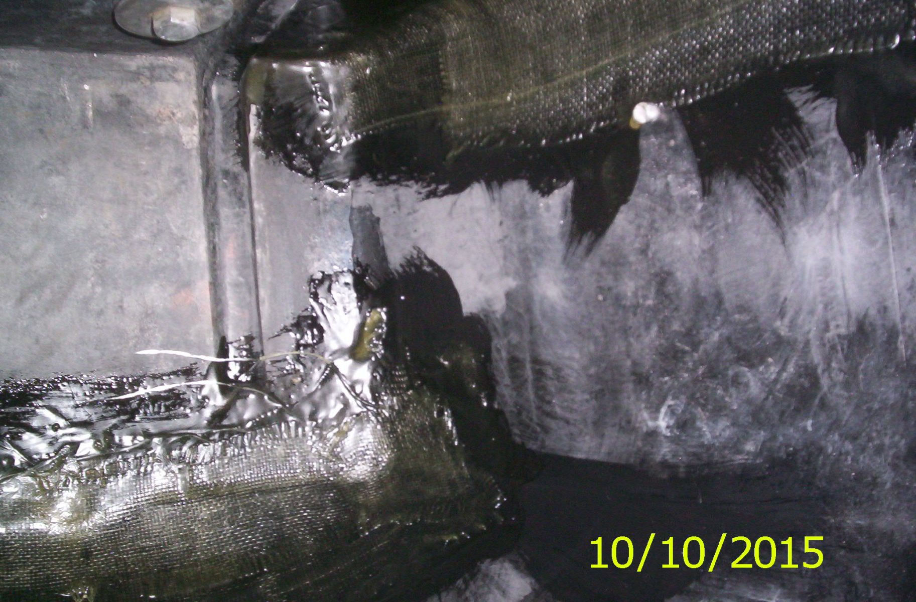

Second course of glass and started on the hinges. Tomorrow I start on the outside. :whistle:

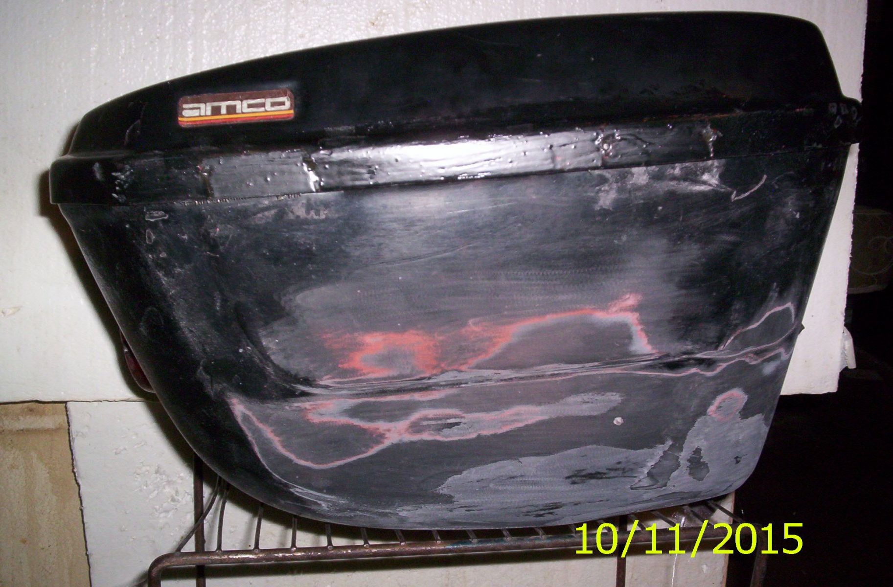

A little light sanding tomorrow and I can paint them. Even fixed some cracks on the other box.
I could spend more time on them and maybe I will later. Have some business to attend to 400 miles away. Need the boxes and a few other things done to do it.
