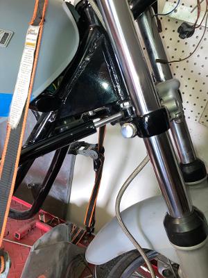

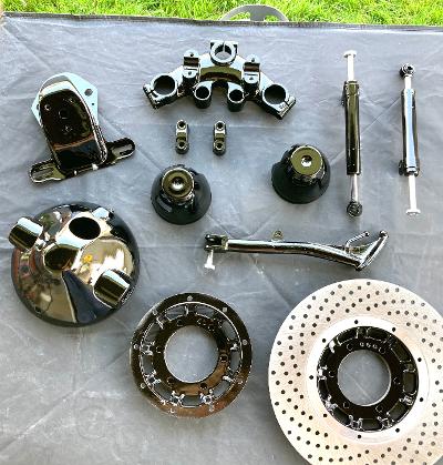

Z1Kzonly. That looks really nice. Does the gloss fade drying?

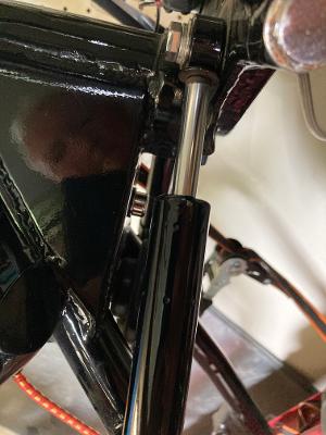

29 Aug 2021 11:31Is the urethane fuel resistant ?
Good quality Dupont chroma-one is fuel resistant.
Not sure of this new cheap stuff?
I should have sprayed an extra test piece. To do a gas test on it. Because I am actually thinking of painting a set of stock 26mm carb bodies black.
But I sprayed this poor bike's frame and black parts, still sitting, 20 years ago with Dupont single stage. That's when I got hooked on the single stage paint.
That's my ugly mug in the reflection on the frame gusset.
Next batch of black I'll do a small part to test gas with.

Hey Matt, Yes! Stuff stays shiny, it can even be wet sanded and buffed just like clear coat.
Can handle it and wax it after 8 hours.
