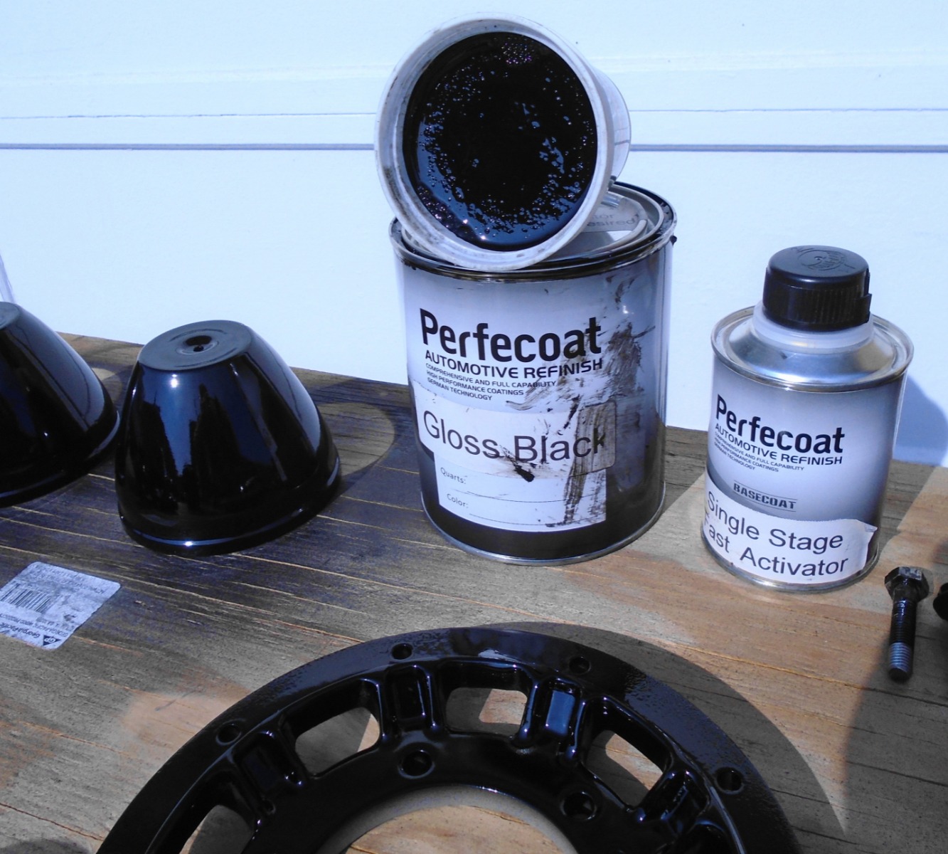

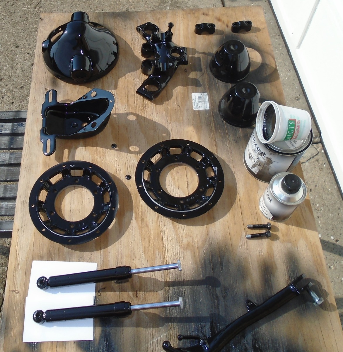

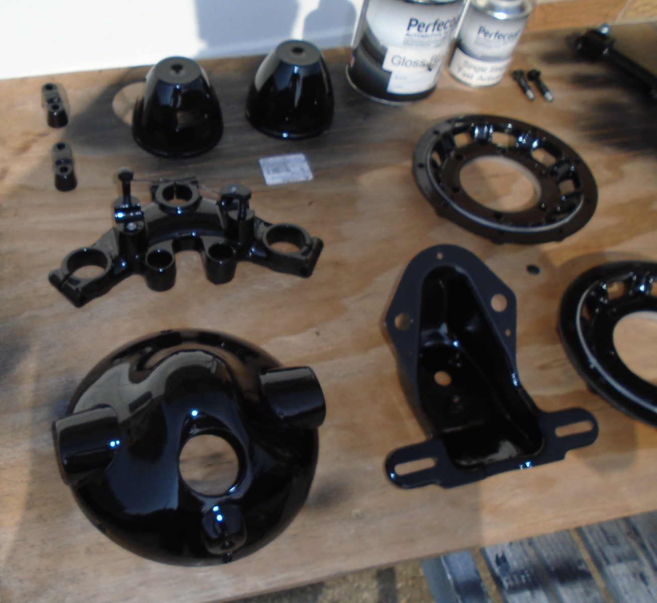

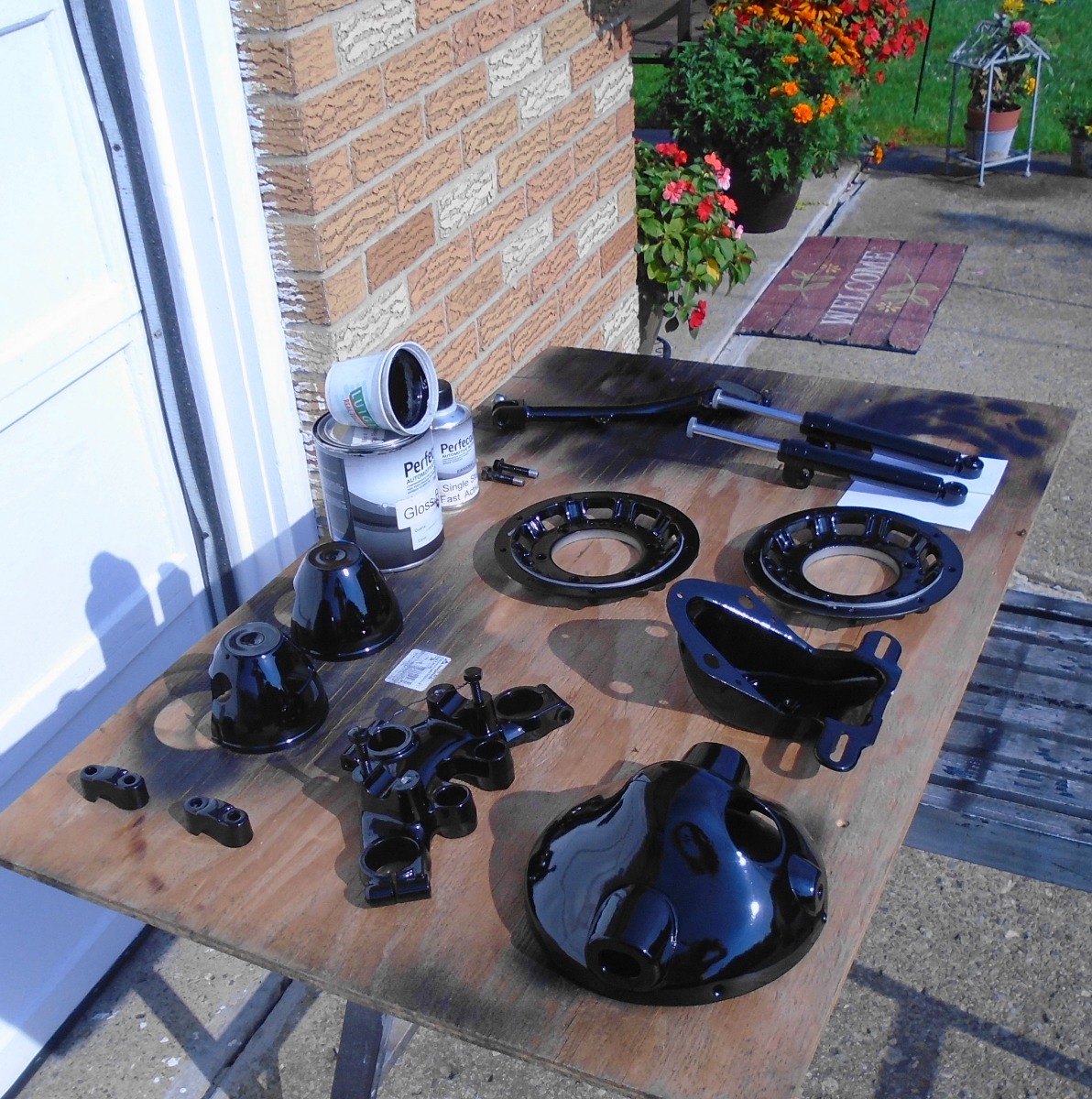

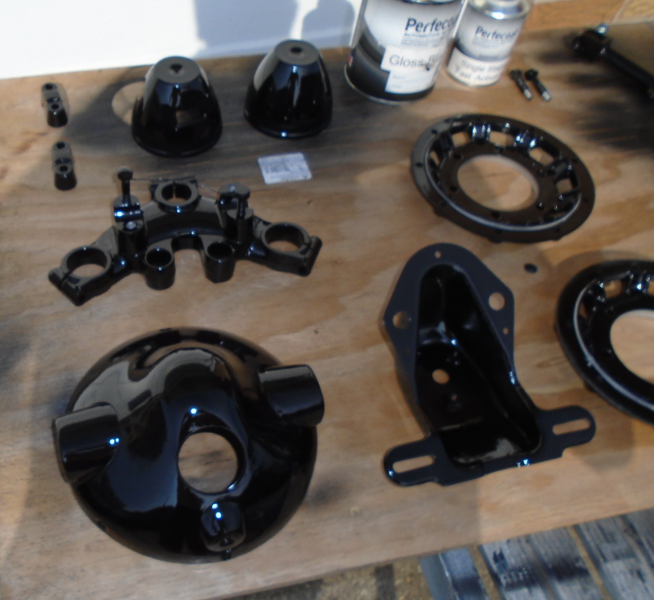

I just sprayed this stuff actually outside. All parts fresh glass beaded and washed. I did not even prime them.
Used this cheap single stage urethane 4:1 mix, out of the gun and done! Bought this paint on ebay, it was $46 bucks to my door. 40 ounce's of sprayable material, you can even thin a little if you want. I did this quick, not going to be keeping these items.
Being single stage with activator, I mixed up enough, not knowing how much I would need. The extra paint is solid today in the white cup. Just like clear urethane sets up.
That said you can wet sand and buff just like clear coat.
Just takes practice and playing with the adjustments on the spray gun.
