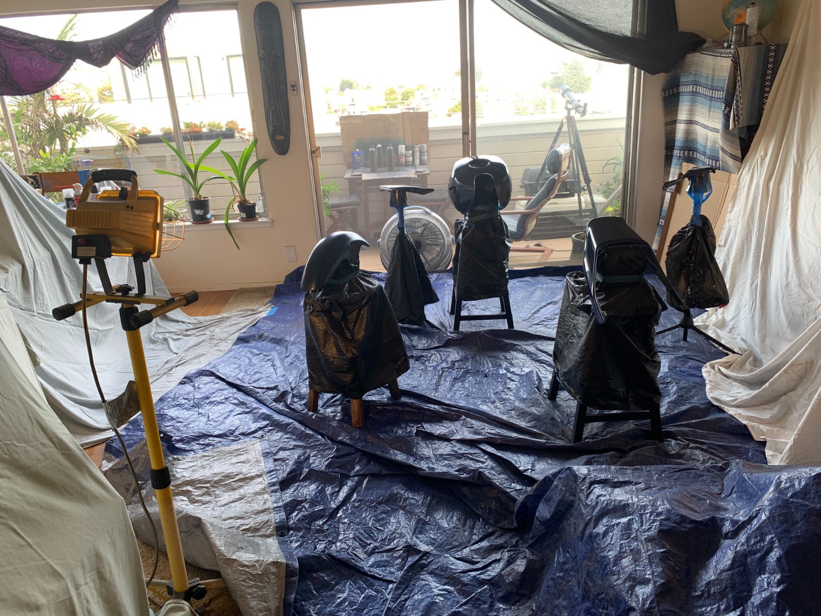

I ended up using aerosols - a 2K House of Kolor black primer, Color Match color, and Spraymax 2K gloss clearcoat. Actually turned out pretty well. I do need to buff out a bit of orange peel when the clear cures. This is what painting in a small apartment in the city looks like :ohmy:

hahaha I bet your neighbors LOVE you. The 2k clears have isocyanates which are incredibly toxic, they have no odor and cannot reliably filtered with a respirator, closed air source is strongly recommended when painting indoors.
