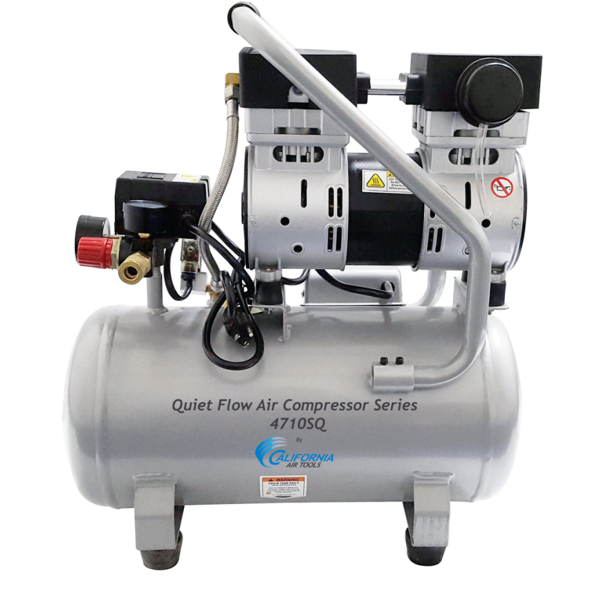

I don't think there is enough airflow to drive the gun for anything other than small contrast color work. At least the pancake I used to have. When you go to clear the tank you need enough air to fog the tank all over and keep the paint wet or it's orange peel city. If you don't have an air compressor now would be a good time to invest. I have a large compressor which I normally use but I also have a California Air Tools 1.0 HP jobby that I've used in a pinch when painting a bicycle frame. These compressors are awesome; so quiet, and seals up well too. After charging the pressure doesn't drop for more than a week.

OK, I think I have a plan. I'll get a low volume paint gun (3-3.5 SCFM) and the California Air Tools 1.0HP compressor. That compressor is small and quiet enough that it won't drive my neighbors crazy. That set up should be fine for base and color coats, since it's not as important that those all go on at once. I can use a Spraymax aerosol 2K clear for the top coat which will avoid the issue Nessim brought up, where I need to keep the clear wet to ensure a smooth finish. Boom!

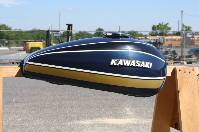

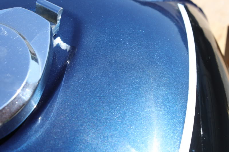

Spraymax already has the aerosol, 2 cans will do a bike. I used 1 but would have liked another 1/2 can for mine. I used the Preval kit to paint the trunk and door jambs on a Cuda I restored. The tank below is Color Match aerosol and Spraymax. The final finish depends on how good you knock down any peel and polish it.
