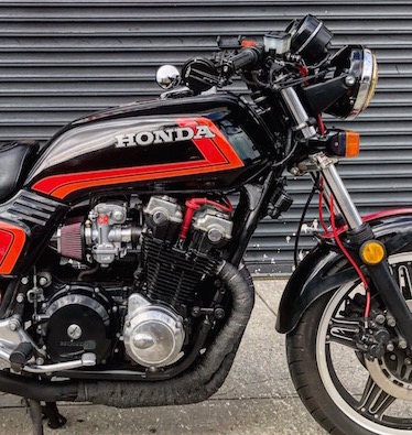

VHT *FLAME PROOF* HIGH TEMP paint, not just High Temp. I rattle canned my Honda (im thinking of doing my Kawa) and it came out great. Use Steel Wool grade 00 or Scotchbrite pad and clean the fins before painting.
My Honda rattle canned engine:

My 900F gets hot as hell. No issues with the VHT at all. Never had fuel spill on my block by the fins...maybe Im an odd duck, but the Flame Proof VHT is holding up rather well.
