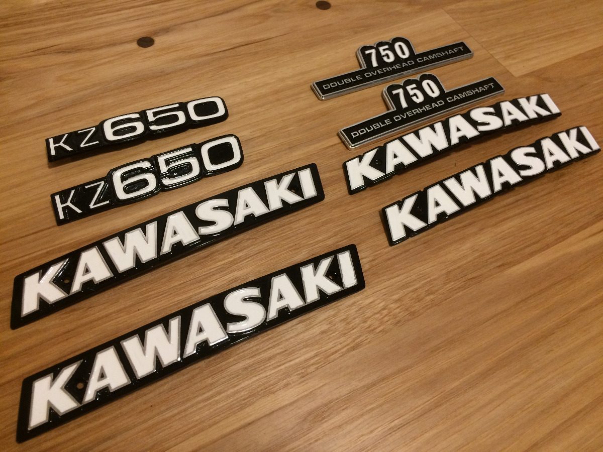

Re: Detailing emblems
24 May 2018 16:39 - 24 May 2018 16:45
I used duplicolor engine spray paint for the black & testors model kit paint in the little jars for the color. My method is to use grease to mask, applying it with my finger. just touch the grease, then touch something clean to remove the excess, then lightly pat the areas to be masked. It's kind of tedious, but the emblems are so small it doesn't take long. They came out pretty good & look better than the pics which have a lot of light reflecting off of them. I think I used a low gloss black.

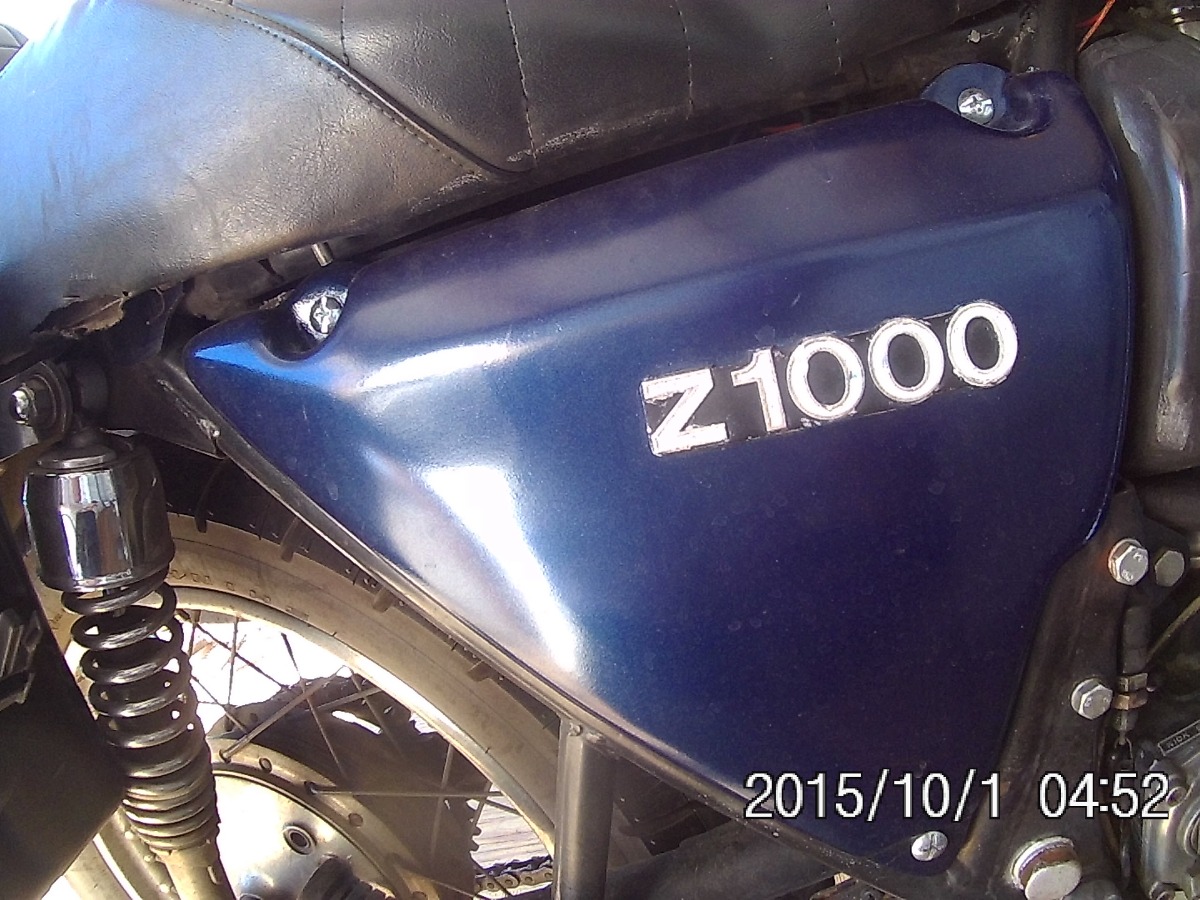

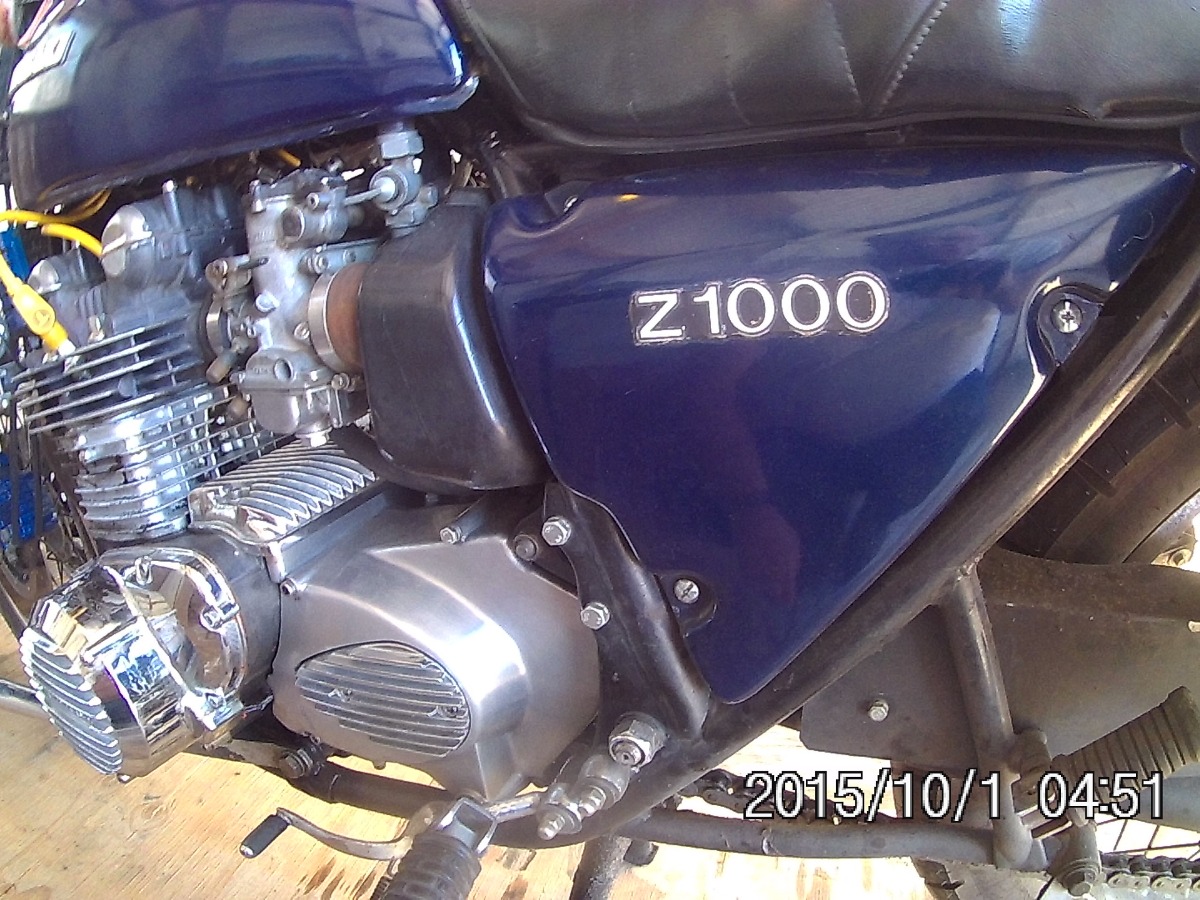

25 May 2018 17:36 - 25 May 2018 18:179er rider wrote: I just received 2 kz 1000 side cover emblems for my78 made of PLASTIC for 40 bucks what kind of sht is this without telling you there sht plastic for 40 bucks?? complements of Z1 parts
Call them and get a return label. 100% money back guarantee. I got one from Z1E in 13 and it was gold. I didn't want to go through the hassle so I cut the K off, sanded it with #600. It is chrome underneath. I repainted the black but didn't clean the chrome borders. Oh well, GOOD TO GO. :lol:
