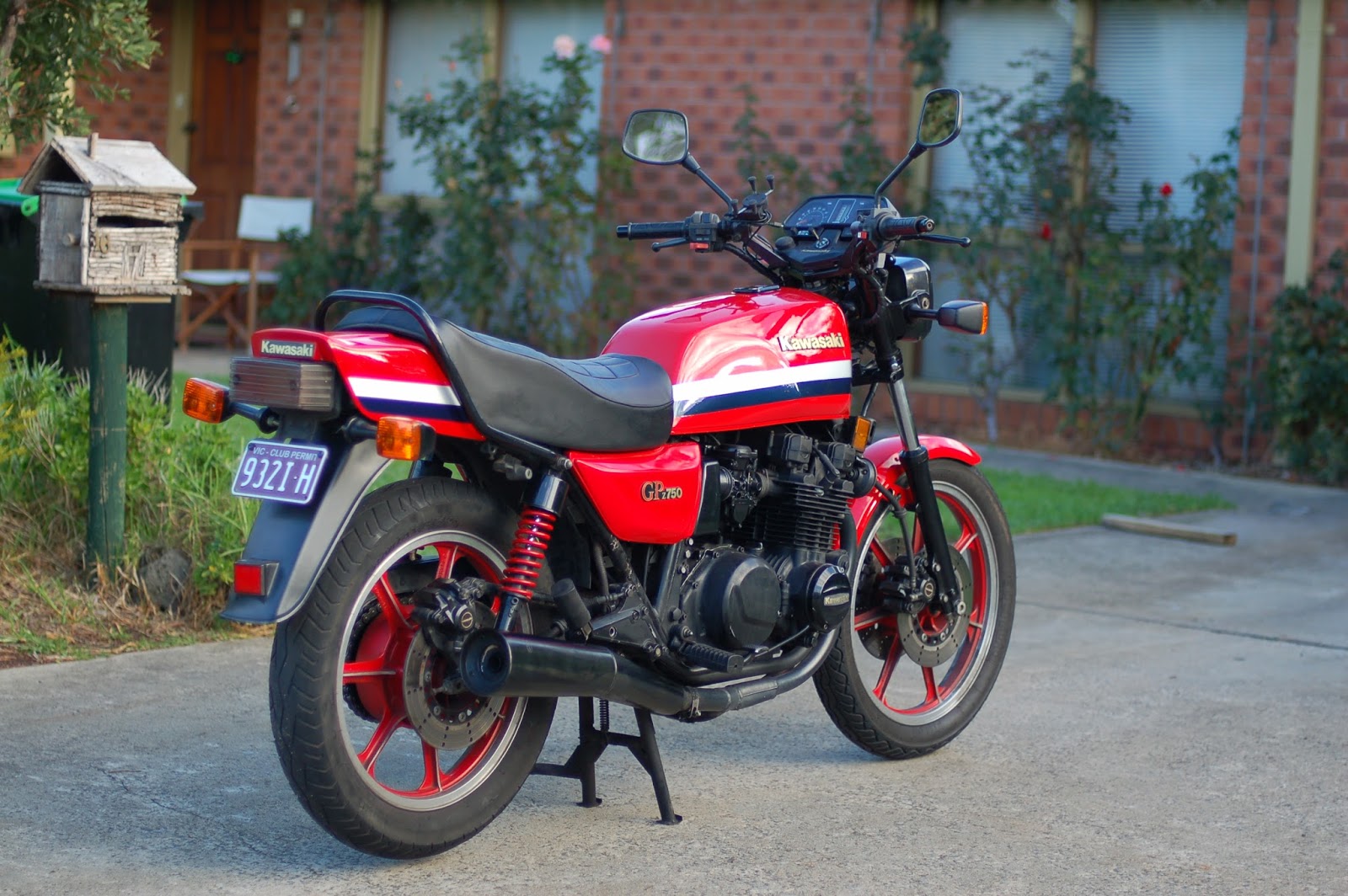

... and for the Final product (for now!) ... I really think it's 'good enough' and don't want to waste what little sunny day left this season to muck around with buffing or painting
THANK YOU ALL for your help and TIPS!!

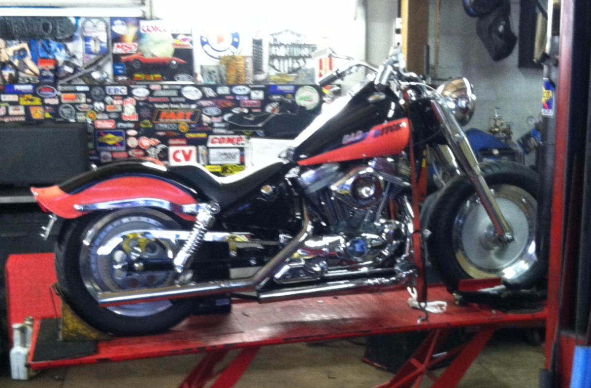

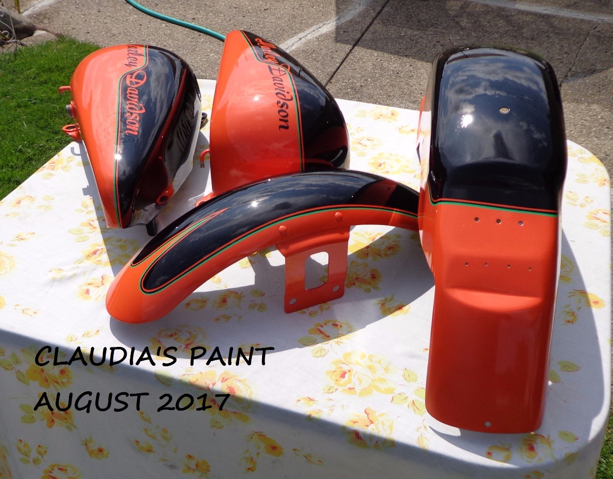

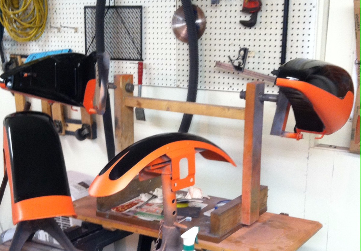

Just finished another HD paint job. The Bad Bitch re-done 20 yrs. later. I did the 1st paint in 1997.
Old Friend, She's a nurse now at Roswell Park Cancer Institute, 9 yrs. She wanted the tanks toned done from the bitch.
But we stuck it in on the back fender. 1 more Honda 70's chopper to paint! Black with (White lace & dollies) LOL! Then I am finally going to paint my Z-rod hot rod. after 10 years! WTF?
couple of pics:
couple of pics:
